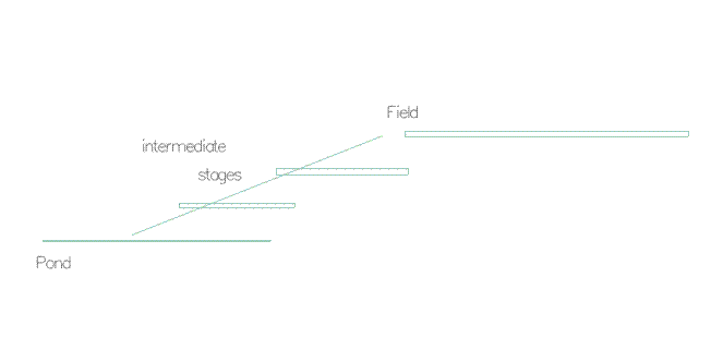

thats getting a bit complicated..
Personally i dont think that a piston pump will work with water.dont you need some sort of a rotating impeller to pump water?
also , you said your mill will be located 300' horizontally and 20' vertically from the pond ?
i would suggest, not pumping 20' all at once but pumping the water a little at a time .
http://www.otherpower.com/images/scimages/2965/water.GIF
this will make you pumping needs considerably less.
