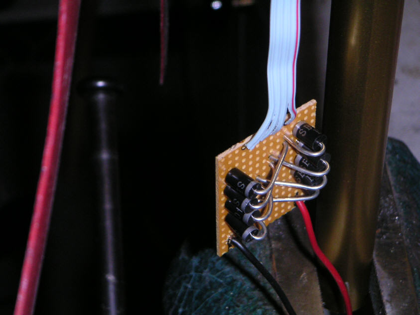

Tommy,
I've done the same thing with plastic box fan blades, 20" type. I wonder about your rectification. You should have 3 phases or more in the stepper. Either the motor needs an array of diodes or seperate bridges for each phase. I put a 3300uF 25V capacitor on the dc side to smooth things out. A simple method to isolate phases is to short 2 wires together and note the cogging. When the motor becomes harder to turn that's one phase. The steppers I use come from old 5 1/4" floppy drives, the head position motor usually having 5 wires coming out. I see about 500 milli amp in a good stiff wind. I've yet to see one of these light a tail light bulb, 1147 type. However when 6 or 8 of these get going and the output is combined I have seen almost 4 amps and that will make the bulb shine pretty good.

« Reply #7 on: June 29, 2004, 11:11:46 PM »
Hi !
This is a picture of my diodebridge
That capacitor is the next thing to put on it, the first thing is to change the stepper to a bigger one, and bigger blades.

« Reply #8 on: June 30, 2004, 03:04:59 AM »
Yep bigger is better. Half wave rectification is just as good for batery charging most
car battery chargers are configured this way .When your output is low  the voltage drop from a bridge can tip the scales . A batery will do the job of a cap nicely .
You can pulse charge with a large capacitor bank. In the mean time I'll bet your wanting to run some elctronics and I can see you gravitating to a UPS . The gel cells in a ups charge well with  a half wave rectifier .
