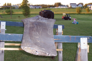

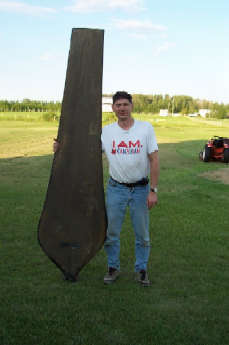

I am new to wind energy and my questions might seem a little silly to you experts.
My question is " are blades that are originally designed to move air, good for driving a generator"?
The reason I ask is because I am the proud new owner of a set of 7 ft blades off of a industrial cooling tower. 7+7+(2ft.hub) = 16 ft diameter rotor.
These blades are a carbon graphite coposite that are designed to move masive amounts of air.
The cooling tower fan had 4 of these blades and required 100 HP motor to drive them.

No' the airfoils and twist are backwards.

Do you have some pictures?  I suspect that you might have to modify the hub to make them work properly.  Remember that you want the flat side of the airfoil to face into the wind.

Can you cut them loose and bolt them to a new hub? If you can I think they would work great.RobC
« Last Edit: July 01, 2004, 08:37:43 PM by RobC »
Re: will this work?
« Reply #6 on: July 01, 2004, 09:05:40 PM »
Why not just turn the whole thing around?
« Last Edit: July 01, 2004, 09:05:40 PM by Ungrounded Lightning Rod »

If I can figure out how to insert photos, I will provide photos sometime next week.
Today is the start of Canada Day long weekend and I will be in another province.
I only have 2 of the 4 blades and no hub.
I will have to make my own hub. It looks like it will be easy to adjust the pitch of the blades.

If the airfoil on the blades is not a true airfoil but just a curve then you can just turn then around. But if they are a true airfoil shape thicker in the front tapering to the back ( Clark Y style )then turning them around won't work very well because you will be run the airflow over the airfoil backwards and the only solution is to reverse the pitch. RobC

« Reply #10 on: July 07, 2004, 04:56:51 PM »
I hope the photos work.

I think that they look good.
