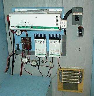

   I've been using Nichrome wire for dump loads for quite some time now and haven't had any problems.   I believe the stuff I have is .032 but the smaller stuff would work fine also with lower loads.  I have them paralled giving a resistance of .35 dumping up to 50 amps total.  I've never seen them "glow" but they do get extreemly hot.  In the picture, lower right is the nichrome heater.  The wire is wound around some ceramic tubes.  My original controller I simply coiled them between two connectors and it worked fine, as long as there is enough room for them to move around without touching something it shouldn't.

nice setup and photo. Where did you get the ceramic tubes?

   The ceramic tubes came out of a phone company power box arrangement.  They were actually spacers on a very large rectifier set up.  I'd like to know where to get them myself, they worked out very nice.  They are 1/2" in diameter with a 1/4" hole through them and are about 6 inches long.   If you or anyone finds them let me know!
