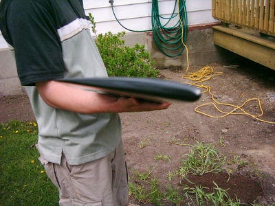

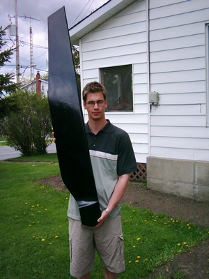

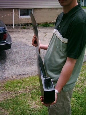

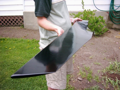

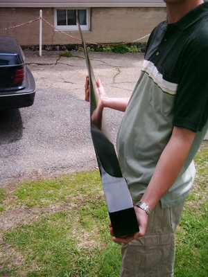

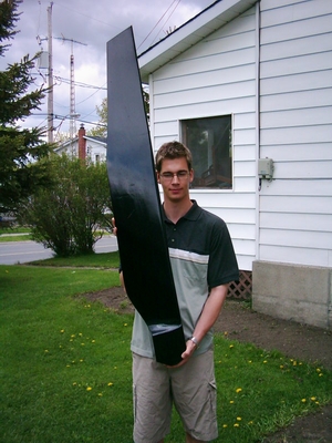

Hello everyone!
Here are a bunch of pictures of a blade i have just completed to hopefully have molded by a company that is willing to produce my blades for me in a carbon fibre/fibre glass composite.
The need has basically arrived by my own needs to be able to sell some generators with the blades also. Even locally where i live, i have been requested to make other people generators, however, what has held me back is the time consuming part of making the blades. Nothing definate, but seems good so far, the final cost in the end product will determine if i go ahead with the produced blades.
I have had much success using Alton Moore's program to make my blades from, and work extremely well with my induction conversions. I also beleive that the blades will be quite adaptable to the dual rotor machines. Very little seems to be available on the market for the more serious homebrew machine in blade availability, and many out there do not want to carve their own blades. I think this blade will be quite adaptable as the hub section will be able to be drilled for various mountings.

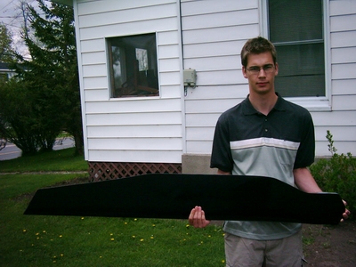

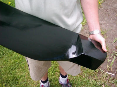

The blade i intend to use as a 3 blade prop. The blade is 5 feet long, so will give a 10 foot blade set. TSR is seven, with a tip angle of between 1.5 and 2 degrees, tapering to a root angle of 21.8 degrees at the second last station. The last station was reserved for the mounting hub. The hub section is 3 inches thick by 5 1/2 inches wide,the end is cut at 60 degrees for 3 blade mounting, with the widest part of the blade at 8 1/2 inch tapering to 4 3/4 inch at the tip. The blade thickness at the tip is 3/8 inch thick and the whole curved blade is carved to a usa35b airfoil profile. There has been some special modifications to the design which (with the help of some very knowledgable people on the irc) should prove out to be excellent in performance. As it is now, i know it will work with my conversions very well.
Here are the pics (still not the best camera man around), and i tried most angles to give you the idea of how the blade looks with its profiles.
Almost forgot. I made this blade with laminated pine. The blade has to be painted with a high temp paint for the molding process. I chose to use engine enamel as it is good for 500 degrees.
Hope you enjoyed the post and will let you know how everything goes and if i carry through with having the blades made.

looks well made zub, but i wonder about the noticable change in angle you have at a couple places on your trailing edge, and the skewed tip. seems that those might lead to increased noise over the more oval planforms more often seen.
was wondering what your thinking was with those features?

 The chord looks awfully wide for a TSR of seven. comments?

Kitno455.   the change in the trailing edge does sort of look "abrupt" in one of pictures. think it is just the way the light shines off the paint. but when you eyeball it from the tip of the blade, it does look rather consistantly trailing. it is a twisted blade. should have included a picture of the leading edge, it is perfectly straight. the tip angle is a little unusual, but speaking with some very experienced prop designers, the skew will serve to make the blade quieter and reduce that turbulance that happens at the tip.

Victor.   yes the chord is wide for a tsr of 7. since most of the work is done on the outer part of the blade, i hope the increase in chord width will add to the overall performance of the blade set. with only a 1.5-2 degree angle on the tip, an increase in chord will add to the starting torque.
Everyone, this blade is a bit of an experiment. the only way we can be sure of getting some good improvements on new ideas is to build and try. i have often seen in some other circumstances (not necessarily gennys and props) that when our design practices seem to tell us that a design is not good, often works quite well simply because we did not make the new design from the old way of designing. very often my "gut" instinct seems to work out i think simply because i have not been trained in the usual set way. this blade will also answer some questions and i hope give the answers for a few people that have spent much time with me looking to improve what we do now.

Zubbly, I could be out to lunch here but my feeling is the blade area coupled with the low tip angle should yield decent performance at lower wind speeds if it doesn't stall. I wouldn't bee too concerned with the additional cord width.

      The round leading edge, should result in a gentle and smooth stall characteristic , But I too, wonder about the tip width  -- Best test, will be on a gen in high winds !!   Nice work, Bill H......
