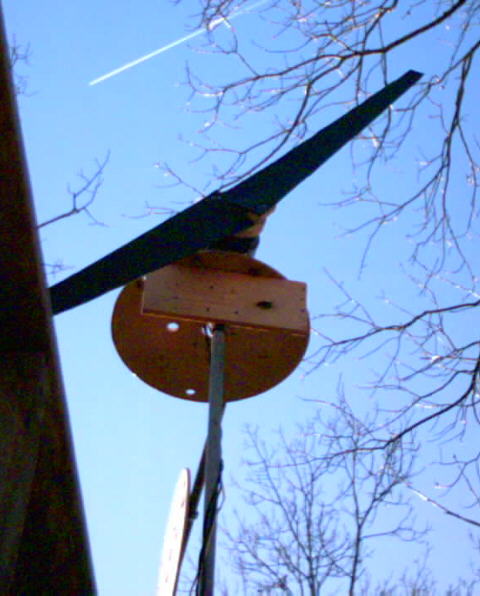

Built a four blade rotor today using the same blade size and shape as the two blade above, and while it did start by itself, as you suggested, the blades are too long and it doesn't spin fast enough to produce anything significant.
I'll trim some off the blades tomorrow and try again.......
Once I can get it working right I'm going to laser cut a hub out of either steel or aluminum and build a more than junker rotor....
« Last Edit: July 28, 2005, 01:10:56 AM by ZooT »

Made up a pair of swastika hubs today configured so the leading edge of the blades will be 1/2" past dead center.
Tomorrow I'll drill the holes and bend the hubs to generate the blade angles and maybe I'll get a picture or two.
Oh and by the way.....did you notice how nicely these motors fit inside a 3 pound coffee can?........you know.....the kind with the resealable plastic lid*grin*
« Last Edit: July 29, 2005, 12:01:55 AM by ZooT »
ZooT
  • Posts: 187
Re: New Idea Makes Box Fan Conversion Very Easy
« Reply #43 on: July 30, 2005, 07:59:57 PM »
Got those swastika hubs bent and everything done as far as the prop goes, and welded together the rest of the genny today.
I cut the blades down just past the "trailing angle?" so the blades themselves are about two inches shorter than they were
Rather than what I expected, when I stood my ten foot thinwall conduit tower/pole up with the genny on it, the thing turned into the wind and the rotor started turning.
All I could do was grin like an idiot*L*
Probably had 15 mile an hour gusts today and I was getting readings 15.4-15.6 volts DC.
After that I tore it apart and painted everything, tomorrow, if it's windy enough I'll put it back together and see if I can get "she who thinks I'm crazy for building a windmill" to snap a pic or two....
Yup....today was a VERY good day grin
« Reply #44 on: July 30, 2005, 09:13:13 PM »
Great!  Congrats!
How easy did it start?
If it started very or quite easy, you may want to take off a couple more inches to get some more RPMs. (its not like me to tell someone to cut up something that all ready works)  Maybe 2" at a time if there is no apparent difference in the diffuculty in start-up, then stop at the first sign it starts harder.
But the low voltage reading could say it needs more RPMs.  You were getting 32VAC spinning the 20" fan blade by hand, so it should be getting 40 or 50VDC open circuit without much trouble in the wind.  It sounds like the blade is too slow.
(I'll point out again that I'm not the guy to ask about blades)
My belief, which may not be based on fact. On a day with some wind power, a gust should get it started turning, then it will keep turning a lot easier. And the faster blades will get more power at a lower wind speed after the gust gets it turning past the cogging of course.  I never flew anything that cogs magneticly like I'm sure that does.
""the thing turned into the wind"".  Did you get a tail on it?
With single phase, does it vibrate like a cat with its tounge in a 220 socket?
It might when a battery is connected.
The bridges are high voltage I hope.  Like 100 or 200V.
If the thing gets turning fast, without a charging battery to take the power, the volts can rise very fast and maybe pop the bridges.  I mean, when the blades are right and it really gets spinning, it can just take off spinning much faster than you imagined, the volts can go up a lot faster than many people expect.  And it can shock the s*^t out of you too, which only seems to happen when my neighbors are watching. ("Hey everybody! Come watch! That goofy guy with the fan shocked himself again!")
How much pressure did it put on the mast?  However you can explain it.

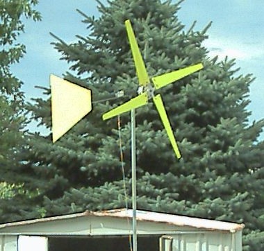

« Reply #45 on: July 31, 2005, 02:28:56 AM »
I've never gotten anything over 24.6 volts on the DC side of my bridge but in all reality 13.6 or however many volts it's takes to charge a battery with low wind is more than enough for now.
And yes I did put a tail on it....I C-clamped a 2x2 foot piece of 1/4 birch plywood to the angle iron that I'm using for a "body".
Tomorrow the new "tail" cut from the old one(just trimmed some off to give it a better shape) gets bolted on....But it gets bolted on about 8 inches further back to give a tail a bit more leverage for steering
As of right now the alternator is offset 4 inches from the center of the tail so I can add a side furling tail later.
And yes it did push against my "tower/pole" but it wasn't hard to hold or anything.
Needless to say I duct taped my multimeter to my pole so I could use two hands to hold the pole
And after building my new swastika hub, I think I might have done something good rather than bad as the something seems to have either added a flywheel effect of sorts or lowered wind drag caused by the old 2 inch thick wooden hub (X shaped) and it seemed to start easilly, and it keeps spinning at a lower windspeed than before.
Whatever I did it starts a lot easier....it still cogs though
The one thing I did do wrong was I gave no thought to the balance of the entire unit and it's tail heavy. Maybe phase two, the furling mechanism will use a piece of square aluminum tubing to lower the weight on the tail
The bridge is rated at 200 volts......I used heat sink paste and drilled and tapped a CPU heat sink and mounted it to that...
And I've never seen a cat with it's tongue in a 220 socket*L*

« Reply #46 on: July 31, 2005, 03:38:22 PM »
Here's a pic of the latest incarnation of my box fan*L*

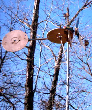

  • Posts: 1538
« Reply #48 on: August 02, 2005, 01:15:58 PM »
"Laser Cut?  I have a hacksaw.  And it is not even a good one!
The factory put the teeth on the blade facing the wrong way."
Ya they sell anything these days. I was putting in a new floor and the store sold me ceiling nails instead of flooring nails. Both boxes had the points on top and heads down :)
Have fun on the trip if you read this before you go, OR, I hope you had fun on the trip if you read this after you get back :)
« Last Edit: August 02, 2005, 01:15:58 PM by nothing to lose »
  • Posts: 1538
« Reply #49 on: August 02, 2005, 01:32:09 PM »
"Sure wins the ugly contest!"
No, I think mine still wins, and though moved several times after the trees bloomed it was still flying untill I went to Canada to visit Picmillian. I took everything down before leaving though so no problems while I was gone for the wife in case of storms and such. Time to fly again :)
« Last Edit: August 02, 2005, 01:32:09 PM by nothing to lose »
