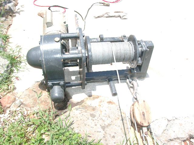

I am looking to build a tilt up tower in the 80-100 ft range. i have read thru everything on here i can find and still have a question or two. i have seen a few people using a boat winch and drill motor to raise and lower them are they using a block and tackle afair? any one got some pics maybe? the other question i had was if i can find say 4 inch light wieght tubing in 21 ft lengths what would be the best way to join them? thanks for the time on this at 100 ft dont want my new 10 footer to came crashing down

thanks wooferhound i had read all but one of those the winch is what has me the most confused i noted that dan had chains on his truck to raise his seems like that little boat winch woulndt handle it unless there where a block and tackle afair?

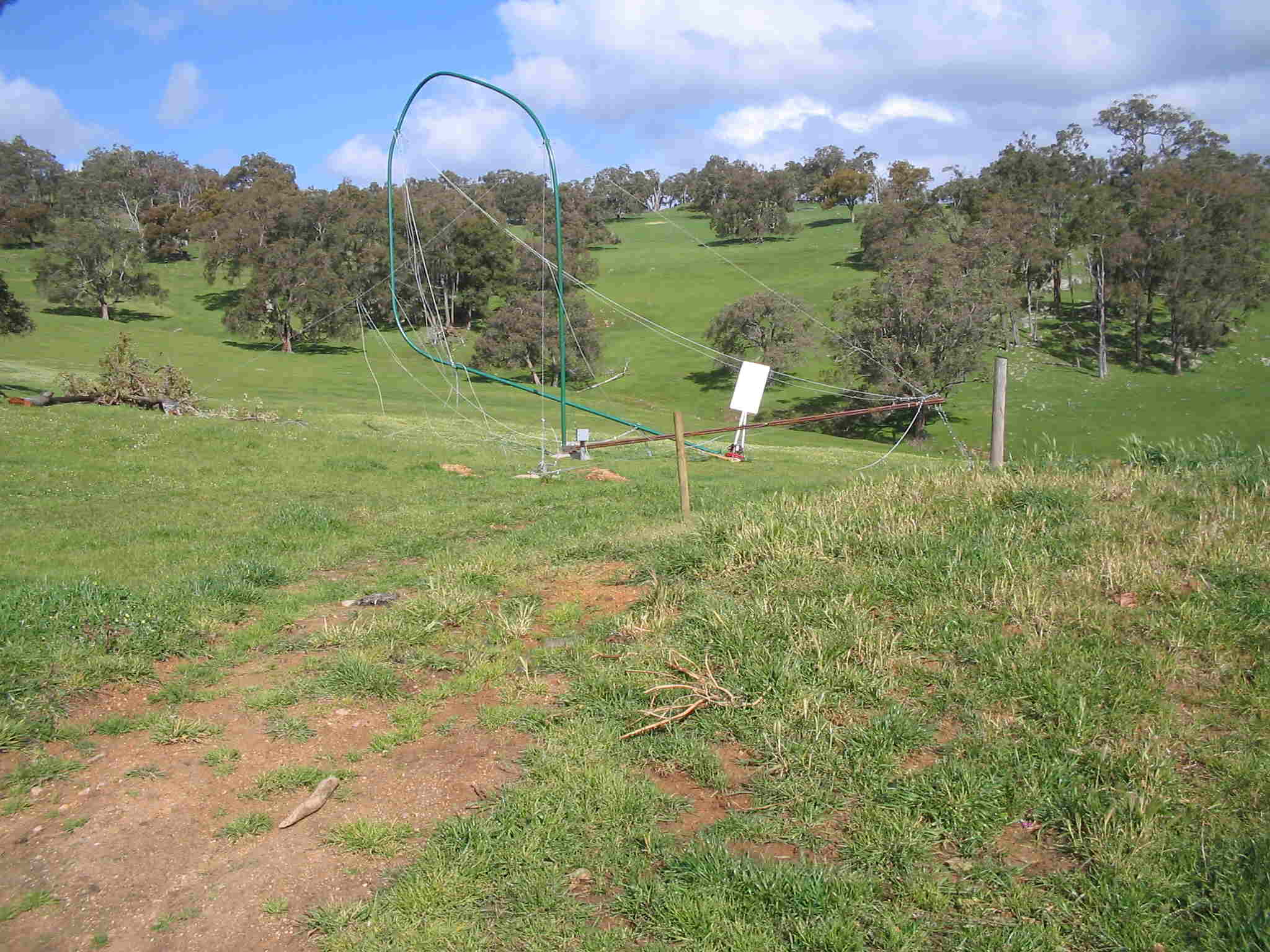

80-100' is a serious tower that requires some careful concideration of your wind conditions, rotor diamiter and tower design.
Guy radius is critical as is spacing particually the upper half.
I had some heavy walled boiler tube machined down to fit into the tower pipe but left 2" full diamiter to weld lugs to.
I also use an endless winch, very controlled.
http://shop.btcv.org.uk/shop/level2/8/level
Tower hogging during raising and lowering can be a big problem with tall small diamiter towers. Having said that 4" is probally doable.
I can take pics of joiners and winch if required, pics of 80' tower failure in my photos.
allan down under

I am not a structual enginere so can only speek fom my experience. Anything over 60' I would use at least 5", as to wall thickness, larger diamiter can have thiner walls as strength is in cross sectional area.
My commercial tilt tower by Synergy is 90mm(3.5") OD with very thin walls, is 58' tall with 4 sets of guy wires, it has a 2.8m rotor on top. The blades are fiberglass with the generator casing being aluiminuim, so not a lot of weight. IT has a "boat winch" which is easy to use, BUT it has no ratcheting when lowering, so don't let go.
Hogging during raising and lowering was something I was unaware of until it happened to me. Guy radius is more critical as height increases, never less than 50% tower height and for a 100' tower, well I would have to do the maths but at a guess 65-70%.
 The reasons are to do with the bending moments around each guy attachment point. If you were able to attach the guy wire to a sky hook such that they were at 90 deg. to the tower it would never go any where, but in reality we can not.

Halfcrazy, For my money an 80' tower is doable with 4" pipe for a 10' rotor, of course with 21' lengths it will become 84'. My failure had a number of contributing factors, but Murphy just kept hitting me over the head until I arrived at an excellent 10' duel rotor on 60' tower.
Do not skimp on the number of guy wires and have wide anchor points. It is critical to have the top anchor points closer than the lower ones because their angle causes much of the load to be transfered  to the next section down. And if its too far to the next anchor point it can bend.

I use a mid-sized skid loader, 773 Bobcat.  The low range of a heavy truck would work.  Anything that can go "real slow" and no sudden starts or stops. A bigger tracter, I wouldn't use my Allis Chamler WD. I have seen a heavy duty "boat winch" used, and that is a bit too slow.

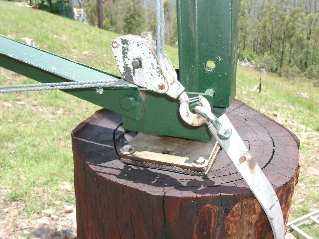

One end of the cable goes is attached to the anchor just past the end of the gin pole. Next the cable goes through a pulley on the end of the gin pole and back to a pulley on the anchor.  The other end of the cable is attached to the bobcat.  I can double check tomorrow.  There is a poly rope that goes from the gin pole to the two anchors on the sides to steady the gin pole.  You want to make sure all the hardware is rated for the weight you have. A good farm supply store is a good bet.

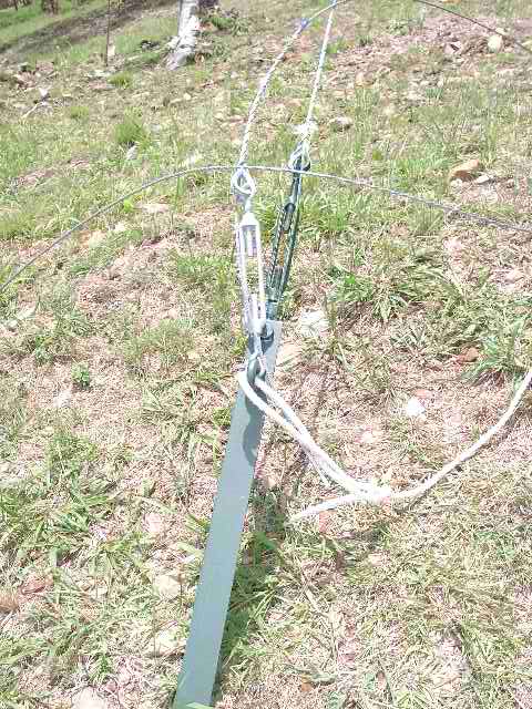

Did you pick up from the docs how the guy wires are brought from the anchor to the end of the gin pole? That can be tense if a breeze comes up. It only takes about 5 minutes to lower or raise the tower, but I spend an hour double checking everything before hand.  Also, always do a dry run first with your new tower.
