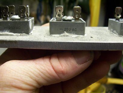

below is a picture of some 25 amp bridge rectifiers. you will notice the negative sign, and then the number"252"(denotes 25 amp), then "ac" (which is the positive)..
  the steel pin above the negative sign is the negative, and the pin above the word "ac" is the positive.. a rectifier will 2 of each on it usually(one each side)
  plug the wires from each phase of the stator to the "ac"(positive) on  the bridge rectifiers..and just run the negative wires in parallel to the negative pin(-)...
 If you wanted to get fancy, cross the postive to the other side of the rectifier to the other positive(it has two ac's on each rectifier)....some say it makes the genny run better..
  i do this, and i havent had any problems...
    looks great...good luck..pickster

forgot to mention in my post above..the white stuff under the bridge rectifiers is dielectric grease..it is used to take the heat from the rectifiers and dissapate it into the aluminum heat sink below..you need both the dielectric grease, and a good heat sink,(nice size chunk of aluminum) to decrease the chance of overheating the rectifiers.. pickster
« Last Edit: January 01, 2006, 06:31:11 PM by picmacmillan »

but if yours is a 12V machine there I thinkyour heat sink may not be up to the task.  Ive had much larger heat sinks (with lots of fins) overheat on 12V machines with blades between 10 - 12; diameter.

ya :) thanks dan ..that was my first attempt at a heat sink a couple years back, but about that time, i seen your post about your heat sinnk being too small, and i remember that yours was 5 times the size of mine, so i quickly deducted that i needed to improve :)  thanks dan  pickster
