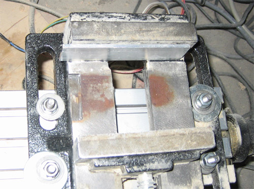

The stepper motors had gotten out of whack and lost steps.  After several attempts, and a couple broken bits I was getting frustrated.  This had happened from time to time with the smaller blades, but the amount of carving with the larger blades is a multiple of that because not only are they longer, and wider, but I had set the distance of travel down the x-axis to one 32nd of an inch between steps where the airfoil profile was carved to minimize the amount of finish sanding required when done.  The straw that broke the camels back for the stepper system was that on one attempt it lost steps on the z-axis, which is the vertical axis, and actually carved the top of the airfoil into the steel surface of the vise I was using to hold the stock material.  It carved about a half an inch of it before the end mill snapped.
You can see the airfoil caved on the left side of the vise.
Frustrated, I switched the steppers out for servo motors, which operate with feedback.  Now if the milling machine gets out of alignment, the controller receives feedback so it can try to correct the situation, and if it cannot, then it shuts down.

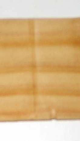

I had one more minor mishap in that I didn't fasten one of the blades securely in the vise, and it slipped while carving.  The program ran to the end pushing the blade along, and the only damage to the stock was a slight groove cut at one position out along the blade.  I secured the blade and re-ran the program and the blade came out with the only damage shown in the fuzzy pictur below.

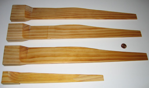

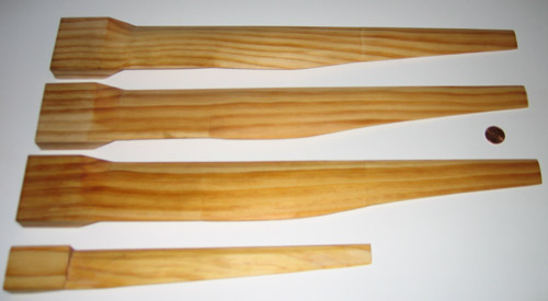

Everything else was uneventful, and I ended up with three blades to test.  I gave the blades a quick once over with fine sand paper, and coated them liberally with linseed oil.  Here is the front.  I put one of the 12 inch blades in there for a size comparison:
You can see the damage on the middle blade towards the left where it slipped out of the vise.
Here is the back:

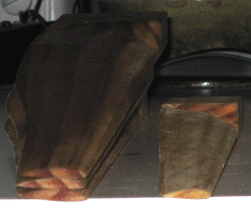

This is a view of the airfoil:
It is interesting to look at the trailing edge of the blade as you can see the theoretical curve and where it gives way to a straight line as the size is limited by the stock of wood used.  You can see how the trailing edge of the blade curves up gently from the right side, accelerating as you move towards the left until it abruptly changes to a straight line.
The theoretical chord width from the model I am using doesn't hold up near the root that well anyway as it becomes absurdly large.  I maximized the chord and angle for this portion of the blade based upon what the stock would allow.

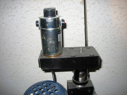

Next up will be to test these blades out.  I purchased a cheap Anemometer set and will have to mount it as well.  I plan to use the 30V Ametek motor that DanB graciously gave me when I was out there last April.  I don't know how well the power curves of the alternator and the blades will match up, but it is a starting point.  I should be able to compare the approximate wind speed with the amps out of the mill to a battery at least.  I will have to build a mount and frame for the wind turbine as well.  Also, this project is also going to get pre-empted for a bit by  an important project to build a pinewood derby racecar in the shape of a shark. :-)  I plan to post results as soon as I have them however.  Rich Hagen

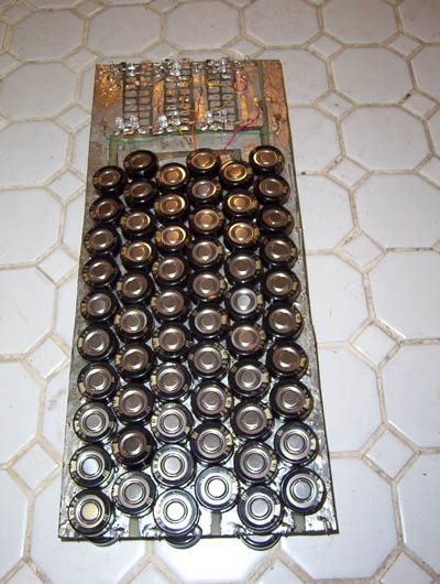

How many caps are you using to get  15 Farad @ 15 volts?
and what is their individual capacitance?
very neat stuff.
« Last Edit: January 23, 2006, 10:58:48 PM by willib »
  • Posts: 1599
Re: 18 inch CNC blades ready for testing
« Reply #8 on: January 24, 2006, 03:38:42 AM »
I had a bunch of surplus 1 farad at 5.5 volt caps.  It takes 9 of them arranged in strings of three to equal 1 farad at the series voltage, which I limit to 15.3 volts via zener diodes.  The board has 145 capacitors in total, they are mounted on both sides of it.  Here is an old photo of it.
It is still sitting in the same spot as in the photo from the 2 foot turbine test post.  Rich
