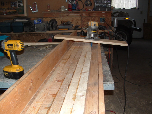

I think that the blades could be made
big and simple with different methods.
One possibility is to use triangular
sail wings.
Another possibility is to make them
like in these pictures:
I've been experimenting with my friends
with really simple wooden blades.
http://www.fieldlines.com/story/2005/12/29/205319/65
