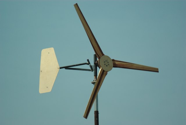

Pictured above is a beautiful sunset (I shot the picture from the window of our van while driving).  Look carefully and you can see Mick Sagrillo's 3 wind turbines (where we put on this work shop) and then a utility wind farm in the very back ground.  Wisconsin is beautiful.

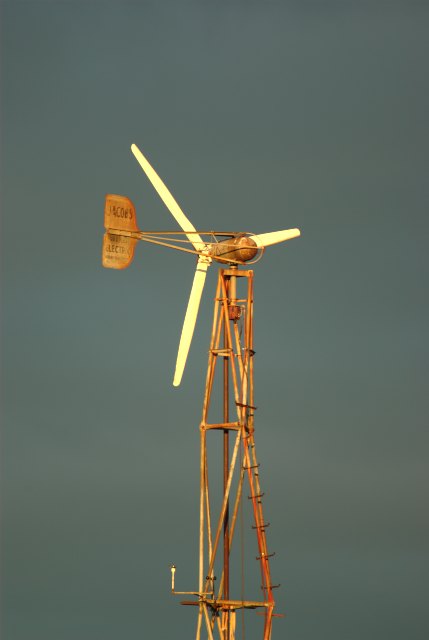

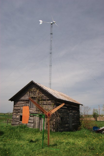

Nice to teach a workshop like this surrounded by wind turbines!  Pictured above is Mick's old Jacobs turbine.  Currently it's shut down needing new brushes and maintenance.  Nice old machine though.

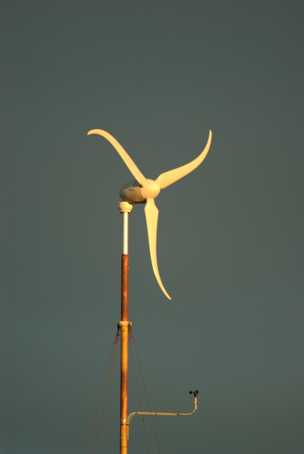

Mick also has a new South West Windpower 'skystream'.  Its a 12 foot diameter turbine with a built in grid tie inverter rated at 1800 Watts.   It's a down wind turbine.  The blades are funny looking, the idea (from our understanding) is that they are shaped the way they are to minimize the 'thumping' sound that happens in some down wind machines when the blades pass through the 'shadow' behind the tower.  This machine was also broken down when we arrived, the built in inverter is likely the problem but nobody was sure.  Mick said that when it is running, it's rather loud.  He said the alternator makes quite a fair bit of noise and the blades also still make too much noise as they pass through the wind shadow behind the tower.  We never got to hear it.

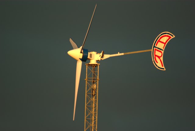

Mick also has a very impressive ARE (Abundant Renewable Energy) 442.  This is basically a very much scaled up (23 foot diameter I think - 10kW rated output) version of the old African Wind Power turbine.  Very nicely made (and expensive) machines.  Unfortunately though this one was also broken down when we got there.  They did fix it while we were at the workshop.  It was terribly noisy when running though.  It is a new design and I expect the company will solve that problem.

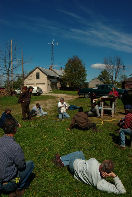

The first day started out at a local 'town hall' that we used for a bit of classroom time, to go over some basics about wind power theory and wind turbine design.  Then we had lunch and got started with work in the shop.

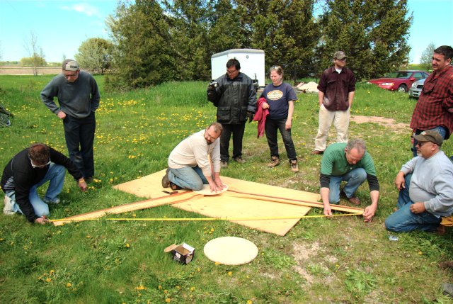

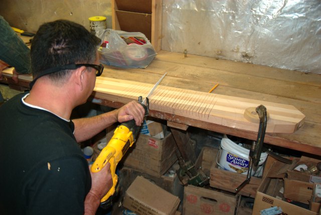

Jody laying out the blades.  Lots of work to carve all these blades.  We needed to have between 4 and 6 folks working on blades for almost the whole work shop.  10 foot diameter blades are not so bad, but the 17 foot diameter set is quite a lot of work.

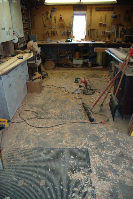

Mick offered us a nice shop to work in.  It's basically divided into two rooms - a wood working area and a metal working area.  Pictured above is how the wood room looked at the end of most days.  At first, the hours of the workshop were 9am to 6 pm after which we'd clean up shop and put tools away.  The last couple days had me worried that we might not get everything done so most folks started at 8 am and we often went into the evening on some projects.

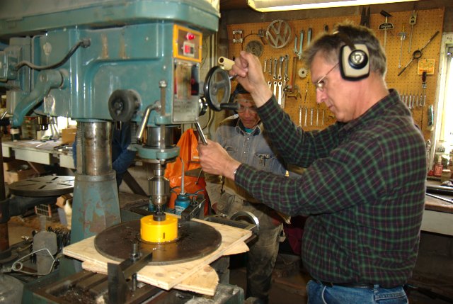

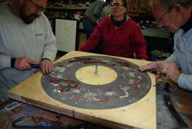

Forrest cutting out the centers of the magnet rotors for the 12 foot turbine with a hole saw.  Again, the 12 foot machine was totally from scratch.  The magnet rotors are 14 inches in diameter, cut with a torch out of flat 3/8 inch steel.

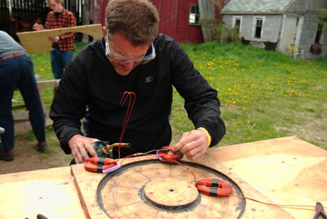

Pictured above: Cliff soldering connections between coils for one phase of the 10 foot diameter wind turbine.
Pedro placing the large 3 inch x 1.5 inch x .75 inch thick magnets on the rotors for the 17 foot dia turbine.  These magnets are very strong and difficult to handle.

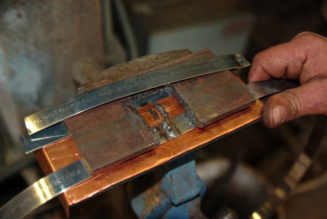

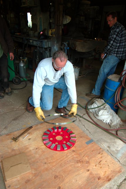

I made this jig for welding the stainless steel bands that we shrink around the magnet rotors together.  It worked well.  The bottom is lined with copper so we don't weld the stainless to the jig itself.
Ken using the torch to heat one of the stainless steel bands for the 17 foot diameter machine.   When we make the band, we cut it about 3/16 inch shorter than the circumference of the magnet rotor and weld it together.  Then we heat it with the torch until it just starts to turn slightly yellow in color.
Once the band is hot enough, somebody (Paul, in this case) wearing leather gloves grabs it and quickly drops it around the magnet rotor.  It shrinks to be a very tight fit after it cools.

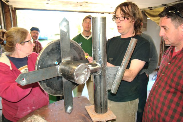

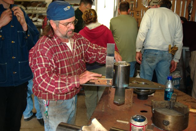

George was with us to give instruction on metal work.  Pictured above he's pondering the frame for the 12 foot turbine.

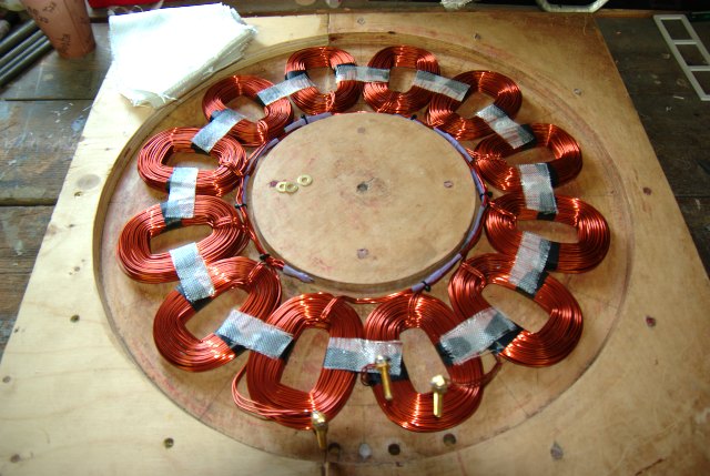

There's the nearly finished stator for the 17 foot turbine!  All the coils wound, not much left to do except for casting.

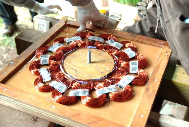

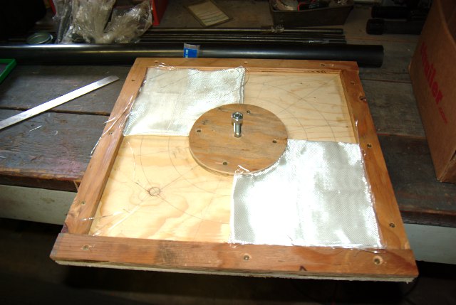

The stator mold for the 12 foot turbine is square, 17 inches on each side.  In the picture above they've cut the fiberglass for the stator, folded it up and put it in the corners.
Cliff seems quite please with the stator for the 10 foot turbine!  It came out perfectly, no air bubbles or imperfections of any kind.

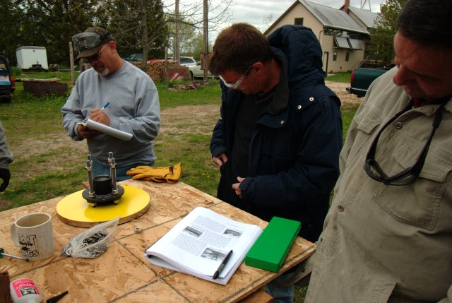

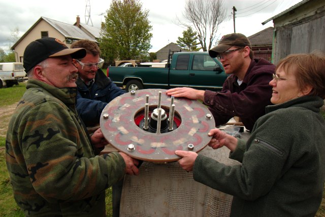

On Thursday the 10 foot turbine was about ready to go, folks follow the instructions in the book to assemble the alternator.
Pictured above the alternator for the 10 foot diameter wind turbine is finished.

The stator for the 12 foot turbine ready for casting.  We wound these coils with two strands of 13 gage wire in hand and 33 turns per coil.  It's for a 24 Volt system.

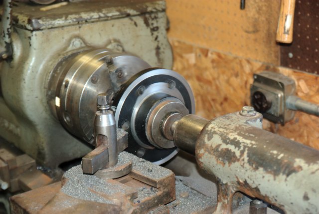

Fitting the stator to the 17 foot wind turbine!  This one got a bit frustrating - we assembled the whole machine and noticed the back magnet rotor wobbled rather badly, so much that we could not get the airgap adjusted within reason.  So we took it back apart to figure out the problem.  On this machine, the back magnet rotor comes right up against back surface of a 6000 pound wheel hub.  We always choose a hub that has the back surface machined (it's a lathed surface).  Turns out the hub was about .040 out of true.
Fortunately we had a lathe available.  John C. turned the back surface of the hub so that it was within .001 inch.  After that the alternator for the 17 foot turbine went together smoothly.

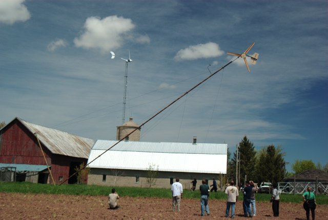

Pictured above I'm wiring up the 12 foot turbine on the end of the 80 foot tower.  At this point it's Saturday just before lunch - last day of the workshop.  We have a few hours left!

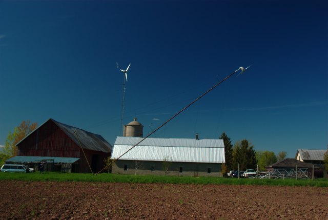

Up goes the 12 foot turbine!  Pretty interesting erection really.  The gin pole for this tower is about 25% the tower height, Mick pulls it up with a tractor but the weight of the tractor and the traction is marginal - he needs to push off with the bucket to get started moving!  We also had a block and tackle to help  - without that it'd be impossible.
The 12 foot machine seemed to work fine at least in the low winds we did have.  I wouldn't be surprised if the alternator stalled the blades a bit in higher winds, in which case we would add a bit of resistance to the line.  As it was though, winds were between 8-12mph and we were seeing output averaging around 200W.

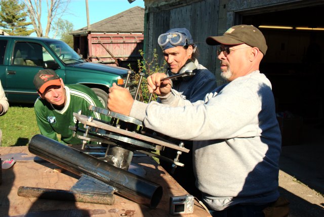

   first the flange fitted in the pic here.
   is that standard for your mills.
   its looks interesting  the top fitting has gussets welded on and looks like i might try the same thing.
   second i see there is six lug studs and nuts.
  it looks like it works out well for two studs each blade.
   four and five studs  not so good as the six.
    on the bigger mills its just right.
   so thanks to you guys and all who was involved in the making of this great post.

Hi - normally if we use large pipe then the tower stub is similar, but - we don't normally bolt them on like that.  We had to make a stub that would fit the same flange that works with the SW windpower Skystream turbine.
