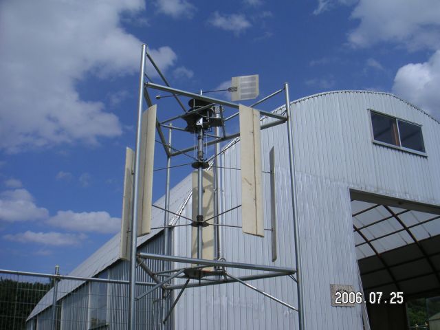

My Ahaa! Project, Auto Pitch VAWM
When I saw a picture of large size VAWT that setting public place like as the Park in some where, I wander why not those Wings have the movable Pitch to up wind, when thinking that, I got suddenly an idea came up my mind, that it!, might be possible pitch control simple devices applied like as "Swash Plate", it was trigger beginning my Ahaa! Project last December, remind that I saw the parts at Home Depot quit a long time before, it's a very large size of flat shape ball bearing made by tin plate, yes remember that time I had a curiosity about who use it? What purpose?
I have not surly plan and nor any reference information, but decided to start build a auto pitch control VAWM project with the condition of: (1).minimize expense as possible I can, (2).look around usable things & available resource. Realize moving object to proof a concept.
If the turbine shaft generates enough Torque, I d rather hooked up water pump but hold any expectation until I get good result on this prototype..
Frame must be rigid and robust for anti-vibration triangle pillar structure by 48mm & 25mm iron pipe.
Wing size: 250mm x 1200mm (Wight 980g) 5 wings supported by upper and lower hub ith spokes lower spoke supports each wing weights and 5 upper spoke have pitch hinge pivot.. avoidance any bent of pipe spoke which may trouble by the friction of inner push-pull rod. So it must be deadly straight without any vertical load. Otherwise change rod to wire.
Possibly "SWASH PLATE" is commercial name??, so I call those units here as "PITCH PLATE" Using two unit of Pitch plate, one is top for whether cook and second fix on gimbals under Frame head. top of free rotating bearing (Pitch plate) is to be fixed have a shallow angle to Rotating axis of weathercock, This plate angle makes displacement by wind direction Changes. From this slant bearing angle (not rotate) draw the information by two thrust rods each other 90 degrees placement. this pitch plate has two vertical rods an, one is connected to out side gimbals frame which set bottom of tower head and the second to inner Gimbals frame keep with 90 degrees position each other.
5 vertical pitch rods connected each bracket on free rotating plate on inner imbals, each rod connected Inner rod in spook through L clank on upper hub, rod end connected each wing hinge, so that wind direction Weathercock pitch plate angle and its element of inclination drive to relatively each wing's pitch angle.
Then when the wing passing rectangular wind direction (against), pitch angle increase To maximum, same time opposite position wing's pitch angle decease, other wing crossing neutral at both of upwind, downwind passing to neutral pitch angle from previous state. Wings angle is not center symmetrical since odd wings count.
About wings trying use the paper honeycomb, but changed taking styrene form core. I did not available to access any NACA Airfoil, so that making template easy way but it is beyond the aerodynamics.
Hand lay-up skin with bidirectional glass mat used with WEST SYSTEM, result of vacuum bagging with handmade perforated vinyl sheet, unfortunately finished many
small dimple both side of wing which caused not apply breather sheet on perforated one, actually I want make smooth wing surface like as Surfing board, however never increase Wight any more, compromised single layer by seems it enough stiffness.
Finally test result is acceptable, several troubles happened and fixed by miner Modification Look like All mechanism has functional as intended, however there seems to be a problem in Durability, tin made ball bearing might be work not so long life, unknown fatigue limit about all pitch control links used ball joint (using Radio Control model parts). Every parts has moving very busy. At now wind was small, scared the frame has happened resonance by vibration when attack the gust or strong wind, So Need more robustness and dynamic balance.
Wind flow was unstable since test place was close the building, I fond that when whether cook stopped some direction, then next wind coming from others, wing tend to rotate backward little bit, But whether cook get turn by threshold, wing turn back leading direction quickly that is almost looks like Jiving.
this time I have no room to use any stainless parts, because almost doable expense.
Unfortunately I have not available web to show other photo, if someone have an interest about all process of my trial and error, I can send those to provided FTP space for photo and video clip.
Now looking for some one have a large lath, I will hand made thrust ball bearing from way-out free Automotive parts. Hopefully next step I will replace 60percent large size (300mm x 1600mm) wing, within 1.5Kg. it is limit of maximum size at same frame, stay rotating Diameter should be 1500mm with some kind of strong spook replaced, now the most question is AIRFOIL, what type is suitable of NACA?

You have done some intriguing work so far.  When I first set out to build variable pitch VAWT's, I found that I could not avoid a lot of complex moving components.  I eventually abandoned the project when I compared performance of the VAWT to the cost of the components I would have to buy.  But mounting yours in a cage, you have already done better than I did on the safety issue.
If you are looking for data about airfoils, either NACA or more modern, you can find lots of information on the internet at:
UIUC Low-Speed Airfoil Tests
and
NACA Technical Report Server
(Look for NACA TR-824.  If the search engine doesn't have it, I've got it here on my machine, but it's 19Mb.)
The definitive book on all NACA airfoils is Abbott & vonDoenhoff's Theory of Wing Sections, which is still in print.  They are the authors of NACA TR 824, too.
My point of view is that a simple symmetrical airfoil section will work the best.  Test data have been developed for NACA 0012 airfoils by Sandia National Labs that includes when the air flow is reversed over the blade.  These reports are also available on the internet.
I built blades very similar to yours during my original project.  I used a foam core and fiberglass shell.  You vacuum-bagged yours - I'm impressed!  My product was very light, like yours.  This is very appropriate for a VAWT of this size.
Have you fitted the rotor with an alternator?

While the whole thing looks great, I have one comment.  Those bearings are for a "lazy susan" which is a shelf in a cabinet that is round and can be rotated for better access.  They are designed to be used on a less than daily access schedule.  In other words, the cabinet may be accessed every other day and then it may only be turned half a turn.  You windmill is constantly in rotation and I am thinking that bearing will not last very long before it is worn out.  Especially if you are in a dusty environment.  Do NOT grease it unless you put it inside of some kind of airtight enclosure.  Dust will collect to the grease and become like grinding compound. Find a better bearing for longevity. . .

'Automotive type' bearing usually have an inordanant amount of preload and would likely prevent his mill from spinning. Some simple, and cheap, conrad types would probably work just fine and be much more durable than the lazy susan bearings he has now while still turning very freely.

First, everybody thanks for give me many kind advices and let me know the fact and truth Which I don't know.
Vane chicken (actually used be audio amp cover) with counter weight, and wings are looks like very sensitive, starting by faint breeze and round continues never the less quit amount of inartia (5kg for wings, 20kg for shaft and hubs, spokes).
I like the name of SUSAN!, It my stupid that put on enough grease both of Lazy Susan and Busy Susan, likely much contaminated by particles through Iron works cutting & brushing, must be magnetized balls has lot of iron dust. I am becoming worry about its drive to reduce MTBF half. (now rinsed and cleanup). Disappointed and forget about its reality after the searching alternatives, amazing its very expensive ( @US$700.) at same size ring bearing made by TIMKEN, KAYDON...,  naw awaered that no need such larg inside diameter bearing for wind vane axis, while others indispensable through enough hole for main shaft, some day I will hand made two years life at least substitute BUSY SUSAN. And starting correct the balls (couple of handled) of Automotive Bearing.
I have never experienced before about any Radio control, so spent almost one month to reach the HROBO & TAMIYA, after look around Junk yard. Concluded no choice other than 6mm diameter ball joint made by HIROBO, anybody know about around 8mm size ball joint industry grade?, it excess size like as gas arm such as car back door for my application, now I aware that never, never grease on ball joint. Even this TOY grade one.

Aerodynamic center of wings:
All airfoils have an "aerodynamic center".  That is the point around which all aerodynamic forces act.  Like the center of gravity, around which accelerations can be applied, the lift force and drag forces act around the aerodynamic center.  In most airfoils, the Aerodynamic center is at 25% of the chord.
The center of gravity of an airfoil, on the other hand, is farther aft, say 35-40% chord.  If the spar is near the 30% chord point, you have probably the best trade-off, and it looks that way in your pictures.
Airfoil selection:
Don't worry too much about selecting the airfoil.  The low airspeed prevents any airfoil from matching it's promised values in published tables.  This is a situation where you almost cannot win.  In the slow-start regime, the wind travels backwards over the wing during half of the revolution.  (Note that the aerodynamic center will thus change position to 75% chord, because the wing is travelling backward!)
Drag in reversed airflow is very high and the lift is greatly compromised.  Pitch changes will help by reducing the time in reverse-flow, but not eliminate it.  Pitch changes will improve the angle of attack at any given point of revolution, and that is whay you want to strive for:  optimized Angle of Attack through the entire cycle.
Not easy.  The airflow geometry is constantly changing as the wind changes.
May I also volunteer some terminology to help with the translations (are you using Google's translator?):
SWASHPLATE:  a plate inclined to the axis of rotation to effect a reciprocating motion.
CONRAD BEARING:  a very common type of ball bearing.  Available worldwide.  Cheapest, too.  You just buy complete bearings, not individual balls.  Also available are precision bearings with very small balls that allow very large diameters.  For example, look for NSK 9600 or 9800 series on the internet.
BELLCRANK:   A lever that converts a reciprocating motion in one direction into reciprocating motion in another direction.

Thank you for your advice, I found nice bearing at NTN dealer, but I am hesitate getting it, and can not make quick decision to buy, because very expensive parts has conflict my first policy, however first model now spinning very well not so remarkable vibration, but sooner later I have to replace befor the bearing wear out.
Finally I had ordered two same size bearing, in this occasion, I will change from fixed angle of pitch to variable pitch angle, for this feature, I have to use large diameter bearing as you can make sense at illustrations. Also things help my decision, neighbors who have large lathe and he let me use short time iron works. I can not make Bearing support parts without large lathe.
Now I have not any measurement tool and how to, so no way to assess the performance, assumed pitch angle is questions, one of method is change the slant NUT which make plate angel to the wind vane axis, Couple of different slant NUT has been changed, now 6.2 degrees used, this result wing Pitch max positive-negative 13.9 degrees, I can not judge its too abundant or just fit.  Another way is change the 5 pivot positions on pitch plate. Seem that pitch should be adjusted when windy.
Of course now it is a hypothesis, possible it does not work, but concluded that I choose the complexity of links than complexity re-moving the combinations of parts for the variable pitch angle. It may change zero degree to max with steel wire by hand.
Now I am thinking about the back lash which occurred at ball joint between bell crank and push rod, when push action, rod axis has turn 1/4 and pull rotate back as same, I have to kill the rod torque that loosing small amount of stroke length.
I have completely no reason make my VAWT with CCW top view; I found peoples wrote papers almost CW top view about VAWT. I am confused that. Should I re-thinking about Hinge structure for next WING?  Is that any connection for alternator?  Nothing the change except pitch hinges structure about me or should I make reversible wings.

Thank you for you advice, yes I have interest about alternator, before think about this I have to learn much about such as magnet, coil, inverter, and battery for this prototype. Ifm appreciated to great experienced front runners those people has providing me many information, However I guess this VAWT has low RPM for any alternator and too small torque even if drive with reduction pulley but I will try something after the variable pitch control completed.
though the machine had been running very well but happened several trouble by moving parts, aluminum push rod had wear out at both end of steel pipe, caused my basic error that I did not clean up the burr at end face after the metal work, also bell crank was bent by suspected incident wind. I have to replace aluminum push rod to stainless steel shaft. And more stiffens bell crank too.
I have noticed problem on wing that through the motion of it, wing is completely free movement on two pivots if not connected to push rod link to pitch plate, which structure has minimize friction and any resistance of inertia moment. This is guarantee link does follow the pitch plate angle to wing drive. Incidentally, wind has hit the wing with particular angle, then flapping it and one shot make stress to connected link directly.
At now I donft know action method, might be think about put on dumping factor to wing hinge however this increase resistance for push rod movement.. what is my ignorance, so many manufacture for wide range size of grod endh, from 3mm to 15cm. I did not know that and wrong search way by gball jointh. Also aware those are very expensive for armature builder. 8mm rod end should be applicable HAWT pitch arm..
