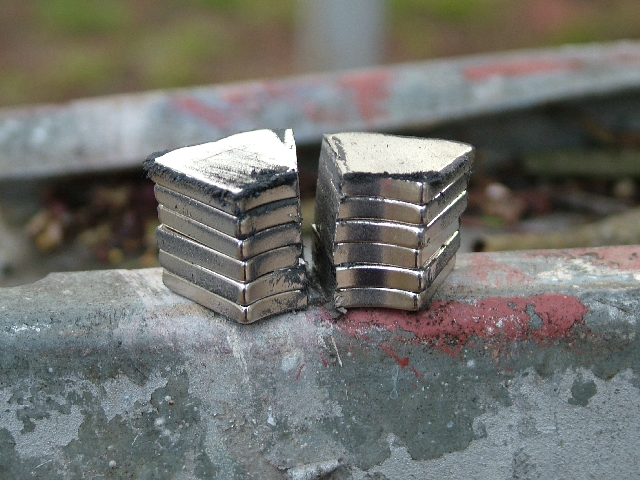

  1. break them in half. the neighboring N and S poles on the plate should be separated by a gap.
  2. stack them to make same height in each pile, dont worry about slight differences in area.

So I should break them, huh? Assuming I will, would it be possible to place - say - 3 half pieces of N pole side by side toward the disk center in order to increase the magnet size and the same with S while stacking them. up to 0.7" in height in order to boost the field and increase the coil size and thickness? That would require all my magnets for one rotor but I would then use a blank disc as a second rotor. Perhaps in time I could gather some more magnets to fill it up. Thanks for your suggestions but as I said, the rotors will be manufactured according to my specs - which unfortunately I don't have. Yet.
However I've seen great results with HD magnets used as they are, unbroken. The advantage is a greater numbers of poles, the main disadvantage would be the coil size. But smaller coils allow more of them on the disc. Or with an iron core ( in dual rotor with magnets) - a greater thickness, so... I really don't know what to say right now.

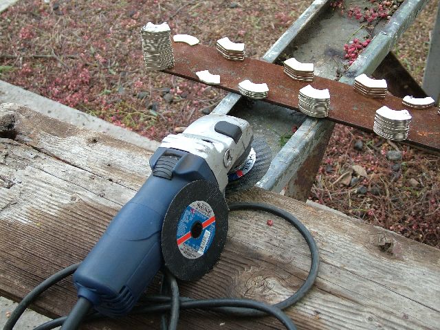

I believe more poles help too. 81 magnets, broken in half, is 81 magnets per disk.
With 16 stacks that is about 5 per stack. The nicer HDD magnets I have here would average about 12mm deep. Plenty of room for the stator.
With 16 stacks, it could be single phase with 8 coils, or 3 phase with 12 coils.

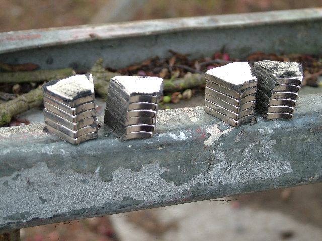

Right now, three scenarios cross my mind. I'll post the pictures here, it's worth a thousand words. Especially since my english gets rusty...
Will someone please tell me which way to go... I can't be sure of anything at this point.

build your geni like danb builds his.
 gurd and kitno laid it out for you.
your first diagram is the route i'm taking but you need to tighten up your mags
the space between mags should be the same as the width of you mag
some thing like this.
once the mags rotors are laid out. do a test coil.

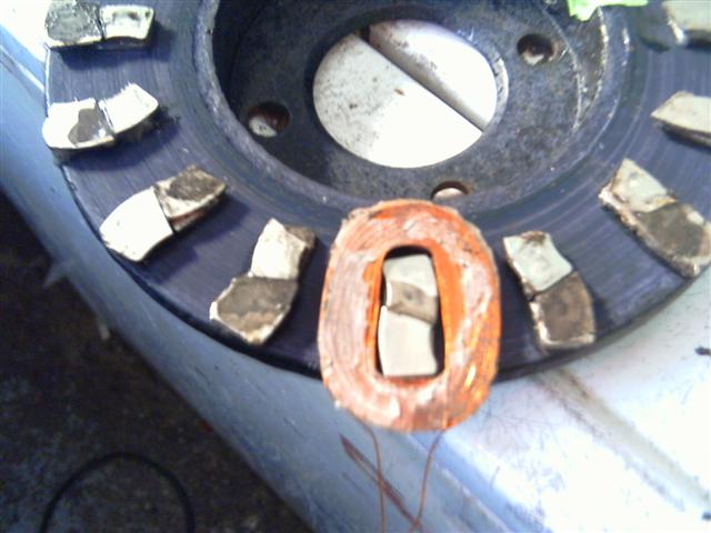

Yes ghurd, I like it too but imagine small arched pieces of half HDD magnet trying to look like a big square one... And if I want some usable power i'd had to stack so many of them that I'm afraid I won't have any magnets left for the second rotor.
Danb's layout looks more promising to me. With three halves in line and stacked it should work, I guess. I'll try to find some more magnets, seems to me that the "Search of the magnets" is far from being over... despite my folks opinion that I started to have an obsession.. :-)

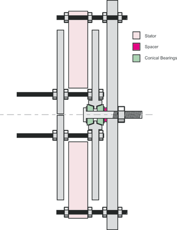

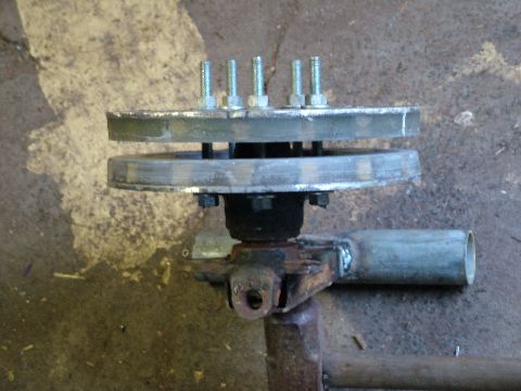

Anyway, I'll refer to the mechanics now since I'll obviously need more magnets. Here's a plan I made from my readings on this board. Can anyone see something I forgot? Faults... possible improvements...

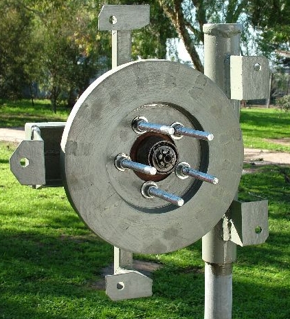

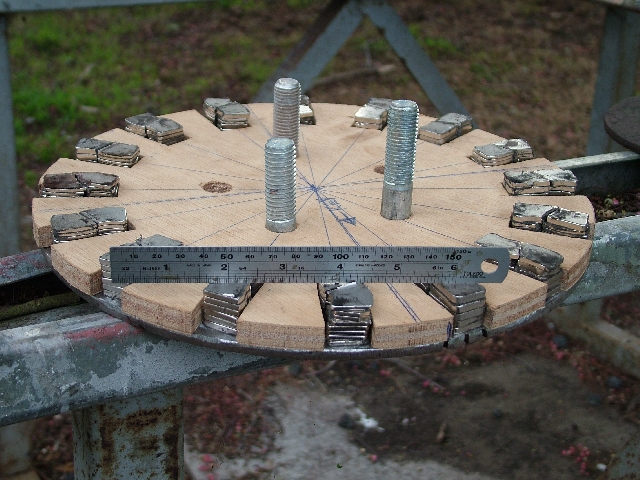

Here is how I do it.
I usually use anything up to 300 hard drives per genny.
I am lucky I have a good source.
You must cut them in half to get any decent results.
You must make your coils hole the same size as the mags and the width of the coil legs the same as the width of the mags to get optimal results
Mick S

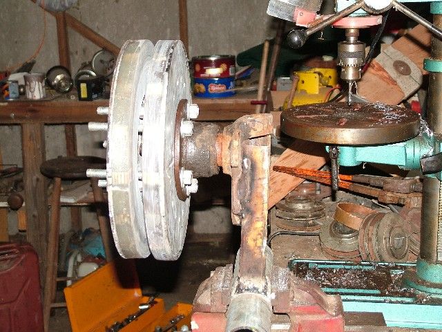

« Reply #13 on: September 19, 2006, 04:44:23 AM »

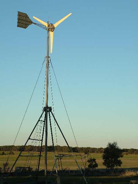

Here is one of them up on its tower with 3 metre diameter blades.
Mick S
« Last Edit: September 19, 2006, 04:44:23 AM by MickS »

Wow MickS, that's impressive!
Thank you for posting your pics. You used car brake discs I see... Hmm. Perhaps I should use them after all. Can you tell me the rotor diameter? And some output of that impressive 3m windmill? Also important would be what's the total height of your stacked magnets/pole. That way I could figure out how many years of searching hard disks I have ahead. :-)

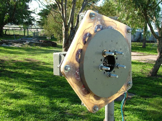

They are not brake discs.
I use stub axles and hubs off vehicles, but the discs are cut from 5mm (sometimes 8 mm) steel plate - cut into a circle and drilled appropriately.
Most of my stuff is scrounged (it costs me nothing), some times this method uses a lot more labour, but I would rather be doing something useful instead of wasting time watching television or some other useless pasttime.
The magnet size in the one I have shown here is 40 mm long by 20 mm wide and 20 mm high.

The rotors are 300 mm diameter.
Depending upon the diameter of your wire  and how much room you have for the coils and also how many turns you need per coil decides on whether you can use 1, 2 or 3 in hand. The more strands you have mean the lower the overall resistance of your coils.
Do a test coil, to determine how many turns you need to cutin at your desired rpm cutin.
  1. mm diameter wire is very easy to calculate how many turns will fit into a given area.

Below is an earlier genny I made, using a lot less hard drives.
These figs are from memory - I cant find where I wrote the details down.
Mag rotors are 220 mm diameter - 5mm steel plate
  1. mags per rotor, using 3 hard drives per mag - just make sure the piles are all the same height.
  2. coils (I forget the number of windings) One in hand of 1.0 mm diameter wire.
Just wind the coils big enough so that the 15 coils will just fit in the space available. I made the coils 10 mm thick.
This one has 5 coils per phase (3 phase star config).
Originally the output was a little low, so I dismantled the genny and drilled a hole through the resin in the centre of each coil, gathered up some iron filings and mixed them with fibreglass resin and filled the core holes with this mixture.
The resultant cogging does not affect startup and it has upped the output to where I easily get 10 to 15 amps into a 12 volt battery in a good breeze.
Lets see
24 * 3 = 72 hard drives for each rotor.
Two rotors mean you are still gonna need a minimum of 144 hard drives.
(Worth the hunt I think)
Good Luck
Mick S
Pics below.
