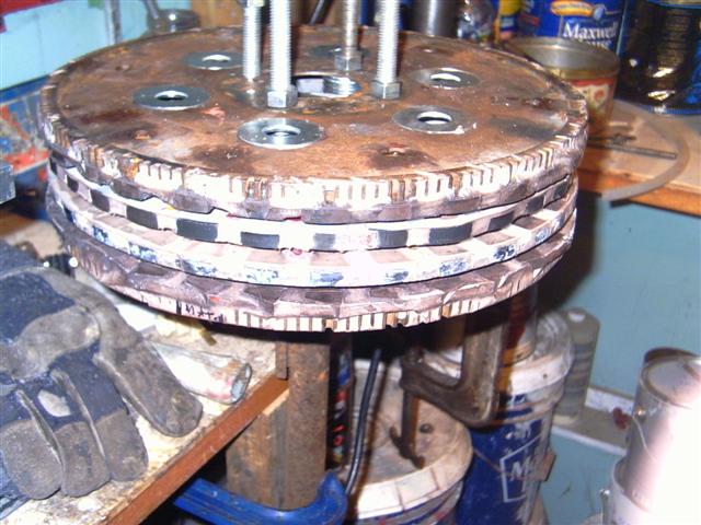

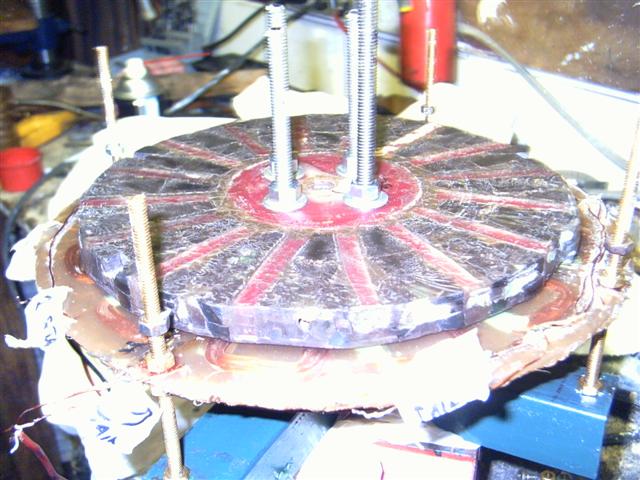

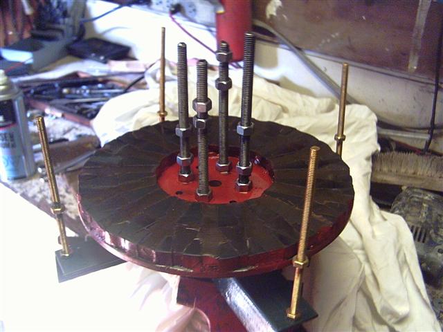

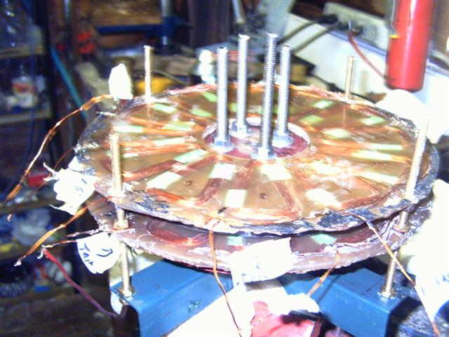

Re: twin wind turbine
« Reply #11 on: October 03, 2006, 07:23:33 AM »
northkorea,
if you put steel backing on each rotor you could run two stators.
if you left the steel backing off the two central rotors you could run three stators.
unless your a machinest, it's an alighnment nightmare.
lots of people have experimented along these lines including my self.
it can be made to work.
but as the othere have said it would be more stable and generate more power if all the mags were on two disks and you had a single stator.
« Last Edit: October 03, 2006, 07:23:33 AM by electrondady1 »
