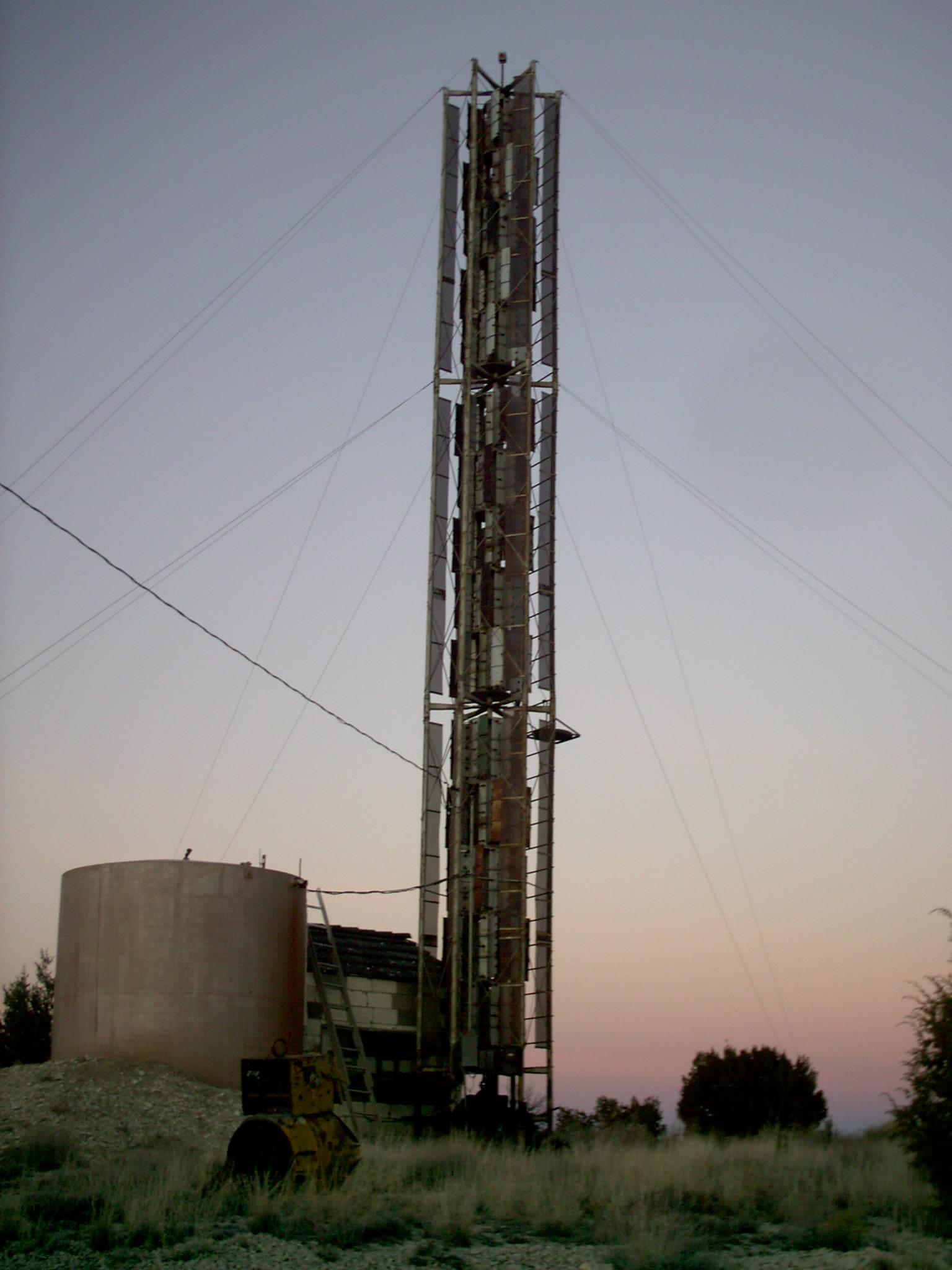

« Reply #9 on: August 30, 2008, 11:58:45 PM »
well here is a 10 kw  VAWT
