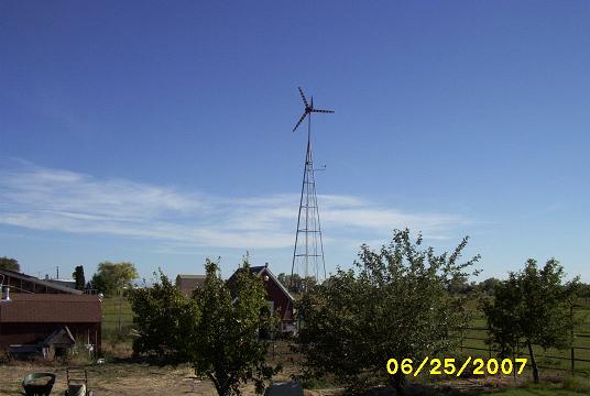

I recently completed my 103' tilt up lattice tower.  It was a used tower that I purchased from the local hospital when they put in a new communications tower.  I hinged the base (5 feet across the 3 legs) and use a 34' gin pole.  Guys are not hooked up during raising/lowering.  4 way guy wires are attached at 40 and 78 feet.  I used 3/8" guy cable and 1/2" tilt cable.  Pulled it up with my compact Massey 4WD tractor.  Good luck on your tower construction--keep in mind, better to overbuild than rebuild.
« Last Edit: August 23, 2008, 08:20:13 PM by mgtd »
