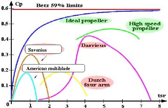

the big problem (of a VAWT) is the amount of swept area required to pull the same amount of power as a hawt.
Fortunately the above is not true.
As I have told many times on this site, the current knowledge says that if a VAWT is built well the difference is actually small.
The correct chart comparing different types of wind machines is below:
The above chart is wrong in most books about wind power, which people are reading. The correct chart and explanation of the error is available in the the very good book by Gary Johnson, which can be downloaded here:
http://eece.ksu.edu/~gjohnson/
I agree with the others that 'WindstuffEd' is the man on this board, who knows about building vertical axis wind machines.
There are not many vertical axis wind machines available commercially. But you can buy them as well ready made. There are available Chinese Darrieus type machines, there are Finnish helical Savonius machines and some others.
Any kind of wind machine will probably work much better, if you'll place it quite high above the ground.

Dear Hannu, I like VAWT's, but I remain skeptical about their ability to generate power in a cost-effective way compared to HAWTs. That being said...
I understand the frustration of enthusiasts who are not allowed to have a high-speed turbine on a 60' tower, and a VAWT "might" be better than nothing.
If Greg Johnson is correct, it appears from the chart that a Darrieus with a TSR of 4-5 would be the best possible style? VAWT's are so easy to play with, so there are hundreds of examples on the web, could you please point me to a link with an example of the style of VAWT you now believe is the best configuration?

Building a Darrieus that will both operate at all and operate safely for years is difficult.
For starters, consider starting:  Look at the power curve at low TSR:  A Darrieus already has to be spinning faster than the wind to collect power.  It has essentially no starting torque except when the blades are at a particular narrow range of angles to the wind, so a straight-bladed Darrieus usually needs something to push it to get it going.  (But you can't count on it to safely NOT start from the wind.)  (The spiral designs, and perhaps those with three or more blades, may self-start.)
Notice the tip speed ratio in the 4 to 6 region.  Imagine that mill spinning in 100 MPH hurricaine winds.  The blades will be moving at several hundred MPH, perhaps trying to break the sound barrier.  Even at lower winds those suckers are really moving - and presenting a narrow leading edge.  Sort of like swinging an oar so it hits edge-on.  Not something you want to walk into - or have birds, housepets, or neighbor kids do the same.  And you need a strong structure to hold the blades into a circular path against the centrifugal effect.
The wind load on an efficient turbine is nearly that on a solid wall with the same cross-section to the wind as that swept by the blades.  A Darrieus is a very spinly thing, with narrow blades.  So that force is very concentrated.  And (unlike with a horizontal-axis machine) the force reverses direction twice per revolution.  Imagine that massive force flexing the blades back-and-forth several times a minute for years.  This is a recipe for material fatigue.
Result:  Darrieus mills tend to come apart - usually while operating in a high wind - sending chunks flying at several hundred MPH.  Not something you want near your house or your neighbor's yard.
Now consider a Savonius:
The diagram shows a peak efficiency of about .3 - but that's for a classic Savonius:  Two half-cylinders overlapping by about 50%.  Sandia labs did an optimized blade profile that they patented (now expired), which they claim does about .37 - nearly the .42 or so of a Darrieus.
Notice that the peak is at a TSR of about 1.  The edge of the mill is moving at about the speed of the wind, not several times as fast.  Much safer.  The profile is also curved so it tends to push out things that reach in slowly, as opposed to being hit by a blade edge.
The structure of a Savonius - classic or Sandia - is quite strong.  The blades are large so the wind forces are distributed over a lot of area.  Spinning slowly means it doesn't need a lot of strength to hang together.  And it's self-starting.
The major downside (as with all VAWTs) is the slow rotation speed.  The amount of power you can get out of a given arrangement of magnets and coils goes up with the speed.  So you need to do one of three things:
