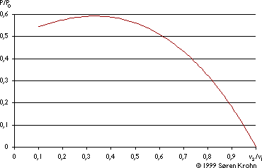

« Reply #5 on: December 08, 2008, 02:13:59 PM »
Hugh,
I find your comment confusing:
It would not be a good idea to reduce the windspeed to 82% of the upwind speed.  That is a misunderstanding and would extract only a very small amount of energy.
In your link above: http://www.windpower.org/en/stat/betzpro.htm they present a graph of P/Po vs V2/V1 (efficiency vs proportion of wind velocity after and before the turbine)
As per SparWebs example, an efficiency of 0.33 correlates well with a V2/V1 of 0.82
Could you please explain further?
« Last Edit: December 08, 2008, 02:13:59 PM by jimovonz »

« Reply #7 on: December 08, 2008, 03:14:50 PM »
Hugh,
Sorry, my confusion was not at Betz's findings but rather your asertion that slowing the air velocity from its unimpeded speed down to 0.82 of that speed through the turbine (as in SparWebs example) would result in very little energy capture.
I think SparWeb was using an arbitary figure for Cp of 0.33 as a reasonable estimation of actual blade performance rather than implying that 1/3 was any sort of significant figure.
From the Graph I posted, the Betz maximum of 59% at a v2/v1 of 0.33 is apparent, but so too is Sparwebs figure of 33% at a v2/v1 of 0.82.
In the scheme of things, 33% would not seem to be a 'very small amount of energy'
I understand that from a design point of view, you would look to obtain the maximum possible and accordingly use the Betz figure of 59% with a air speed of 2/3 at the turbine (being the average of the wind speed of 1 before and 1/3 after the turbine).
I do not mean to be argumentative here and am only looking to better my understanding and perhaps others.
« Last Edit: December 08, 2008, 03:14:50 PM by jimovonz »

Re: Blade Calculations
« Reply #12 on: December 10, 2008, 01:53:30 PM »
Here's the equation that relates the variables together.
where
v1 is the wind speed,
va is the speed the blades actually see, and
Cp is the power coefficient, not to exceed 0.593
Unfortunately the equation is funny cubic thing that can't be solved to go "va=###"
So you might as well just read the graph that Jim posted above or make a table of values.  To dive deeper, you can read through the reference manual of http://www.windpower.org/en/core.htm
« Last Edit: December 10, 2008, 01:53:30 PM by SparWeb »
