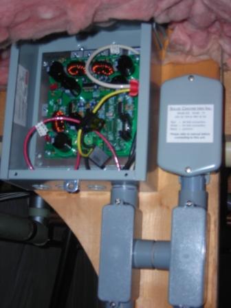

We started upgrading our system a couple years ago.  Similarly, were moving to 48V, but still had (and have) alot of 12V lighting and light duty loads.  While our PV array is now 48V (actually higher prior to the charge controller) our existing wind turbine is 12V - that will be the last thing to be changed.
We debated at length the best way to transistion our system from 12V to 48V.  What we ended up doing was to pull a 12V tap off the battery bank, and then equalize the batteries using a so called 'autotransformer'.
http://www.solarconverters.com/product_frame.html
It is a bit of a misnomer.  It really is an up or down DC voltage converter, but it has worked very, very well for us.  It is current limited so the battery will supply, or accept higher current of shorter duration.  Here's what it looks like on our system:
Don't know if it is of any help, but perhaps another approach.  Best of luck,
