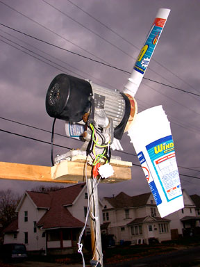

My "Ugly 30" has just lost its claim to fame.
I never thought it would be de-throned as the ugliest I ever saw.
At least "Ugly 30" was reasonably efficient.
(this photo is rated NC-17 due to graphic ugliness.  View at your own discretion.)
http://www.otherpower.com/images/scimages/2050/ugly30efkabuckt.jpg

LOL..ghurd.. yep thats hmmm ....
On the other , Tritium, might be the photo angle, but it almost looks like the blades are inflatable
(..forget furling , just deflate your blades)
Rover

Re: Ugly Turbines
« Reply #3 on: July 22, 2010, 05:07:02 PM »
G!  Is that an non-EPA-approved use of toxic plastic waste?
(Was it more or less toxic overall before you emptied it?)
