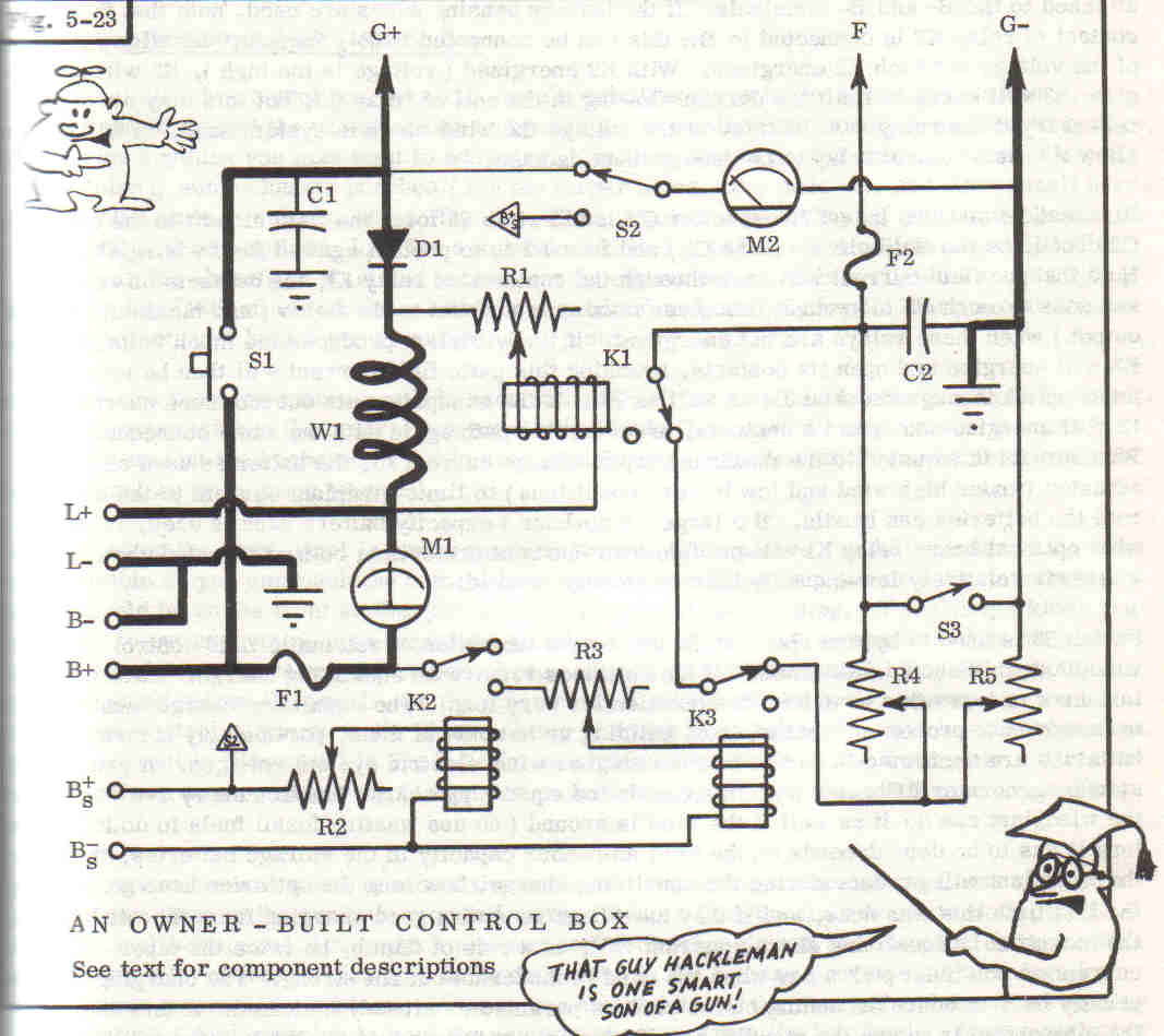

i found this dc current regulator i was wondering if it would work well for a windmill application
Electricity 1-7 by Harry Mileaf
I built my machine according to hugh's plans but here is the break down
  the coils have 300 turns of #20 wire 9 coils
when the generator is spun at 60rpm one coil is about 5.2 acv
  it only has one rotor with magnets on it but there is another steel disc on the othere side of the stator i used the 1.5x2x.5 inch neo's
  there are five brige rectifiers that are 35 amp 600 volts
the rectifiers are connected in parralel
it is a two blade machine
the blades are 8 foot dia carved to hughs plans
the wire coming down the pole is #12
i have a 60 amp ammeter
What i want to know is what size type of components will i need to get so everything works out. my windmill is a 48v machine but i want it to charge at 12 volts will that schematic do this
i found another schematic by michael hackleman for a windgenerator controll box man that guy is a genius
any coments will be helpfull
also thanks to admin for the FAQ which i just viewed it is very helpfull

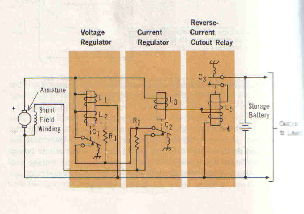

Not having a black belt in electrickery I can see it contains a lot of relays and lots of Amps meaning lots of sparking and arcing. Switching gets done these days with semiconductors but if this setup works, then it is OK.

I believe this is a voltage regulator control system which was used on all GM cars during the 60`s and below.  Why I know, is because my 1967 camaro had this relay type regulator and it worked fine. It lasted for years without any problems. The alternator in those days were in the range of 35 amps or so. I am sure the regulator is still around. Maybe at an auto junk yard nearby. The size of the regulator in my car was approx. 3.5" L x 2.75 W x 1.75"deep. Just a little info, hope this helps you out....Epower

Well if you want to reduce the out put to 12V from 48V neither of the schematics above will do the job, they will provide a measure of regulation for the generator for which they are designed but not voltage reduction/ conversion. What you need it a DC to DC converter.
May I make a recommendation... please read the archive of articles here at fieldlines, many of your questions will be answered in those articles, yes it will take some time to go through them but it will be time well spent, you will learn A LOT!!

These car regulators work by changing the field current. With permanent magnets there is no way you can use them.
To charge 12v batteries properly you need a winding that is matched to 12v.
You say that you followed Hugh's plans, but you seem to have changed everything.
You may be able to reconnect it for 12v but your description is too vague to be able to tell. Hugh's design uses 10 coils, if you have used 9 how have you connected it?
If you have connected it 3 phase you may be able to connect in delta but why 5 rectifiers for 3 phase.

Been lots of years since I last saw and old DC generator regulator from the 60's. My Corvair had one similar except for the adjustments. Hated the damn thing. Radio always had static. Had to change the capacitor on the L terminal a lot.
