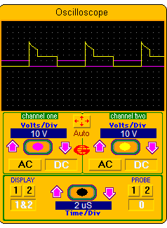

Okay, I've been looking at the other part of the curve...
Here's an example of an inductor voltage(yellow) vs FET off time(purple) plot that my simple simulator shows:
This is 17 volts in at 1 amp, 29 volts out, period = 20uS and duty cycle 50%
I think that the integration of the first part of the waveform is directly related to input power, if that can be done then no other sensors are needed for MPPT.
Also, no calculation would been needed for the off-time as the FET voltage drops to the input voltage as soon as it droops below the output voltage. (In this simulation, the FET is off for about three times longer than it should be.)

scottsAI
  • Posts: 884
Re: Small scale solar MPPT wins 21%
« Reply #36 on: September 19, 2008, 10:13:52 PM »
Elt,
I do not understand your plots. Need plots like:
http://en.wikipedia.org/wiki/Boost_converter
Please use this for a discussion:-)
Fig 3 shows inductor current, input and output voltage, on / off time.
Inductor current should be ramping up with FET on.
Output voltage boosted while FET is off, inductors current decreasing.
Output power = IV, with a fixed output voltage, by maxing current we max power.
The inductor currents wave form is the same each time just maybe higher / lower.
Therefore by maxing the peak = max power, only one sample is required.
Exactness is not required, if all samples are acquired the same way, method needs to show relative size. If bigger shows up as bigger and vice versa, should be good enough.
Boosting maybe better. If series connected panels are exactly the same then same.
My panels are not the same, expecting 15% more power by boosting each separately.
Bucking can be better if the voltage is high, thinner wire back to battery where its bucked down...
Many ways to look at this!
What simulator are you using, do not recognize pictures.

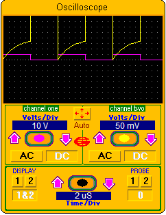

elt
  • Posts: 328
« Reply #37 on: September 20, 2008, 09:09:42 AM »
Hi Scott,
I think we're looking at apples and oranges... er, coils vs. FETs. My toy-ish simulator only gives me a virtual DVM and virtual oscilloscope for analysis. Yes, if I put the leads across the coil, then I get results similar to fig.3.
I thought that we were going to measure the voltage across the FET? As I understand fig.3, the FET voltage isn't shown.... The plots I posted simulate the standard boost circuit with the o-scope ground on ground, channel one on gate and channel two on drain.
The duty cycle in this sim was 50% and is seen by the square waveform in red. The voltage on the drain-source channel (yellow) is at 10v/div when the FET is turned off and shows a quick voltage spike to 50 volts or more that trails off until the voltage drops below battery volts (about 30v), then it slams down to input volts (about 17 volts).
The second image shows the voltage across the FET when it is turned on. Channel two is set to 50mv/div to show the detail during this phase. ( The voltage looks flat in the first image but it's not, it's just lost in the larger voltage scale.)
If I understood your instructions, I am to measure the FET voltage just before the FET is turned off, that would represent the approx 150mV shown on channel two in the second image.
If I understood your instructions, the volts measured just before the FET is turned off would be multiplied by the voltage across the cap. Power = Vcap * Vfet/Rdson but R is constant for purposes of relative comparison so forget about it. Is that right?

scottsAI
  • Posts: 884
« Reply #38 on: September 20, 2008, 09:04:18 PM »
Hi Elt,
We are on the same page! Some clarifications:
I assume Vcap is the capacitor on the Solar Panels side?
Power = Vcap * (Vfet/Rdson) / 2, correct for the panel side.
Inductor Current is a ramp must Divide by 2 for the average current:-)
As the panel is loaded Vcap will change (a lot), therefore power is dependent on it.
As you state Rdson cycle by cycle is the same (dependent on temperature)
The energy in the inductor is the same for the charging and discharging equations:
Power = Vbat * (Vfet/Rdson) / 2 (if discharging current is a ramp)
Since Vbat is constant only need to max Vfet to Max power!
If discharging is not ramp not sure if valid comparison? Need to think about this.
Time PWM cycle to keep some current in the inductor at the end of the cycle to get ramp.
(As long as the load side conditions remain the same, expect OK to let current go to zero.)
Then comparisons of peak currents are representative of more energy = more power.
Power transfer with inductor current going to zero requires larger Peaks currents to get the same average. 4 = 8/2, if current goes from 2 to 6 = 4 same average current.
Peak currents are the root of most problems in a switcher.
Timing the length of inductor output is more difficult than measuring Vfet once.
