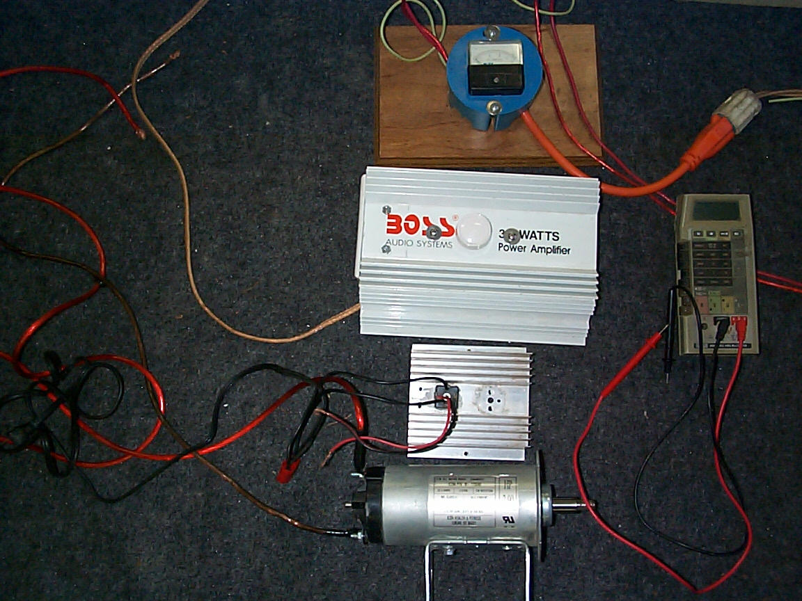

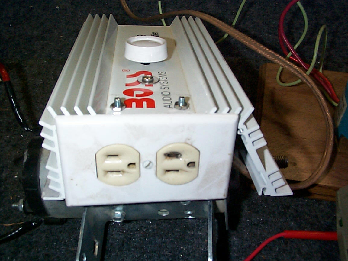

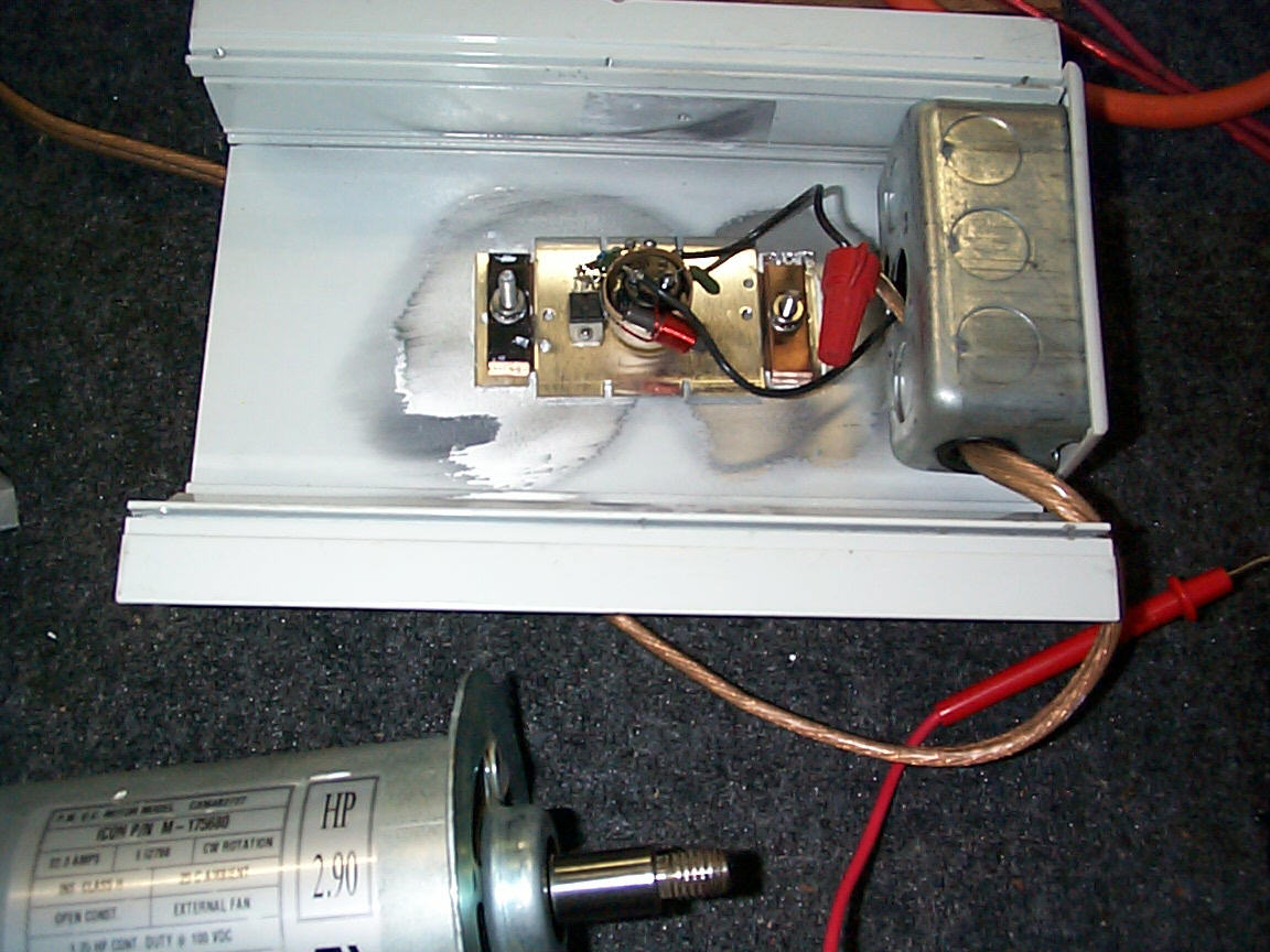

Hi Henry.
I posted a story some time back on this subject. I use tredmill motors as a drive motor for motor conversion tests. I had looked at the Harbor Freight router speed control ($10 to #15?). I took the HF apart and part for part it was identical to my lite dimmer.
Next I took an old car amplifier heatsink and mounted the dimmer to it with some heatsink compound. I added an AC receptical at the end of the heatsink.
The output is fed to a fullwave bridge rectifier then the DC is off to the tredmill motor. Since the RPM on the tredmill motor is 6,000 tops, I used a small belt pully on it and a large belt pully on the motor conversion.
I also used my Lazer Tack to take rpm readings, Fluke true rms for voltage reading and an amp meter.
I tried the big caps but that didn't work well. Go without the big cap.
If you would like to use my complete setup just e-mail me or call or come buy the store. The hole things been setting on a shelf for a year now.
Heres a few pictures. I hope they're not to big? Please forgive if they are?
With the added heat sink this controller works very well. I had no heat problrems  at all.

As I read it you did exactly what I was talking about. AC to dimmer to rectifier to motor and it works fine. Excellent. Looked like one leg of the dimmer output went to the rectifier, one directly to the motor. Or do both legs go to separate rectifiers? My drive motor at 1/2 HP is on the small size but has the big advantage of a generator tachometer attached to it. I just read the voltage (X 20) to get the RPM.

Hi Henry.
Just wire the dectifier as though it was the lite. then send its DC output to the motor.
