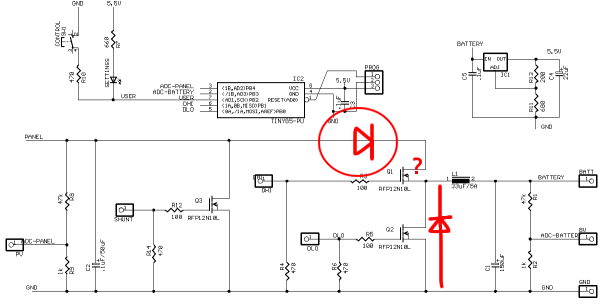

I'm having a hard time finding practical info on buck converters.
I've draw what seems to me to be a basic synchronous buck converter but I am confused on a few points.
The high and low side FETs for conversion are on the right. Since I want this to be a charge regulator as well, I've put a FET on the left to short the panel when the batteries are charged.
The micro has complementary PWM outputs with dead band timing generation to make sure that both FETs are synchronized; this seems to be a requirement but I haven't found anything that tells me how long the dead band should be? I think I can do multiples of about 20 nanoseconds. I'm guessing that I need a deadband that insures that the turn-off delay and turn-off time finishes before the turn-on delay finishes plus, perhaps, a little bit more for safety?
If I read correctly, I can use either a P-channel or N-channel FET on the high side. Right now I have it drawn as a N-FET but I've noticed that shorting the panel shorts the battery too. I can throw a diode up top but that seems like wasting power.
I've never used a P-FET in my life but it seems to be the opposite of an N-FET and I'd need to change the pull-down on the gate to a pull-up?
I'd like to handle an input of 4 amps and 100v; 100v so that it can handle the Voc of four 12 volt panels. I'm hard pressed to find a logic level P-FET that can meet those specs. But does it have to? ... Isn't the max voltage across the high side Voc - Vbattery? It might be easier looking for a 80 volt part. I can do the math of loss across a diode's Vf vs. a P-FETs Rdson and realize that the P-FET is only a marginal winner over an N-FET and diode. (That assumes that I really can use and N-channel FET on the high side?)
Hm... I think the issue goes away with a diversion load instead of shorting the panel but I'd like the option of not using a diversion load.
Occasionally, I've seen a schottky diode inserted across the low-side FET without explanation. Is that a snubber or is it part of the rectification? ... it just seems a little strange to me since I put the FET on the low side just to get rid of diode in exactly that position!
Comments, help and pointers are greatly appreciated!

Try not to use a P channel fet if you are concerned with efficiency. Usually P channel mosfets have very high Rds(on) and will drastically reduce efficiency.
To properly use an N channel mosfet with a floating source pin, you need a high side fet driver. Something like the ir21834. You need proper driver for the high side because you wont be able to fully turn off that fet once its on because the source pin voltage is simply floating, and you know that to turn off a N channel  mosfet you need to be at 0 volts (or below) in the gate with respect to its source pin. This IC will take care of all that for you (including dead time)
Dead time in this circuit would be used to prevent both mosfets to conduct at once. You only need enough time to let the mosfets fully open the circuit before the other mosfet starts to close.
This is very dependent on the mosfets characteristics. Check out the datasheet and look for fall time and set your deadtime on the driver IC to something a little bit higher than that value. This should be in the order of 100ns on so so mosfets. Much larger on IGBTs because of the tail off current. Also check to see the reverse recovery time of your mosfet's body diode. And pick that to be as low as possible.
Many times during a switching cycle the body diode will be forward biased. Your dead time should also be enough to let that diode recover and loose its charge or it will just conduct current to ground while your high side fet is turning on. And this will also lower your efficiency, or in very bad case, destroy the body diode.
There are less chances of that happening if you put that red diode across your mosfet's drain and source. but make sure its fast, fast.

Once you get away from play level voltages and currents you have to sort out your fet driving. Driving from logic level may be possible but I can't do it ( neither do I want to but that is for another reason).
You need proper high side and low side mosfet drivers. I am not sure that going synchronous is really worth the trouble at 12v and at 24 I certainly wouldn't bother.
If you use dedicated synchronous driver chips they will be intelligent enough to sort out the dead band. Doing it your way you will need to use more deadband than theoretically necessary and you will need the fast diode in parallel that you describe to control thing in the region where you have got things wrong. You will be partly synchronous and the gain compared with a Schottky diode at 12v will not be great.
P channel fets are best avoided, they virtually don't exist in higher power circuits.
Once you start using dedicated drivers there is no need for them. High side driving is a pain but up to 60v there are plenty of synchronous chips available. When you get near 100v there may still be some chips available but you are getting close to the point where you have to start stringing your own high high and low side drivers together.
Having sorted the driving you need to tame your layout to keep inductive loops as small as possible, you are not going to get power circuits to work on a rat's nest with high impedance drives from logic. Plenty of theory on the internet but precious little useful advice.

Most controllers open circuit the panel, some short circuit it. I don't think it matters much which way you go.
Open circuiting it with a mosfet needs a high side driver, shorting it wouldn't but I see no need for either in this case. The buck converter should phase back far enough to keep you below charging volts without need for additional mosfets.

I know this is teaching my grand-mater to suck ova, but of course you can do the controller all low-side N-channel like my cheap Morningstar SHS-6 http://www.morningstarcorp.com/products/SHS/ but the -ve side of everything cannot be grounded, it doesn't meet at least US codes AFAIK, and thus isn't even sold in the US and Canada.
Thanks everyone!
I really appreciate pointing me in the right directions. I know that this project is at toy power levels but I hope this will be a learning exercise for putting a big buck converter on the wind mill... so I really want to get things right!
I've googled synchronous drivers and have an idea, more or less, what they are doing. Seeing that, I've put two FETs into my toy-quality simulator and, using a much higher voltage to drive the high side FET, I get it to turn on and off. And seeing it turn off, sure enough, I see that I don't need to short the panel to keep it from charging the battery bank. (I often write that I'm not an EE but I'll bet that no one reading this post ever thought that I was...)
I see something else playing with the low side FET: I have to be precise with the off time... if I leave the low side FET on then the battery will discharge though it. I'll need to be very careful with the control that I don't melt the low side FET.
I did find a 100v driver with 5v inputs: LTC4444-5.
Most drivers I've found want more than 5v. But I also found this cool voltage regulator and gate driver combo, TD220. If I get one of the one-input kind of synchronous drivers then it will make a nice high voltage gate drive signal right in the v-reg package. Somewhere I saw a one-input driver chip with an automatic inhibit if the duty cycle gets too short... it looks like a three chip solution for the wind mill control circuit but I think I'll get a LTC4444-5 for this solar panel circuit ... as always, I appreciate comments, especially folks telling me if I'm totally off base!
