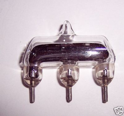

Madscientist267
  • Posts: 1181
Re: Very special switch
« Reply #5 on: December 17, 2008, 09:45:09 PM »
Thats exactly what I need. The only way it would be better is if they were dual tubes, already tied together by design as a DPDT!
Missile silos and mercury switches... there truly isn't anything you can't buy on ebay is there?!
I appreciate the feedback! Zap is gonna hook me up with a couple that he has around the house. Staring hard at the ebay deal tho... maybe for a future version...
Steve

Madscientist267
  • Posts: 1181
Gotum: Very special switch(es)
« Reply #6 on: December 23, 2008, 07:26:56 PM »
Got the 3 switches from the ebay deal today (Thanks MethanolCat for the tip!). Let the building begin! Between waiting for shipping, and no usable sun for over a week, this whole thing has been on hold more or less.
Theres a snafu; unlike their thermostat cousins, they are make before break. This is going to be a bit of a challenge to overcome, but I'm gonna see what I can do. Probably going to need a combination of mechanical vs electrical. Flop 'em quick to make switching as fast as possible, and a small amount of resistance inline to keep Isc down to just below magic smoke levels for the duration of the shorting that does occur.
Delicate balance; too much ballast would defeat the entire purpose of using mechanical contacts... We will see what happens, wont we...
On a less technical note, they're pretty - apparently never been used. No solder on the massive (14ga?) terminals and the blobs are flawless. Almost seems a shame to even use them, considering that they are so difficult to come by these days... :(
Yes, I got lazy and swiped the pic from the auction page. Hope nobody minds...
Steve
