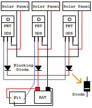

  • Moderator
Re: Why shorting?
« Reply #9 on: December 27, 2008, 07:58:27 PM »
Yes.  What Fungus said.
Take my "ghurd controller", put the power fet on the solar side of the diode. Done.
There are quite a few people doing it that way.  At least one member posted a story.
The diode loss is of no concern for systems without MPPT.
I do understand you think bigger.
Here is one of my world famous MS Paint sketches made for us Regular Joe's.
Easier than it sounds.
