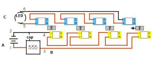

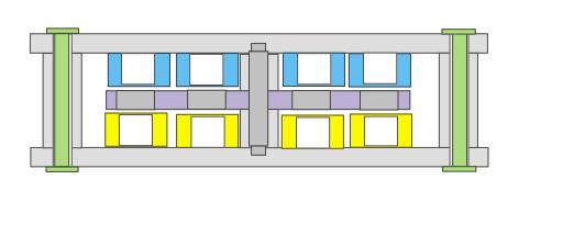

This is a prototype test platform. The idea is to see if it's possible to extract the energy of permanent magnets for a useful purpose. Not that this hasn't ever been done. In this case, the useful purpose will be to spin a disc and generate some electricity simultaneously, then compare the electricity generated against the electricity used and obtain an effeciency factor.
The induction coils are about 50 turns of 20 AWG magnet wire. Eight are used for the motor and eight for the generator, sandwiching eight 1/2 diameter by 1/4 thick neo magnets. Power to the motor section is supplied with four AA batteries through a 555 chip set up to pulse. Two potentiometers are used to control the pulse rate and duration. The coils are connected in series top and bottom.
Here is a side view of the machine, which is machined plexiglas.
And here is the plan.

I don't know exactly what is happening, but here are the readings I get with the multimeter.
Power on.
At 1,2 the volts are 5.2 and ohms here are 13,700; Amps .0038
At 3,4 the volts are .62 DC .378 mV AC and ohms here are 1.4 Hmmm. I don't know what is going on here at this time.
At 5,6 the volts are 0 and the ohms here are 1.4
Spin the disc up. I don't have a tach, but counting the ticks per second, leads me to think I'm getting something like 500 to 600 RPMs. That is a lot more than I thought, based on the 555 chip specs which indicate 3 Hz at .33 Duty. Anyway, the spinning disc reaches an equilibrium and doesn't vary much, despite manipulation of the 20k pots.
Power on, disc spinning at ~500 RPM
At 1.2 the volts are 5.2; Amps .0038
At 3.4 the volts are 1.3; Amps .99
At 5,6 the volts are 1.09; Amps .78
This goes on for 9 hours but voltage tails off at 1,2. Finally I think it used 8000 mAhrs and generated 7007 mAhrs. 88% effecient it looks like to me.
But I'm pretty new at this and circuit analysis is pretty baffling sometimes.

I suggest you beg, borrow, or buy an oscilloscope.  There are too many potential spurious effects that can be happening to rely on the multimeter readings.  The scope should allow you to "see" what is happening, as long as the device spins at a constant rate.  So far it doesn't look like anything strange is happening.  Keep in mind that you are going to get inductance effects from the coils.  Resistance values do not tell the whole story in this case.  I happen to be of the "no free lunch crowd".  That said, I would direct you to the various postings concerning "Over Unity" or the so called Bedini Motor.  You might check my posting concerning the same.  Have fun and enjoy the board.

The output from the chip is something like this:
The lower trace is from a capacitor connected across the chip.

I think that the motor section functions as a pulsed DC induction motor. That is, the chip pulse induces a magnetic field in the coils which draws the magnets to them. Then, when the pulse is off, the inductors pulse the circuit also drawing the magnets to them. That is the only explanation I have for the RPMs being higher than the pulse rate. That is, the motor device is pulsing once for each pulse delivered by the chip effectively doubling the RPMs I was expecting. That may mean it is spining nearer 360 RPM. I have ordered a tach to check this out. A choice between an oscilloscope and new drill press has the drill press winning hands down for now. Maybe when Permogator II is built I will have some use for the scope, since it will be an alternator version.
One thing I forgot to mention about the multimeter readings is, that while the current is obviously pulsed DC, the meter only reads the pulsed current as AC. There is statement in the meter manual that AC current reading on a DC bias should be divided by .707, but I don't know if that is the case here.
If this explanation is correct, then the inductor coils are pulsing current back through the circuit half the time. I wonder what this is doing to the chip and batteries?
As far as the output of the generator, that seems to be straightforward. It is pulsing DC current at the magnitude indicated on the meter, perhaps at twice again the frequency of the motor through the action of the magnets. Make sense?
And I don't disagree there is no free lunch, but this device is simply dependent on the attraction of the magnets to the coils, and is independent of the power input, since the chip controls the frequency of the attraction rate. This is in accordance with the chip specs. This unit will spin fiercely on one AA battery using a reed switch until it burns up, since it just tries to spin faster and faster.
It seems, if there were more coils on the stator, properly positioned against magnets on the rotor disc, and away from the motor coils and magnets, one might expect quite a bit more output with the same input scheme.

The lower trace shows the capacitor alternately being charged and discharged by the pulse train.  When a capacitor charges or discharges through a resistor the resulting time dependence is exponential.  That's what it shows.  As far as the voltmeter readings are concerned the .707 factor only applies to ac waveforms that are sine waves.  You don't have that.  That's why I suggested the oscilloscope.  I'd also like to point out that in switching circuits you can get voltage spikes that can be hard to spot even with a scope.  A scope will help you sort out all the different phenomena.
