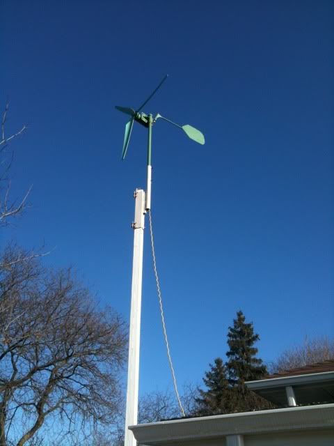

Here's my first attempt at wind 90 vdc motor 1 / 3 hpmax200W.

Yeah, zvizdic's machine is more like what I'm looking to do...

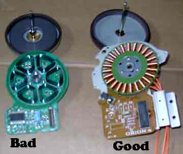

I got my start just taking stepper motors out of printers.  I cut some PVC blades, jammed them on the stepper shaft, and instant wind turbine.
I still use one of those as my anemometer.  Tidied up the wiring and made a durable mount for it and so on but that's details that go with any wind turbine.
Somewhere in my old files I should have a picture of it, but I never remember how to find them (not without deleting this typing anyway).
You can only get a few watts from a stepper motor, but if it's only for the sake of experimenting, it's easy.

Best to go with a larger 3 phase version I take it, right?
And elaborate on 'few'... 5, 10, 50?
What about 5.25" floppy drive motors? I have one here... :)

If you are near Toronto Canada I would have given you spare blades. They are made of 8" PVC tube 32" long.
 I left them unloaded turning around 800 rpm no problem.

If the coils in your floppy drive are like an axial, then the drag from eddy currents in the metal mounting plate will eat up all the potential power.

Edit-  Fould a pic showing some details,
http://i701.photobucket.com/albums/ww20/ghurd1/Stray%20Pics/PICT0871.jpg
