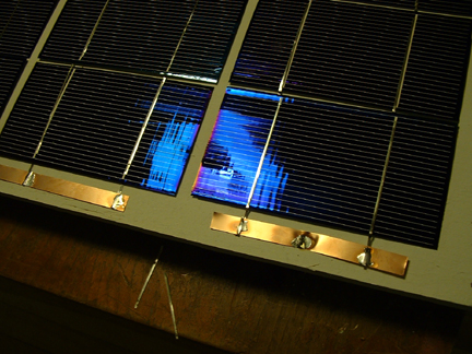

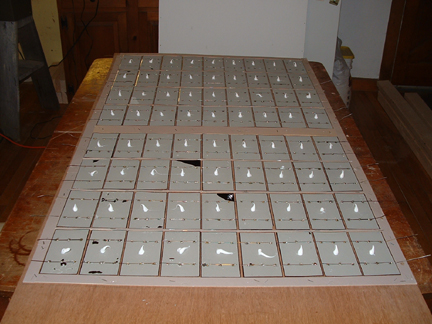

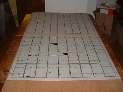

This shows the cells upside down in a jig made from strips of mat board stapled onto a piece of 1/4 inch plywood. At this point, the tabs can be soldered to the cells. I found a 30 watt iron to be the minimum acceptable and a low temperature solder to be the best.
Here the cells are all soldered and a dab of silicone caulk is placed on each one.

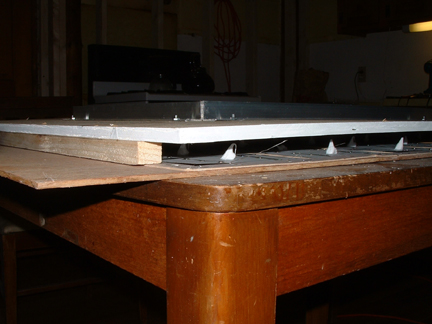

I used 1/2 inch plywood for my backing. It sits atop spacers as I align it with marks on my jig. When it is in the right position I remove the spacers and let it press into the silicone. You may be able to make out the 1 x 1 x 1/16 inch aluminum angle stock that's bolted to the upper face of the plywood. The angle stock is bent into an 'L' shape and two of them are set to form a rectangular shape and bolted down. The metal adds a great deal of stiffness to the plywood.

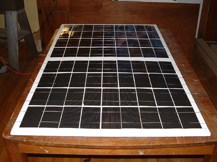

The next step is to flip the rig over. This can be tricky, but I find using two small C-clamps opposite each other holds the backing and the jig together just enough to let me flip it over without any of the cells moving on me. Here is the new panel with the jig removed.

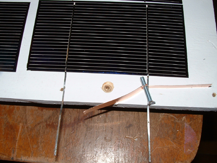

Power is brought to the back of the panel using bolts counter sunk into the plywood. The copper strip is .015 copper sheet purchased on-line and cut up into strips.
The terminal bolts are soldered to the copper strip to ensure a good connection. The copper is also used to string the rows of cells together at the ends.

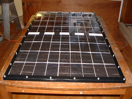

A double layer (total thickness about 1/4 inch) of foam tape pipe insulation (purchased at Home Depot) is layed around the perimeter of three sides and in spots across the middle and what will be the bottom edge of the panel. The space between the spots will allow ventilation.

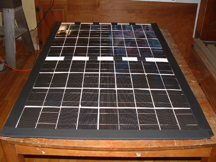

The finished panel has plexiglas screwed down into the foam tape every six inches. I used one inch metal roofing screws that have a rubber washer on them. There is also a layer of vinyl electrical tape (3M 88T) around three sides of the perimeter. This is experimental. I'm hoping the tape will protect the foam from UV radiation and make it last a little longer. It is important to predrill the screw holes in the plexiglas and plywood, and to do so on a solid surface. If you try to do it after the foam tape is in place, you will crack the plexiglas for sure.

This is an update to my original posting and a warning to any readers who wish to follow the same construction methods. Three years have passed since I built about 900 watts worth of panels using this method. A year ago all these panels were replaced with 1.65kw of panels manufactured by Photowatt.
The construction method shown here is flawed. The homemade panels start out working very well, but they succomb to moisture in the atmosphere, wind vibration, and expansion/contraction due to temperature differentials. Over time the silicon cells crack and electrical output drops severely, or even stops altogether. The soldered tabbing lifted off the front surface of the panels and I could not find a satisfactory way to clean the contacts after exposure to the elements so they could be resoldered.
Where soldering remained intact, the cells broke. I suspect the breakage was caused by different expansion rates of silicon and the metal tabbing.
There was also the autumn wind storm that cruelly finished me off. 85 mph gusts shook the fragile silicon cells to bits.
The only way to make a reliable long lasting panel in my opinion is to encapsulate the cells in plastic. That requires specialized equipment. If one must purchase glass and aluminum frame material, it turns out to be more economical to purchase manufactured panels. They are more reliable and they have a 20 year replacement warranty.
