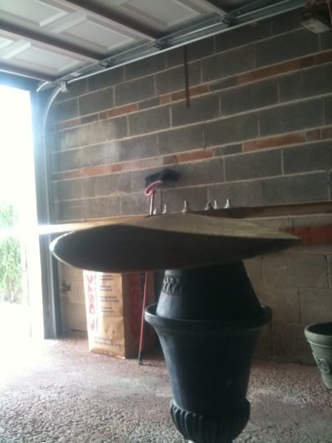

 Returning the favor for helping me with the blade profile of the 2.25"x 8" blade.
I tried making a blade from a 2x6 using a table saw and I would have to say that it will work. I spent about 2 hours sawing one blade, but once you have the saw set you should be able to make the cuts in all three blades, so it shouldn't take that much longer for all three.  Also, the saw fence has to be long enough and rigid enough for an accurate cut. And a sharp blade.
(Attachment Link)
 Here is the blade after shaping. I tried using a hand plane but that didn't work very good, so I put a sanding disk in my 4" Dewalt side grinder and it took just a few minutes to get it down to the rough shape. Tried breaking off some of the waste wood, but it broke below the saw cut.
(Attachment Link)
 This is the front of the blade. When I got close to the bottom of the saw cuts, I sprayed the blade with black paint so I could see how deep to grind with the side grinder. After that, you can just sand by hand until you remove the paint. I just sanded the end to see how the profile looks from the end. The black lines are from the paint in the bottom of the saw cuts.
(Attachment Link)
 This is the back side. A little trickery to grind because of the inward curve, but not impossible. I just carved this blade to see if it can be done. I think a 5 foot long blade should work too, if the fence is long enough on the table saw.
(Attachment Link)
 This is only a 3 foot blade using a pine board. Being that the blade is no good for anything, I will weight it down and see how many pounds I can hang on the end before it fails. I will post the results.
 I am still thinking of trying an 8 foot long blade, but that may be a winter project!

How did you remove the remaining wood in the first picture. I did not get that from your description (perhaps just overlooked it).
XXLRay,
 First picture, I used a table saw. Second picture , I used a Dewalt 4-1/2" Flap Disk (Model #DW8308) on a side grinder. They are available from 36 to 120 grit. I used the 60 grit and it really takes the wood off without any burning of the wood. I would also get the 120 grit for when you get down to the bottom of the saw cuts. You really have to take it easy using the 60 grit. Cost is about 8 or 9 dollars each.
Also, do it outside. It makes a mess in a shed. Fine sawdust over everything.

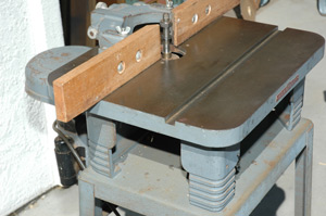

Just to make sure (as I am not a native speaker) - this is an angle grinder (like this: http://en.wikipedia.org/wiki/Angle_grinder), right?

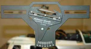

Since I'm going to try to make GOE222 blades, I ought to know what this "10 degree pitch" is of which many of you speak. I thought (in my ignorance?) that it referred to the angle at which the "centerline" of the profile differed from the plane of travel of the blades. I realize that, apparently, I don't even know which end is up. I guess I DO know which are the leading and trailing edges, but is it the convex or concave face of the blades that faces the wind? If the pitch isn't the same as the angle of attack, then I'm baffled. Moreover, now I doubt myself about which way the pitch/angle should "rotate" - leading edge windward or vice-versa...
The "convex" side goes downwind. (opposite of a driving propeller)  The leading (rounded) edge still goes upwind.  Pitch measurement needs to be defined with respect to a datum that varies depending on the airfoil. I don't know what datum is used to measure the 10' pitch with the GOE222 'foil.
With flat bottom, or cambered airfoils, it is convenient to measure with respect to a stick spanning the concave (or flat) surface, like this model airplane propeller pitch gauge does: http://static.rcgroups.net/forums/attachments/2/4/0/5/9/3/t2586007-238-thumb-prop%20pitch%20gauge_2.JPG?d=1245185240
It is trickier with symmetric or semi-symmetric airfoils, here is a pitch gauge used with model helicopter rotor blades: http://t1.gstatic.com/images?q=tbn:ANd9GcRyu4bIltz5Jp57jblAu9teqv0YcRLVfs8v_pa8LDpHfwhT8bdREQ&t=1 Note that the airfoil is held between V shaped jaws.

 So I asked a friend who does a lot of wood working...and he told about a wood shaper. Its seems that blank blades can be purchased for them, then milled to the shape you desire. I could see a shaper with two sets of blades cut out for the over and under profile of the 222.
 The table saw is a good plan for one set of blades, but I am thinking more about multiple sets of blades ( up to ten sets).
DF
Re: GOE222 /table saw??
« Reply #56 on: May 20, 2011, 11:38:25 PM »
"Shaper" was the 1st thing a freind of mine said too.
He has made custom shapes from blank blades several times, and he says it is not difficult.  Not sure how he did it, but he does not have access to a milling machine.  Probably did it with a die grinder?
1st thing I said was "Yea, that will work on the first side, but what about the Other side?"
He claims that is no problem either.  I don't recall his solution.

I build some modified GOE222's out of Douglas Fir 2 x 6's using the following hand tools - power planer to rough shape the blade, custom made draw knife to cut the face, belt sander to finish it, picnic table for a workbench, pine tree for shade, and Bud Lite to reduce the effects of the 90 degree weather:
This is actually for a four-blade rotor for an experimental 13 foot geared turbine that I'm building.  I have three blades finished, one to go.  The pitch is 9 degrees, and the chord is 5.55", for this four-blade setup.  I modified the GOE222 airfoil at the trailing edge to remove some of the "cup" on the face, which I think is partially responsible for making these blade refuse to back down when the machine is furled.
The following photo has a printed template of the GOE222 airfoil stapled over the end of the blade to show how I modified that trailing edge for less "cup"
My hope is that the modification will provide less drag and slightly less torque for the four-blade rotor, which will have plenty of torque anyway with four blades instead of three.
I'm just using these Douglas Fir blades for cores - they will be laid up with two layers of glass and carbon fiber.  Just using hand tools it takes me about 2-1/2 hours to build one blade.
I studied the GOE222 airfoil and compared it to flat-faced profiles like the NACA 4412 or Clark-Y and it's pretty much the same except for that trailing edge.  The trailing edge provides the effect of wing flaps on a Clark-Y - lots more lift, but also more drag.  My modified GOE222 has more of a concave face than the Clark-Y but no "wing flaps" in the breeze like the GOE222.  I'll report later on whether or not I get more power (kWh production) from the four-blade modified GOE222 setup vs the three-blade GOE222 on one of my geared machines.
Chris

As usual Chris, this is great work and we'll all be very interested to hear how itl works out with your profile. Being in the log home business as well as RE contractors often "cope" logs with a large table saw or hand saw blade running perpendicular to the work piece. Just taking off a very small amount each pass with a rip fence or jig works very well and could easily cut the concave face of his type of profile as well as the many other options previously mentioned. I'm sure your draw knife acts very much as a scraper with the blade of the tool having the curved profile. Not many have designed a machine for a particular profile like you have, seeing more of that kind of engineering for any profile could far exceed the "anything will work" performance most accepted by home brew machines.  Dave B.
