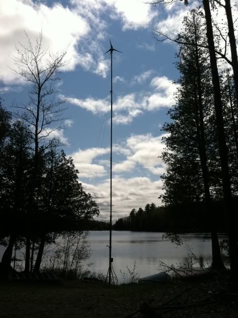

My camp is on the NE corner of a lake that is at one of the highest elevations around, and I'm near Lake Superior.  Very high wind area, sustained winds over 20 mph are pretty much the norm, it just never stops blowing.
Scott
  • Posts: 54
Re: Got 3 - 24v Air 403's free but my system is 12v, can it work?
« Reply #4 on: May 11, 2011, 05:27:24 PM »
My current state of affairs.  Here's what happens when a guy wire comes loose.
I'm bummed, that was a great tower, I could crank it up and down by myself.

Looks like you can mount a 403 fairly easily, I'd just mount it.
If you have a hornet style blades lying around (slightly larger than the 403's) , use em , but don't bother buying them if you don't.

I have the bigger blades on the ametek motor mill in the pic, but 1 broke when it fell.  I might be able to salvage them by shortening all three up a little as the one that broke was within a few inches of the tip.

These Air units really suck don't they?  I took a ride to my camp today and with 15 - 20 mph winds it did absolutely nothing!  It would spin a little in a good gust and I mean a little.  Even one of my ametek mills would've made power today.  It's coming back down this weekend and I'm putting one of my homebrews back up.  Mean while my batts are down to 11.75 with nothing charging them for the last 2 - 3 months.  Going to have to bring the generator out there to get them back up.  ARRGGGHHHHH!
Hey is Jerry still around here?  Does he still have the Jerry blades?  I used to run them on ametek mills.

I hate quoting myself, but I did warn ya :)
"I have it mounted upside down in the corner of the interior of my shed without the blades on it. Seems to works as well there as anywhere else."
You didn't think I was kidding did you?. I am sorry it isn't working for you, guess it sometimes takes more than just a poor area (my case) to get lousy results.

25 - 30 mph winds today and I have to say that thing was kickin!  Was pegging my 15 amp meter hard(need to upgrade to a 30 or better), so much so I put a jumper across it.  Winds tonight and tomorrow of 40 mph with gusts up to 60 they say!  My dump load heater may be getting a little warm.
I'll give this thing another chance since it's quite common to have these winds here and I really don't use the camp much and when I do I don't use much juice.
