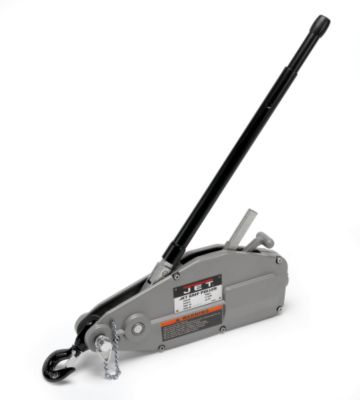

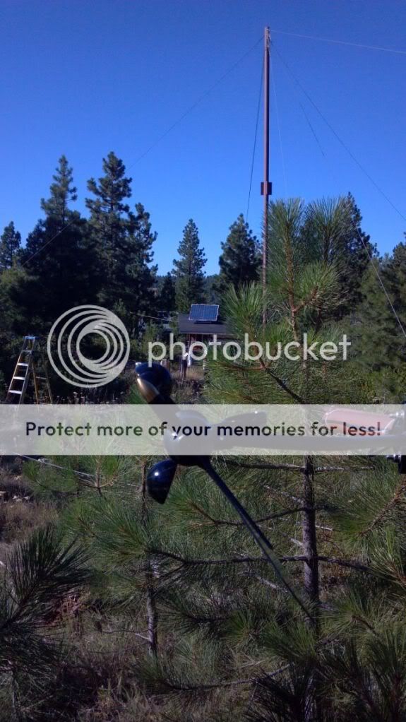

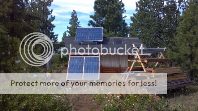

Six AM and I'd cranked the volume to hear those pedestrian comments when that bayou howl woke up the house.
Winches, the worm gear flavor is where its at - no/low chance of it running away backing off.
Any chances of more photos of the overall site? Something done that well deserves farming more of them up :)
Re: my first mill 8.5' servo
« Reply #6 on: June 29, 2011, 12:20:54 PM »
Quote
I used to think that...
I bagged one of these awhile back:
http://www.jettools.com/us/manufacturing/en/product.html?node=4596&product=272889
rated for 1500# and uses 5/16" cable or the metric equivalent.
I got mine online for a lot less than I see them listed for now.
It is a fine pulling machine very positive control and everything stops when you do. It comes with a 60 foot cable.
You can pull 15 miles of cable with it if you need to as it just moves the cable through the puller. Pumping one lever feeds in and  the other feeds out.
Bottom line is these work and work well.
Just FYI after several winching methods including spur gear winches, worm drive winches and the 4X4 pickup method.

Hi, very nice video. Can post any photos of the base of the mast? Congratulations on a safe install.

DanG- sorry the high volume and waking the family @ 6am.
i'm thinking of a worm drive winch.  grip pulls interest me as well.  wondering which one is faster.
tom- do you direct grip pull your tower(s) up or run the pull line through a pulley?  how much effort is involved in the back forth action?

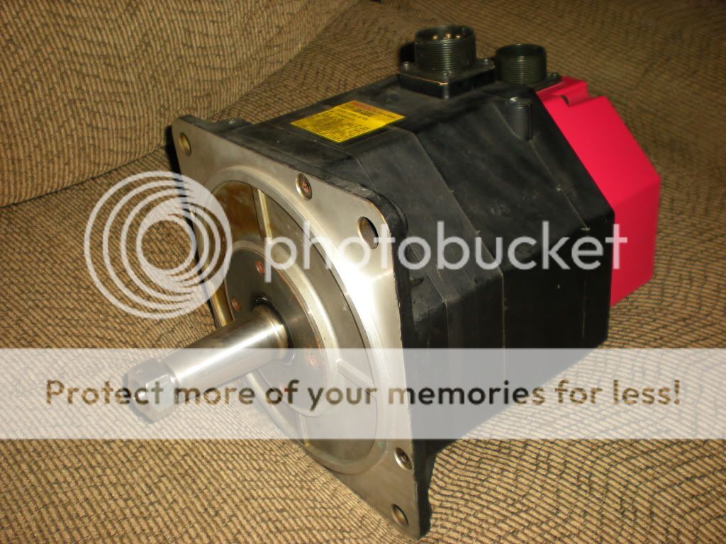

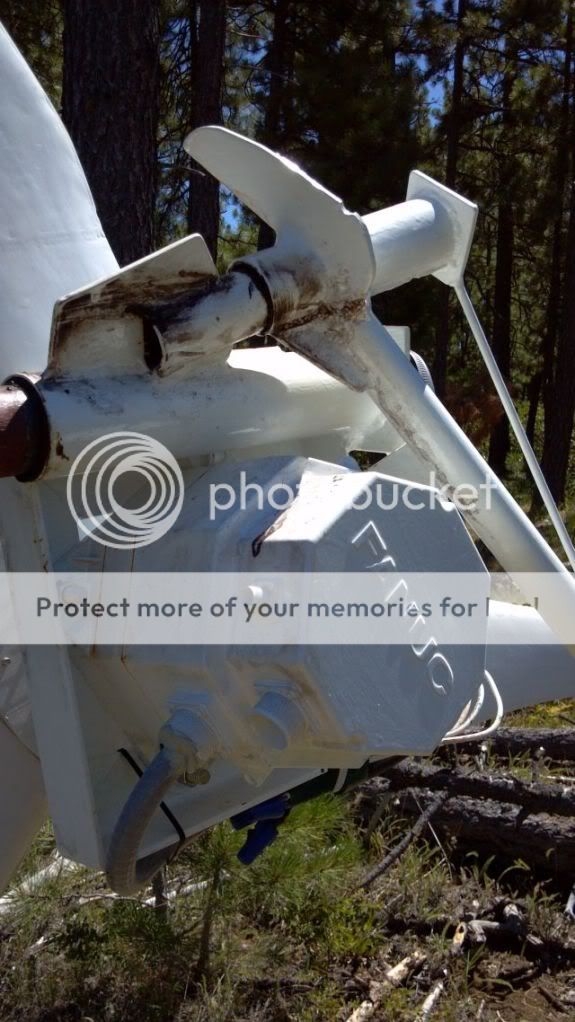

the motor  Fanuc A-06 series
the motor innerds

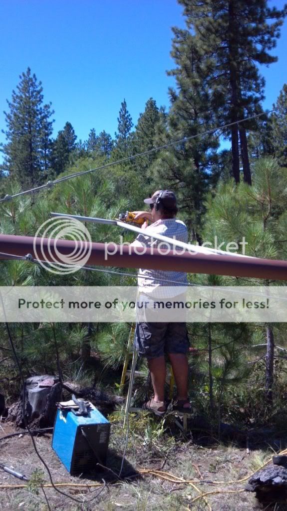

fiberglass on blades

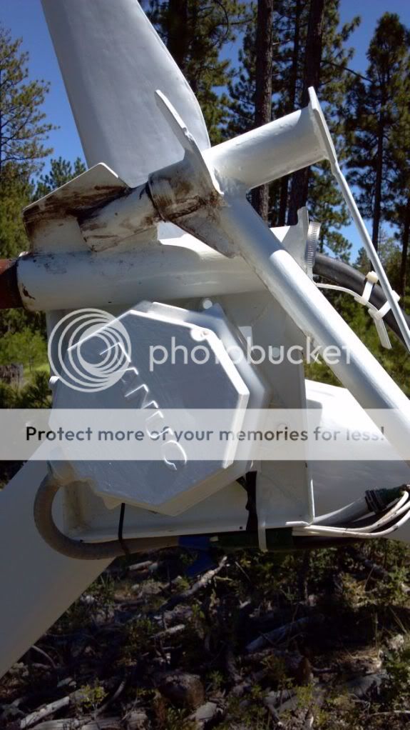

tower base
there all you go!  enjoy! and bring on any criticism...  though there are parts incomplete.  no j-box, tower needs paint, better cable support needed, winches needed.

birdhouse;
I have done both ways. Single straight pull and pulley reduction pull. I much prefer the 2:1 advantage pulling if the cable is long enough.
Not too difficult to operate and one cycle of the pulling lever pulls about 1.5 to 2 inches of cable.
I doubt it takes even 50# of pressure to operate the handle to start my 12 footer up from horizontal with a 40 foot mast and 18 foot gin pole and straight pull with no reduction.
it was considerably more difficult with the worm drive I had used.

tom-
thanks for the info on the grip pullers.  seems people who have been at this a while prefer these type for lifting towers.  there must be some merit to that, but by golly they aren't cheap!  on the specs they list about 10 foot per minute.  with my 2:1 and around 100 foot of pull line, that would put me raised in around ten minutes.  i also wonder if you have to crank like a meth head trying to break into a pharmacy to get the 10' per minute...   :D
adam
Adam;
Without setting it up for actual tests:
I make it about a second per cycle of the handle and roughly 2" of cable through per cycle. So a minute would be 60 strokes and 120 inches a minute or roughly 10 feet.
All questimates but well within the ballpark.
I couldn't "crank like a meth head" if my life depended on it  It is quite pleasant / easy to use.
One downside is if you hook the pull cable directly to the gin pole rather than through a fixed pulley on the anchor it tends to bounce from pumping it. This goes away if you run it anchor >>>>puller>>>>sheave>>>>gin pole. If that makes sense.

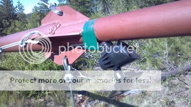

less clearance than i'd like.  i think it is around 8 inches.  the blades are made from laminated clear fir, and are pretty thick until about the halfway point, and they've got a layer of fiberglass on them.  hopefully all of these things keeps the flexing to a minimum, thus eliminating a tower strike!  (crossing fingers)  i could always stack a few washers between different parts of the motor and frame to tilt the whole blade set back a little more to gain some more clearance...
If it was mine, I would sleep better with those washers installed.

G-  yea, i'll do that next time up weekend after the 4th. then, i'll be able to give a positive blade clearance measurement.   i'm almost losing more sleep over the fact that it's shorted, yet not connected to a battery bank right now.  just checked the ten-day wind forecast for up there, and 17mph is the highest.  i think it can handle that.

mill- has a 6" offset (ctr of blades to ctr of tower) for a 102" blade diameter, roughly following the 4-6% rule.  i went with 6% because i figure it's much easier to add weight to the tail.
furling- followed hugh's book to the "t" if i understood it correctly   :)
incorporated- a 3% upward tilt on blade mounting to increase tower to blade distance.
motor- fanuc A06B-0355-B755.  3-PHASE 2000RPM  140V  20A  23Nm(stall)  8POLE  blt-1997
blade mounting- double stainless round disks 12" x 3/16" sandwiching blades.  these mount to a solid block of round ALU that matches the motor's taper shaft.  bolted and shear pins.     (the one part i didn't make)
blades-  8 pieces of clear fir laminated in a 2pc x 4pc config with offset joints.  roughed out with a chainsaw thanks to Oztules!  angle grinder with flapwheel to finish rough out, and sanded.  one layer of 6oz fiberglass on outer 2/3's wetted with west system.  then two more layer of west to get good build-up and fill divits. (small batches with filler).  3 coats of 2-part epoxy paint, then a final rattlecan for uv.

That looks like neat work, just two observations in the video once the tower was up and you were connecting the turnbuckle there seemed to be nothing holding it up from the pull up direction.
When you get to mounting a heavier turbine on top of that tower just remember that when raising and lowering there can be a tendency for the tower to fold over if one does not take a strain on the mid point from the opposite side to the gin pole.

Allan-
two very good safety points!  a very simple clip on leash should solve the first potential issue.  if a gust came from the gin pole side, it could create enough force to put the whole thing over!
from what i've read about needing "back pressure" on the middle portions of a tower applies only to taller towers that get a little more "noodlie" as they go up.  i would like to add a back-haul winch to let the tower into it's final home, so it could double as the back pressure to mitigate tower buckling as well!
thanks for the insight!
