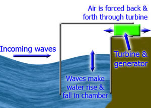

There has been done a lot of research on wave power over the years and what happens is that people underestimate the shear power of a storm with the constant bashing of waves. Resulting in a wrecked structure. I've seen huge boulders been thrown over a concrete pier from the power of waves.
This is (as far as I know) the only concept that works because you can keep the mechanical parts out of the water.
Nice - Now THAT'S an implementation that would work fairly well. If you make sure your intake is huge (several feet around) and several feet deep in the water at low tide to make sure the air is properly preasurized and taper it off to a very long & narrower, high-pressure tubing system, you could probably get some serious power out of it! It would work even better if you made rubber valves so air only came in in one direction and only came out in the other and both the intake and outtake worked with the turbine to turn it the same direction.
I wonder what the efficiency would be though since air is fairly compressible though.

Being inland and a landlubber is this last idea essentially a "blow hole" that you capture air flow in and out to drive a turbine?
*Points to nose*
You could get some serious pressures too. The larger the size of the intake in relation to the size of the air feed hose to the turbine, the higher your resulting PSI and the more your blowhole blows!
I think they use "wells turbines" that rotates the same way independent on direction of airflow.
http://en.wikipedia.org/wiki/Wells_turbine
CaptainPatent
  • Posts: 27
Re: Coastal Wind Characteristics
« Reply #31 on: December 12, 2011, 03:41:49 PM »
Hmm, interesting. I hadn't heard of a Wells Turbine until now. I'm having a little trouble wrapping my mind around the aerodynamics, but it looks like it's a drag-only device at startup and then the apparent pitch of the moving device gives it additional lift. Very cool and interesting.
