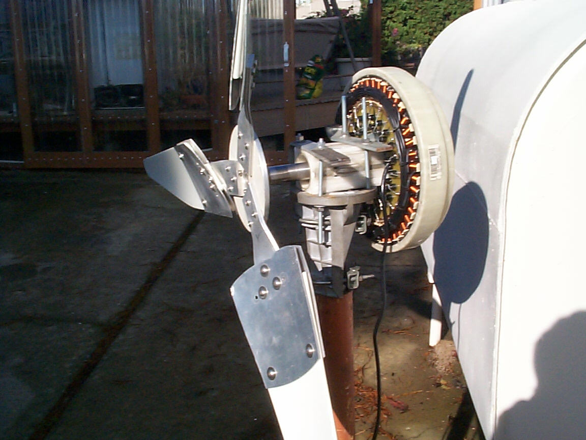

Not sure the salient pole unit pictured is helpful in this case, but these are.
From two different people:
Give you an idea of what the finished and part built thing will look like.
................oztules
