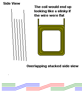

If flat wire were used the coil could look something like a slinky with as many rows both width wise as well as height wise.

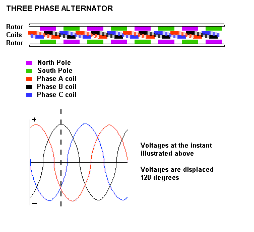

To make the best use of your magnet's flux, consider a three phase winding with lapped coils.
The sketch below is a "flattened out", "edge-on" view.

Probably right, too much trouble. Well just one more image I had. Thin Sides up like a tape.

To make the best use of your magnet's flux, consider a three phase winding with lapped coils.<p>
The sketch below is a "flattened out", "edge-on" view.<p>
Electric Ed<p>
Very interesting.
PRO's:
1) A higher density of coils allows for a smaller diameter stator. You can fit two "over-lapped" coils into the same space as 3 "side-by-side" coils.
2) A smaller diameter & lighter rotor, too - easier to start spinning?
3) The smaller diameter stator and rotor can reduce weight and cost
CON:
1) A thicker stator means a larger gap means lower magnetic field strength? - Is that BEST USE or worse use of the magnetic field?
2) The stator would be thicker which increases weight and costs.
Is the magnet count significantly lower?
Side-By-Side Coils:
3 Phases x 4 coils per phase = 12 Coils
Ratio = 3 Coils to 4 Magnets
Requires 16 Magnet pairs
Over-Lapped Coils:
Ratio = 3 Coils to 2 Magnets
Requires 8 Magnet pairs - BEST USE?
Only 1/2 the number of magnets?
Do I have that correct?
Will the proximity of the three over-lapped coils cause the magnetic forces from coils to affect the performance of the two adjacent coils?
