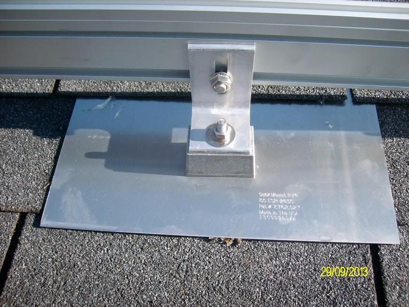

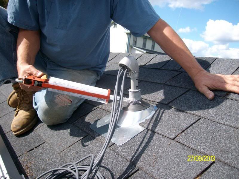

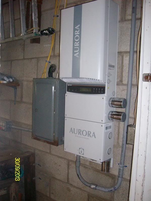

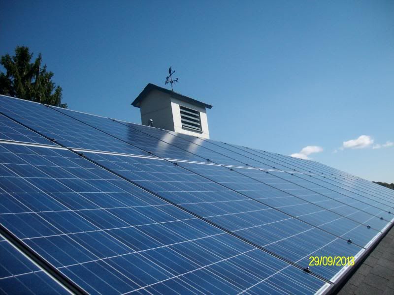

I'm happy. For a 6 Kw system (actually 6.8 Kw in panels but the inverter is only 6 Kw so the system is rated 6Kw,) I came in at just under 14 grand. Now I did install it myself with a friend who is an electrician who I did paid 1300 bucks so there's a savings there.
Rob Beckers designed and engineered the system so all the hard parts were already figured out.
Anyway, I think that this is helping me set up my road to retirment. (We'll see) LOL!!!!!!
We went with "Canadian solar panels" because the warrentee is through in independent insurance company so if they should go under, they are still insured.
The "Quick Mount" flashing cost a bit more but at age 60, I don't need the agravation of any water leaks. The Rails are made by "Iron Ridge".
A little "Whether Head" got us through the roof.
The 6Kw Power One inverter. Notice the 2 DC lightning arrestors on the right side and AC arestor on the bottom.
