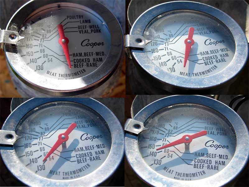

After seeing the simplicity of Olsen's design and reading other material where cans arent punched and utiliized, I decided to take a go at it.
I had an old window, and the front of a computer/server rack which is metallic and has a nice honeycomb perforated pattern to it.
I routed a channel for the glass and rabbited the rear to hold insulation and backing material.  I painted it all back with high temp paint, stacked cans sideways along the side and held them in place with black mesh screening material.  Note: the air does NOT flow through the cans, just across.
I had to cut the metal door down to fit the box.
The air MUST flow through the mesh and the tower door to exhaust.
I built a window unit to place in the sill for easy removal.  The ductwork between the window and the heater will surely get cold in the winter, so  I'll need to insulate some more.  A thermostat controlls the fan.  I need to clean up my wiring a bit, but it's just a test.
And a few readings after sitting in the sun about 20 minutes...

One thing you might do is put a little paper type flap on the exhaust so the air from the warm room doesn't flow backwards.
BTW: I like my beef medium ;D

Haha! I won't be cooking any meat on it, but if I do I'd assume you want ribs, St. Louis style?   :P
Thanks for the input... I had my fan sucking air out of the box for testing but since then I've reversed air flow and a created makeshift backdraft damper.
