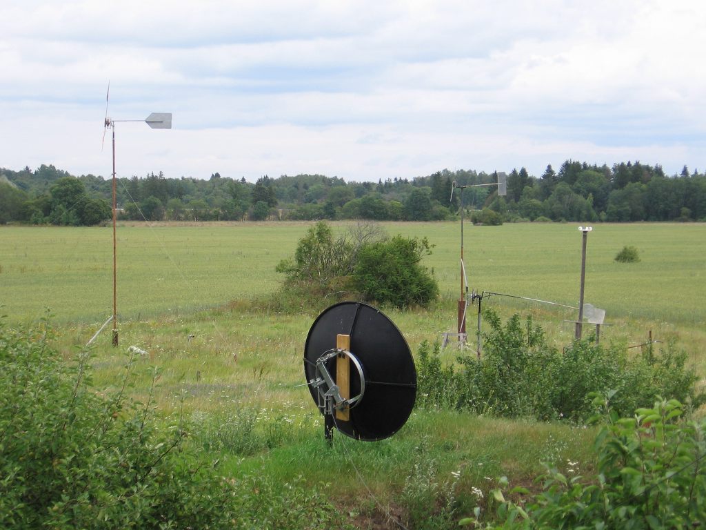

Greetings from Estonia.

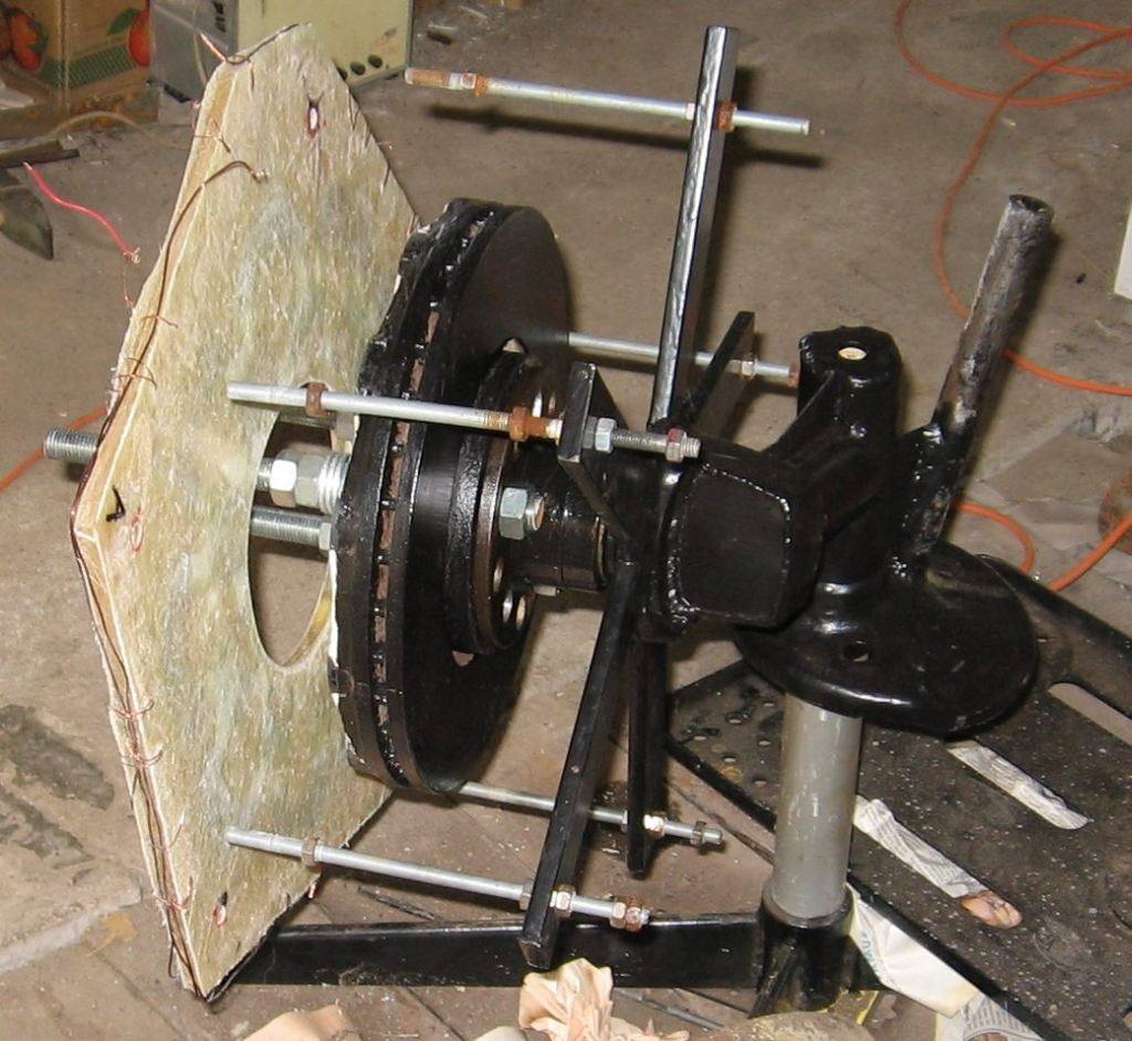

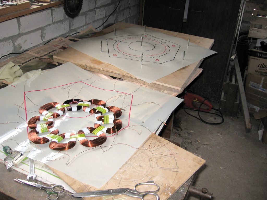

This story is about making something usable from scrap.

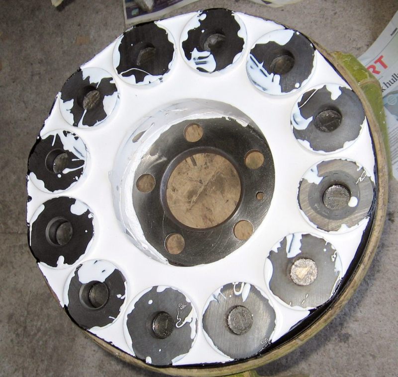

First I made magnet rotors from old microwaves and used car disc brakes.
More than 12 microwawes needed because all magnets are not same size.

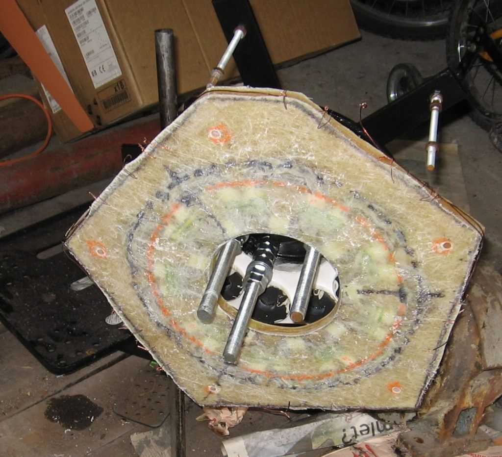

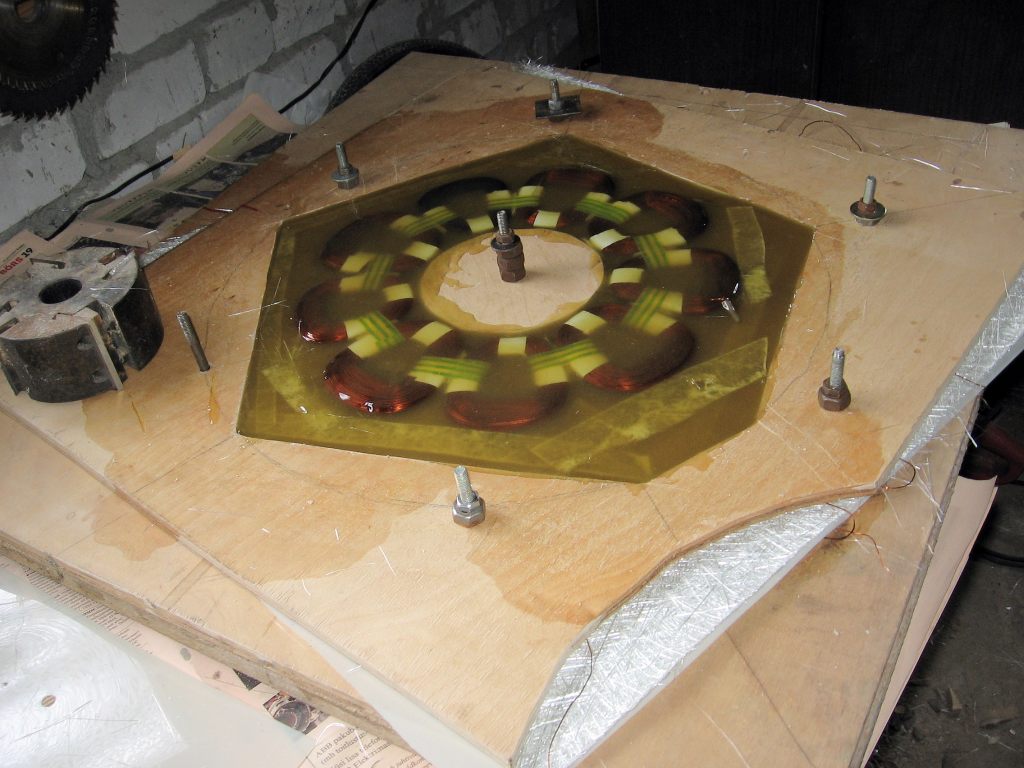

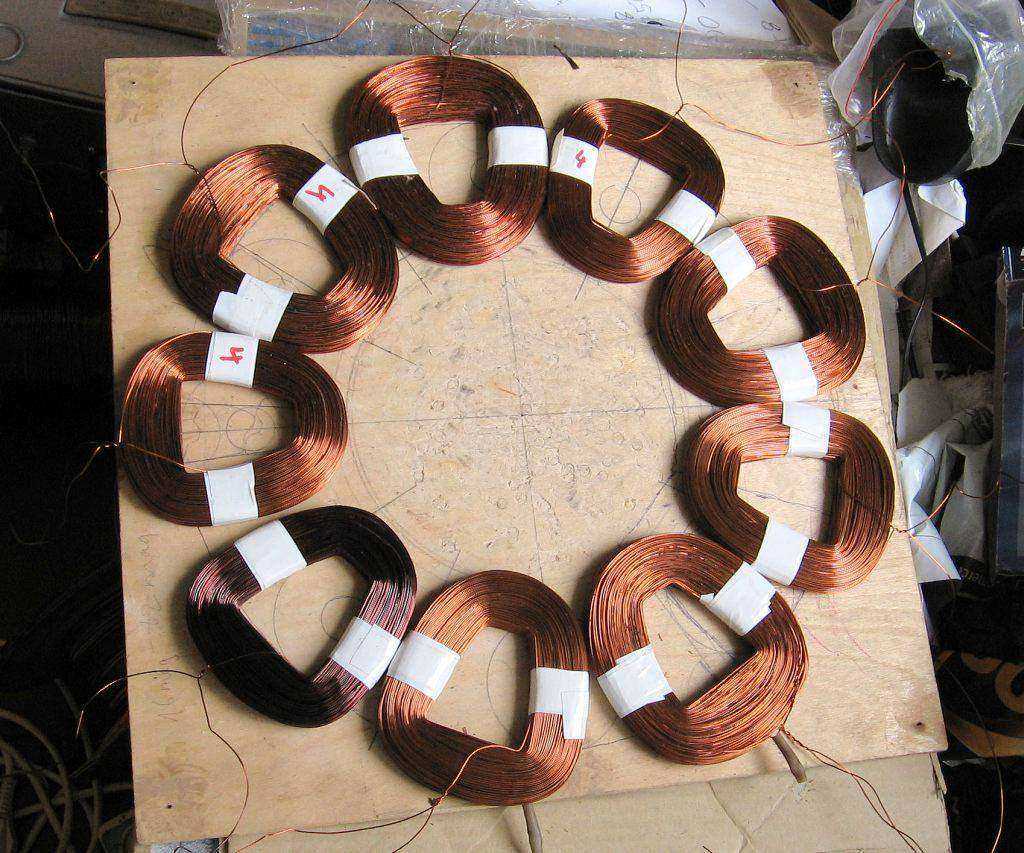

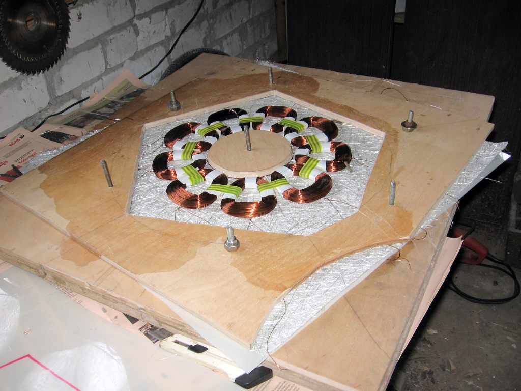

Second - I made 3 phase stator from used magnet wire. That's why all windings isn't same size (old lacquer issue). 0.6 mm wire diametre and 400 w every winding. This must give out HIGH voltage. But not, because microwawe magnets are quite weak.
This combination of almost 3 kg. free copper has complete circuit. Definetely not optimal. That's why I left all wire ends outside for future possibilities.
No need to make new mold.
Here it goes.
Next day it looks like this:

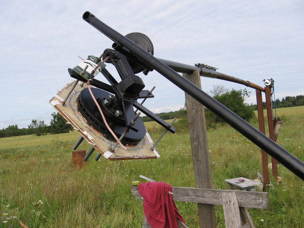

One good friend helped me with weldings. I am not so good on it.
Here it is on test stand. Of couse it's working. Only with one rotor I measured 50V maximum speed (900rpm) cordless drill and 80V two rotors connected open circuit. Cordless drill was too weak for measuring shorted circuit current, more than 1A seen.
On last picture You can see new polar mount stand on my basement roof. Temporary satellite dish installed on it for perfect aligning. In future solar panels or solar consentrator will sit on it.
But it was good for watching unusual satellites too. 90E YAMAL is most east satellite we can see. Pitch angle 1 degree, almost parallel to earth surfice. I was able to see Russian channels from Vladivastok - time difference 8 houres. Always first morning news on this channel when I went to bed.

 A few have used doughnut magnets .It's very cool to get power from used stuff like that . It's hard to get the wire off clean and have the insulation good . I've been able to use polyurethane with some success . You can increase your  power by adding a neo in the hole the same polarity as the doughnut face . An oposite pole is present in the hole that messes with the peak charge times . Those look like between 12 and 19 mm either will do with some super glue and epoxie .

I have more than 100 used computer hard discs waiting for disassemling and making next generator. It means more trouble than disassembling 12 microwawe owens.
Read my older diary about single phase machine using wery old computer scasi drive magnets. Definately Neodynamium magnets are much better, I noticed it when I was not able to separate this double rotor machine without tools.
This microwawe maget machine is double rotor machine too. Only pictures here taken from early stadium.
I was able to separate second magnet rotor from machine by two hands. Of course stator thichness was same, same mold used.
I had same idea to make weak microwawe magnets stronger by adding additional neodynamium magnets to ferrite magnet hole.
But I read from this forum that Neodynamium magnet can kill Ferrite magnet soon.
And I was afraid and let holes empty.
Is it true?

It won't be a problem you have to surround the magnet for a weakening you reallydon't need much just hide that pole in the middle maybe a harddrive mag or a piece of one on a 12mm ferrite button or cut washers.

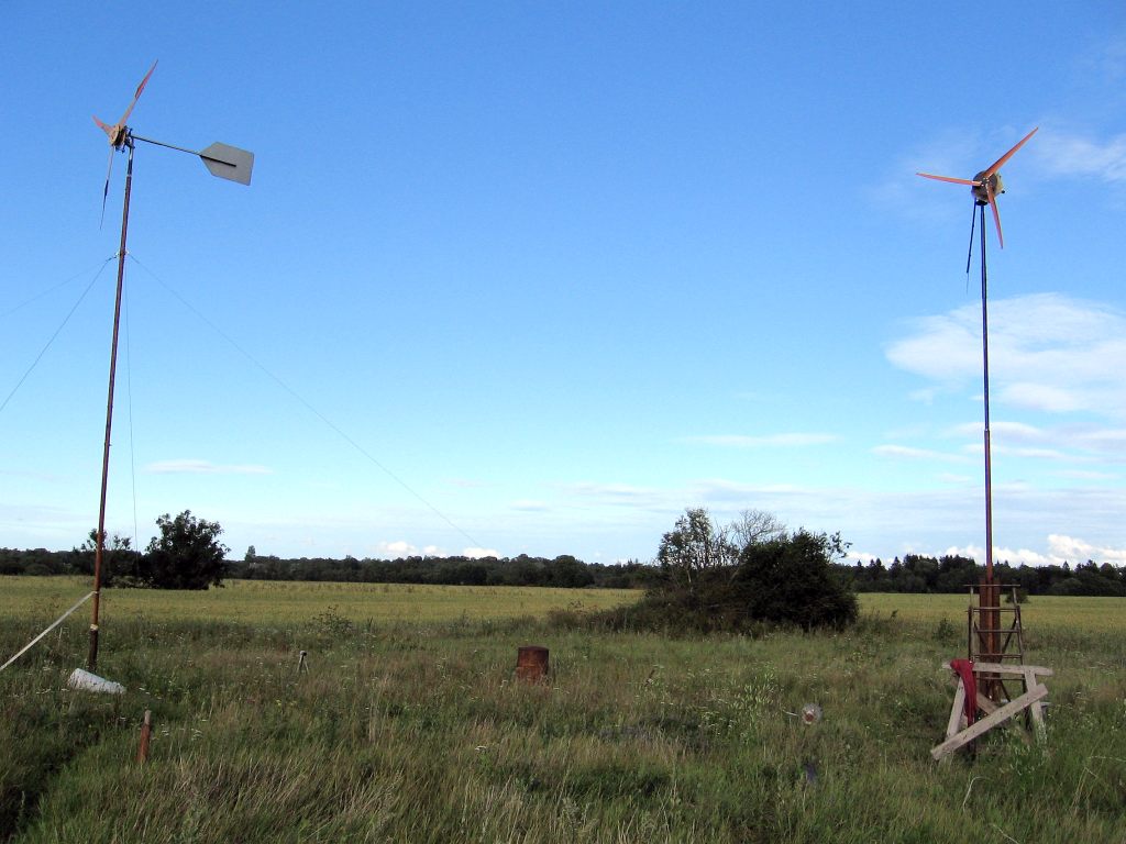

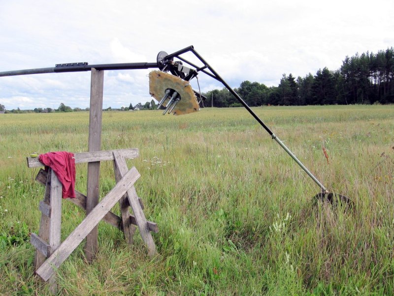

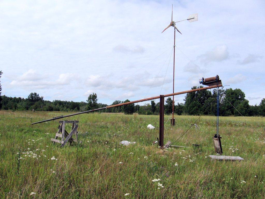

Aniway it working little bit better than sawblade windmill, now down in grass.
This sawblade mill had high rpm. up to 2000 in storm conditions but it killed finally a bearing holder. Less than 2 Years uptime.
Some upgrade for new generator.
But with double rotor it was too heavy and I decided to cut down from 8 meters to 6.
Now it raises easily. New pictures not taken yet.

« Reply #11 on: October 09, 2014, 08:23:31 AM »

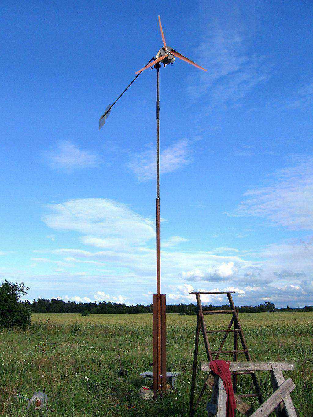

Yesterday, after 6 Years of service, it happened in strong wind.
Not even storm.
It can be new tail, too heawy ,caused it.
5 bolts broken and coils damaged.
Exatly same happened to My another home-made windgenny.
Too thin bolts used.
BR,

I also took ten microwaves apart and made a six coil and dual 8 magnet rotors.  I then built a hugh piggott eight foot turbine and was buying magnets so bought some for the microwave turbine also.  I never did get it right I believe mostly due to the sealed wheel bearing being a bit stiff and I found no way to get some of the grease out.  I also made flat steel rotors as I found the steel car disc added some real lenght to the turbine and made my stator mount bolts too long, which is what looks to be what failed on yours.
I needed the tower for a 48 volt turbine and so now it is sitting on my garage floor.  If I ever build a bigger turbine I am going to salvage the magnets.  The most I ever saw out of mine was a couple hundred watts that never lasted that long due to bearing and being in a pretty seltered spot.  I actually had no issues with using the wire.  I just unwound it then rewound it and ended up with no shorts.  like you there were some bumps in the wire coating so my coils weren't quite as pretty as bought wire but worked just as well.  I did go through a couple of cutting wheels while salvaging it.

Sorry to see the damage.  Building a replacement can be as fun as building the first - you can challenge yourself to do it better!
The stator undergoes a considerable amount of torque when running at high load.  Long all-thread bolts are not ideal for this.
