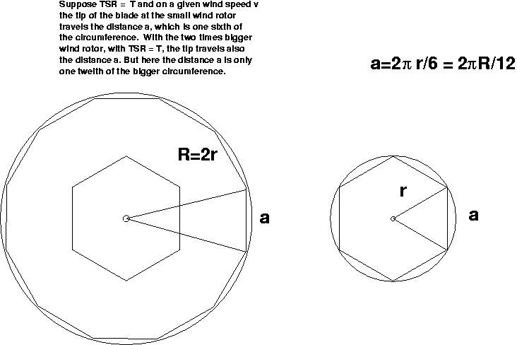

One thing, which might be especially important for wind mill 'propellers'
is the matter that different size wind turbines are behaving themselves quite differently,
if we don't change the number of the blades.
« Last Edit: May 29, 2006, 03:02:35 AM by hvirtane »
