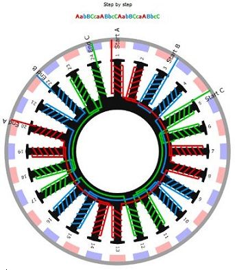

I've attached an image I found while trolling around… it's essentially this:

There are only two winding configurations for that combination of magnets and slots.
https://www.emetor.com/edit/windings/
If a reduction in cogging torque is of any interest to you, you can reduce the magnets to 26, and the lcm is doubled from 168 to 312.
but, about the only thing you can do is increase the copper.

I like the 2 level winding... it makes more sense than the one I mentioned... I've never thought of winding multiple phases on a tooth. However, when a specific tooth has both "W+/W+" on it, does that indicate twice as many turns of the same phase-wire... as opposed to the teeth that are shown as "W+/V-" ?  In other words, all teeth have the same amount of copper... just that some teeth are shared, some are not?
What would the pro's and con's of this type of winding be?

Winding each slot separately reduces the end turns and reduces the winding resistance just a little bit. For a short winding height the decrease in resistance may offset the reduced voltage (.933 instead of .966) and in your case i think this is true. However it is more complicated to wind and sometimes its easier to fit more copper in the machine winding every other tooth.
LCM is least common multiple, its simply the number of positions the magnets will stick to, higher = lower cogging torque generally.
