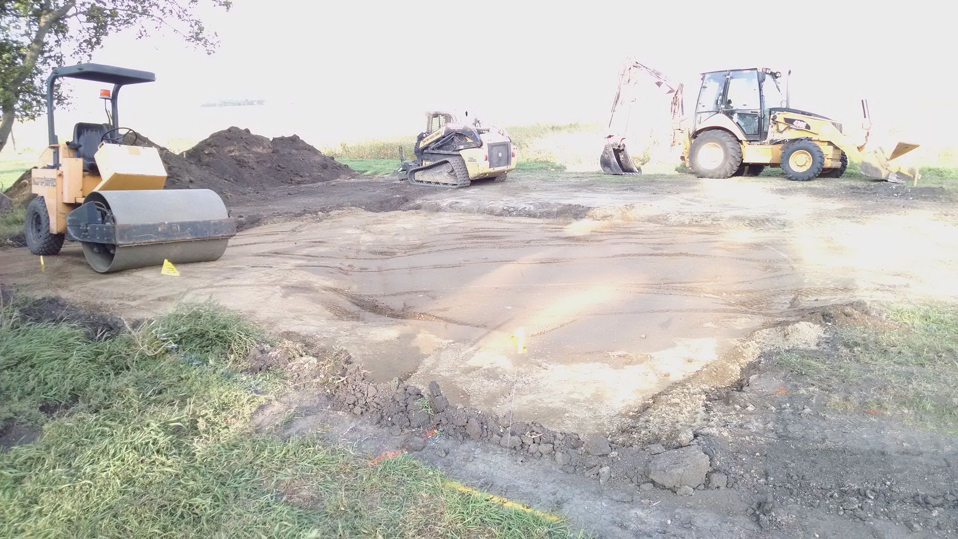

After fighting with portable tent style garages for the last 15 years I finally broke down and am putting in a real garage with space for my shop tools. Started construction a month ago by prepping the pad to put it on.
It is going in to the right of the house where the remains of the last tent garage stand. THat was built on a wood platform that we towed into the backyard so I can re-purpose it to a greenhouse next year. That area sloped off to the right and rear quite a bit

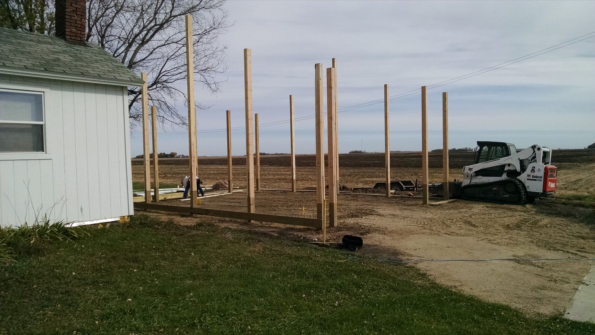

Pad started, note the bobcat in the right rear corner to see how much fill was brought in
Almost done, they brought it up another foot after this picture

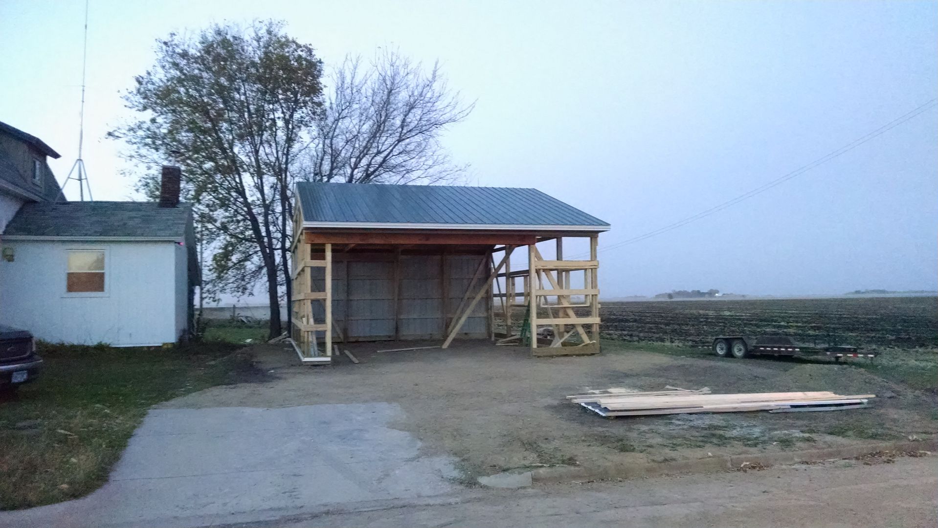

Pole barn style construction, it will have a full interior steel liner and be insulated with R50 in the attic space, 8 inches fiberglass in the walls, 9x16 garage door is R16...
Friday the 16th they ended like this

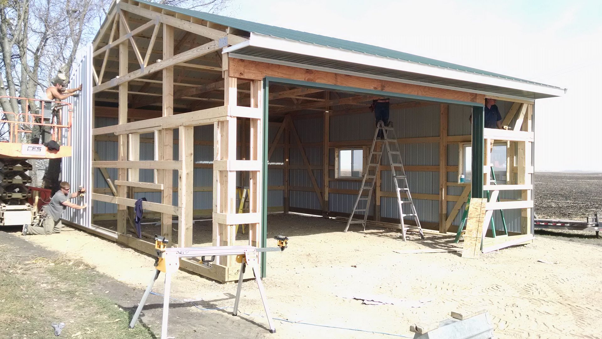

« Reply #2 on: October 21, 2015, 08:25:50 PM »

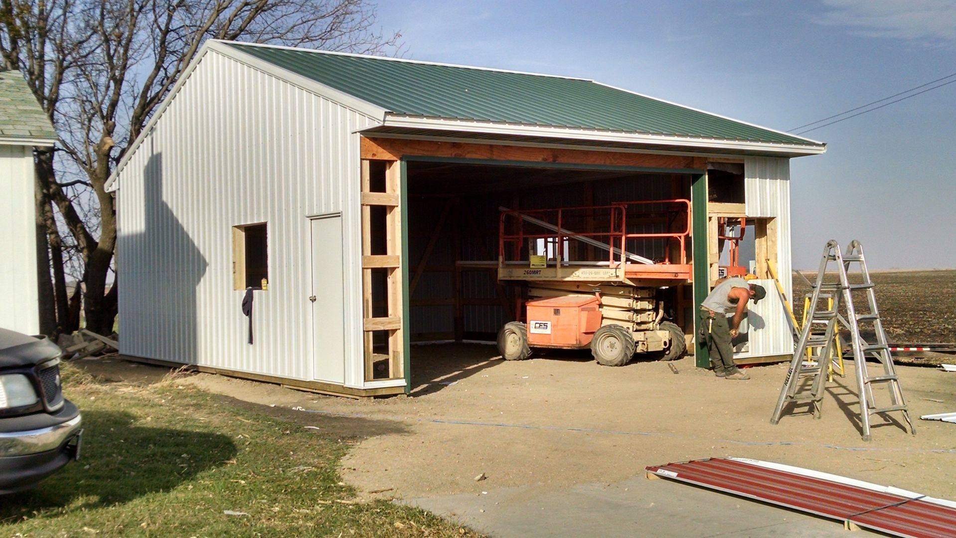

Yesterday they picked back up(had 2 days of heavy winds)
This was 11Am
2PM
4pm
and 5:30 as they finished up for the day. Next step is concrete for the floor(6 inch slab, 1/2 inch rebar 2' on center) then the insulation in the attic and walls goes in then the steel wall panels. Short 2 windows at the moment, they are ordered but not in

Re: New garage going up!
« Reply #3 on: October 22, 2015, 03:19:11 AM »
Good to see a 'Pole barn style construction' .
I am not used to seeing the openness around buildings, hmm, windy?
That looks a good sub base they put down.
Is that pressure treated timber? do you get wood termites, wood worm beetle etc?

« Reply #6 on: October 22, 2015, 03:25:35 PM »
I am doing all the wiring surface mounted in conduit so I can make changes easily as my needs change.
Yes it is windy here, average yearly wind speed is 18mph! Peak wind this summer was 110mph!
The posts are pressure treated for the bottom 6 feet and have a 50 year warranty! No real issues here with termites, barn beetles can cause damage but the rest of the lumber was pre-sprayed to stop it.

« Reply #12 on: October 26, 2015, 08:14:32 PM »
 Adding a couple of inches of styrofoam under the concrete would not cost that much, and then, the heated floor would work nicely. I did that to a house we built in Arkansas.
  Piped hot water from the switched dump load of the 4 KW wind turbine I built. I put 2--2KW water heater elements in a 150 Gallon butane  tank that was sitting on the concrete floor of the attached greenhouse we had. Radiant heat from that tank kept plants from freezing.
  We had an automotive engine water pump hooked to a DC generator as a motor. Only ran that gen/motor for 10 minutes at a time. Never had "HOT" water, but, you could feel the difference after the turbine was switched to those heater elements. We were in extreme NW Arkansas in the Ozarks, 40 miles south of Missouri state line..

« Reply #14 on: October 27, 2015, 09:22:59 AM »
  :-[ Probably should have added, we built an earth sheltered house, so, mean ground temps were around 55 degrees. I consulted with the expert of a community college and was told, "Concrete will crush styrofoam".  ::)
 We put 4-5" of concrete on 2 layers of 1" styrofoam and wire mesh. . We just wanted to keep the floor from being cold. The pipes were used 1.5" galvanized pipe. Also, we had NO building codes to harrass us. If it wasn't for Lawyers, a LOT of this building code crap would not be needed. They constantly look for ways to suck money out of good products and uses.

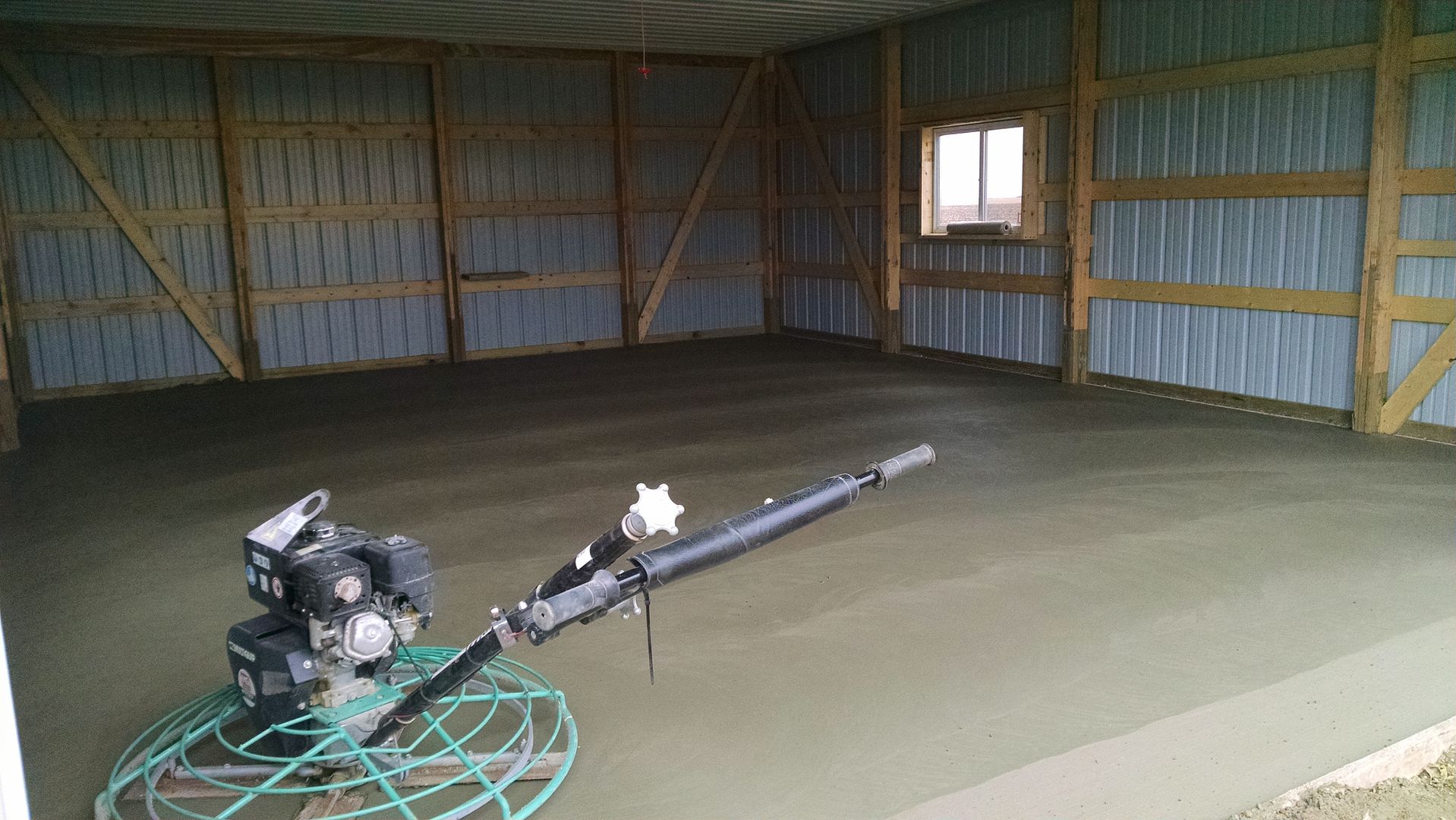

Working the concrete, he was doing edges so left footprints that they have taken out with the power float. Needs one more working with the float then just needs to set.
Minnesota code no longer allows sumps for drainage, people were pouring oil down them and it was getting into the ground water... so i will have to get a squeegee and push it out the door if I have a lot of melt off the truck

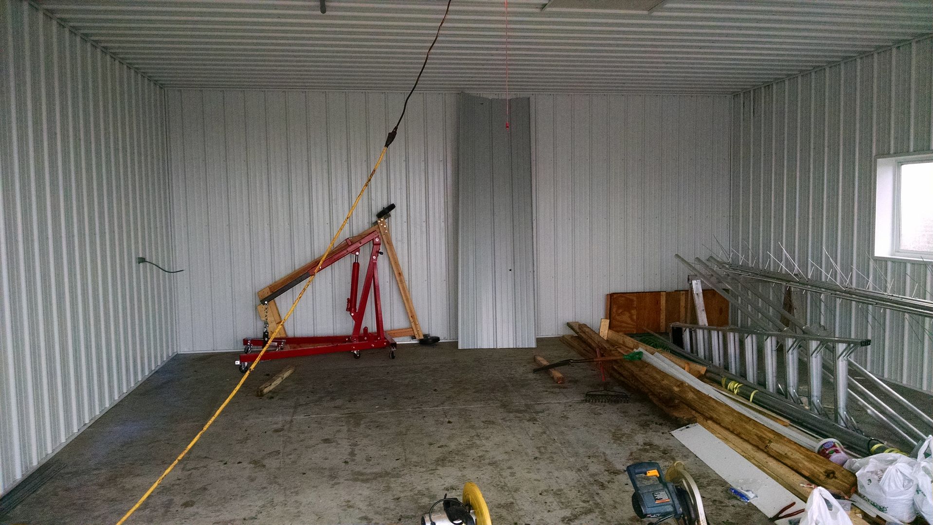

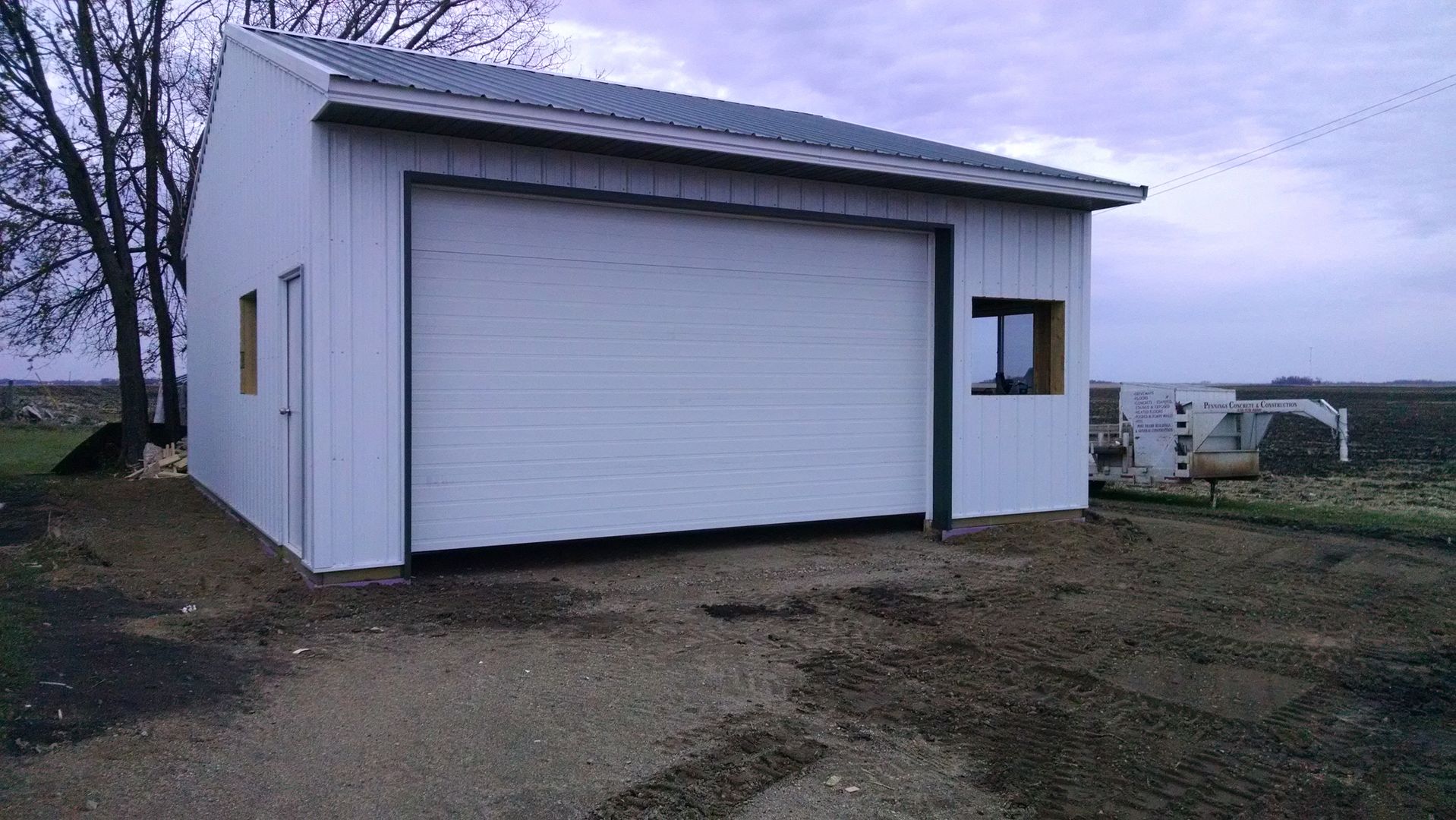

« Reply #23 on: November 12, 2015, 07:05:06 PM »
More progress! Last 2 windows came in(replacements for 2 that were shipped broken) and they have all the wall insulation up and most of the liner purlins. Still have to blow in ceiling insulation and put up the liner steel.
Mary B
  • Posts: 3205
« Reply #24 on: November 17, 2015, 11:46:54 PM »

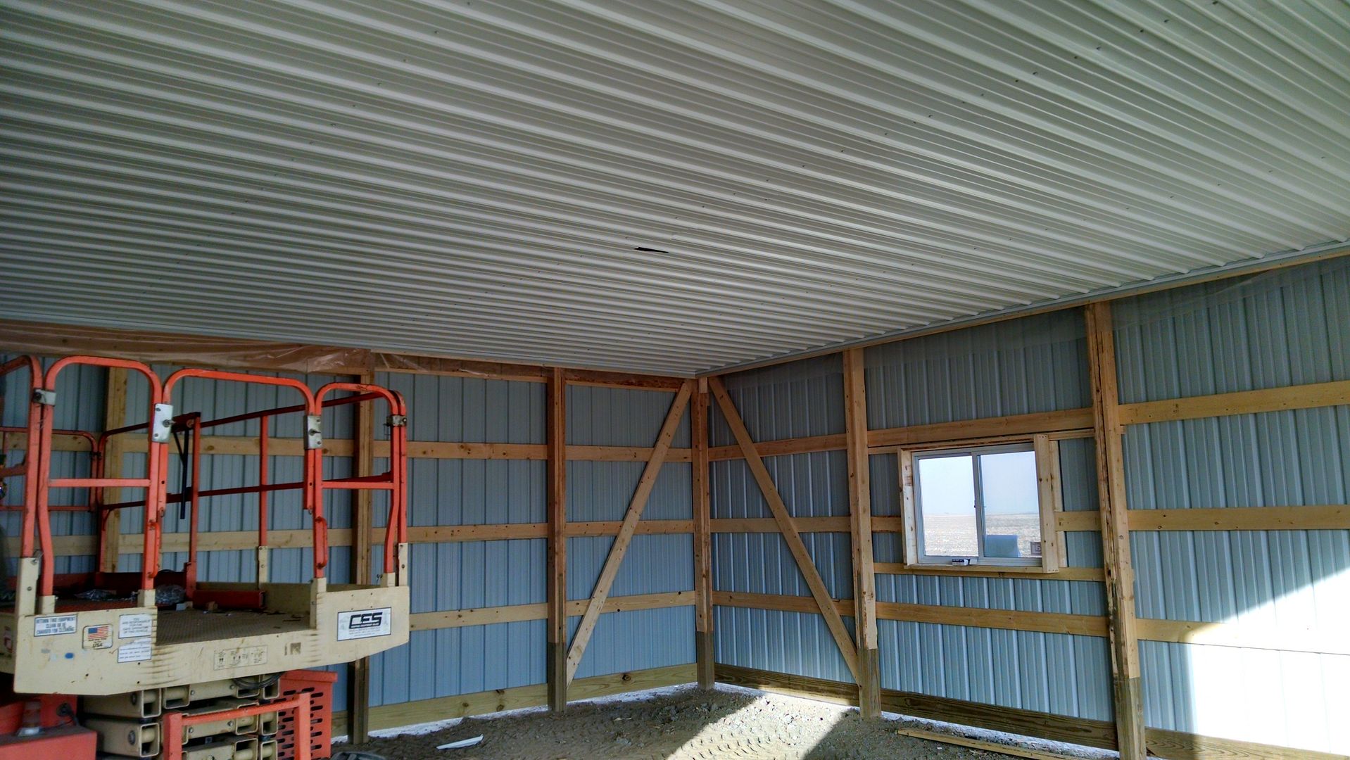

Liner and all the window and door trim in and caulked! Just waiting for the insulation contractor! After 2 days of heavy rain the guys were chased off the barns they are putting up by mud. Even around my site we fought mud bringing in materials(which were soaking wet, I have to put the temporary heater out there tomorrow to dry it out). I stepped in the electrical trench by accident and sank 8 inches...  Electrical is roughed in too as you can see by the wire hanging out of the wall.

« Reply #26 on: November 18, 2015, 10:44:12 AM »
Its really coming along nicely. I have to wonder though are you concerned about sweating at all? I've seen 1 or 2 building constructed in a similar manor as yours that had real problems with sweating
I live so far outside of the box, when I die they will stretch my carcass over the coffin
Mary B
  • Posts: 3205
« Reply #27 on: November 18, 2015, 05:20:02 PM »
Shouldn't be an issue as well insulated as it is.

Depends on your local moisture content in the soil.  If she back filled with clay it shouldn't be an issue.  If the builder thought it was they'd of put poly down before the pour.

« Reply #32 on: November 19, 2015, 07:02:57 PM »
Insulated the attic space today. Temps immediately rose enough that I took off a layer of jacket to stop sweating. I have power to the breaker box in the garage now and I will have part of it wired and functional tomorrow or Saturday!
