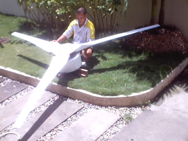

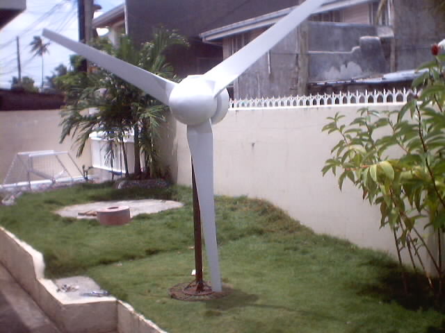

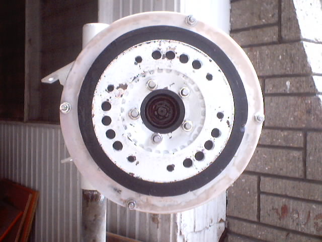

Hello everyone, this is my 10 ft fiberglass windturbine in the Philippines. It is based
on Hugh design and has been flying for two years now without any problem. It has 9 coils
and 24 maqnets.
stator and magnet rotor disk assembly
stator and magnet disk assembly with fiberglass cover

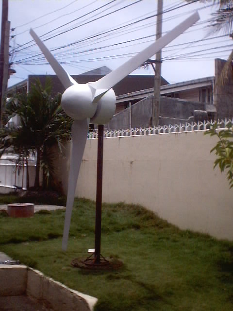

10 foot fiberglass blades test assembled in the ground
assembled unit with fiberglass cone installed
assembled wind turbine without tail

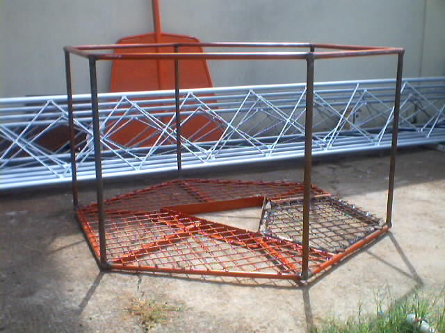

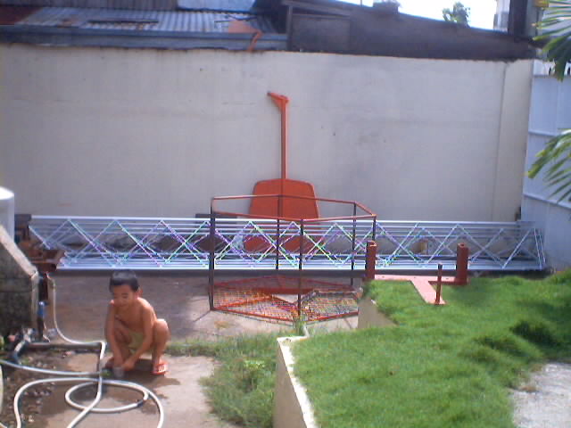

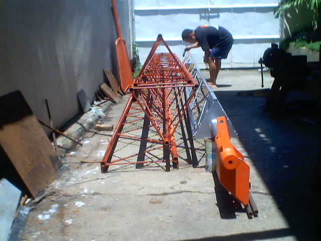

4 20 ft section of lattice crank-up tower being painted
tower with work cage and base. Tower is tilted with the base hinge for easy installation. My boy doing his own work too.
Tower completely painted and all sections are installed. Workcage to be installed in the
1st 20 ft section for easy assembly of the wind turbine.

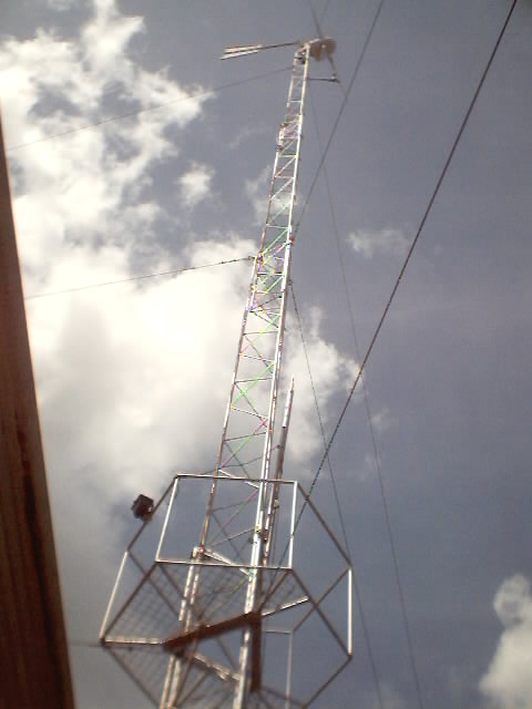

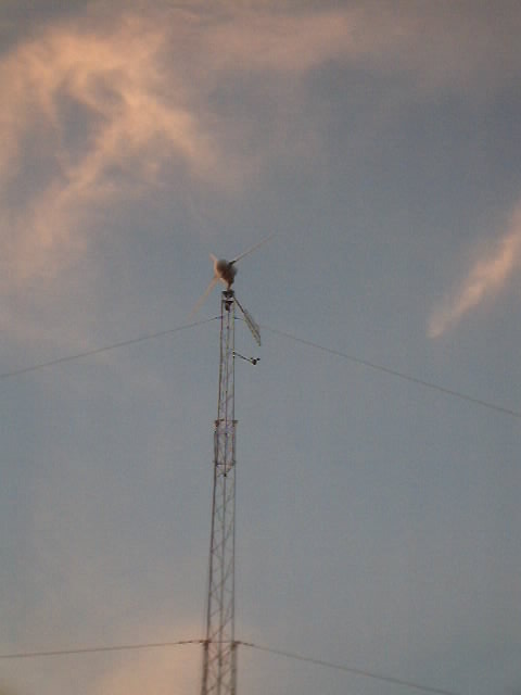

picture of wind turbine installed
picture of the wind turbine 75 ft from the ground with the anemometer in the 62 ft section. The turbine look small up there.

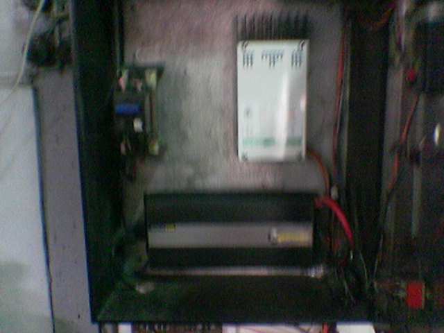

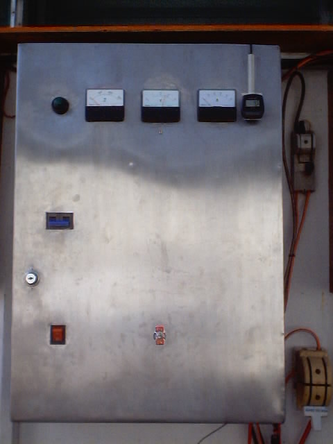

This is my control panel, it has a trace c-40 charge controller, a xantrex 1500 watts
inverter inside. The panel meters are 300v AC meter for our local current, center
meter is 20v DC for battery voltage reading and last meter is a 50 amp DC ammeter.
The black meter is the anemometer.
Sorry for the dark picture. This is the inside of the control panel.

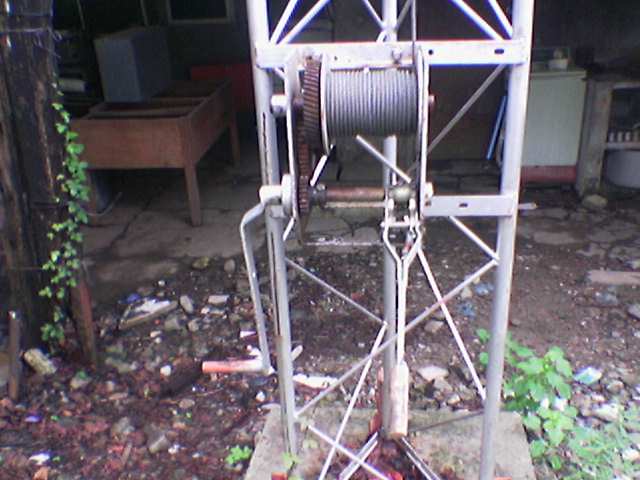

Homemade mechanical winch, use to lift the tower section and turbine.

Nice work, I like the work platform.

Thank you everyone for your comments. Our average wind speed here in the Philippines is 3 to 7 mph and this turbine generate electricity in the slightest wind. It start at around 5 mph and at 8.2 mph it reads already 11 amps and at 15.5 mph wind it generates 35 amps. I've seen 50 amperes at 20 mph and 62 amperes at 23 mph wind. This reading was taken with my Fluke digital clamp meter since my panel meter reads up to 50 amps DC only. All these readings were taken with a 400 watts load on the inverter.
I am located in Iloilo City, Western Visayas and my place is near the airport. The tower
has a beacon light on top for warning system and this is 12 volts powered.

Hannu, thanks for the compliments.
I have made a mold for the blades so all would be of the same weight and size, more or less, for good balance.
« Last Edit: June 05, 2006, 06:33:06 PM by skyking01 »
My idea was that if you did all the work
to make a mold you might make more
blades using that mold to be sold
to other people making similar turbines?
You seem to have made also
a very nice protection case
for the generator. Did you find
a ready made thing for that or
did you cast even that yourself?

Yes Hannu, I could make more blades of this kind with my mold for those who use the same machine.
The cover is fiberglas made too.
So far in our place, this is the first turbine to be installed and lately I have seen one, a chinese made machine flying.

Blade weight is 1.20 kilos more or less and a TSR of 6.5. I used Hugh design spreadsheets and you could used it using microsoft excel. Will try to post more pictures of the blade mold and on how the tower is lowered and raised.
The 4 sections of the tower are assembled in the ground attached to the based with a hinge. The base is anchored to the ground with 6,sed. 1" J bolts 30 inches long. A gin pole is then used to tilt the tower using the winch. The tower is so easy to raised and lowered using the homemade winch. The winch is capable of lifting up to 600 kls. Gear ratio is 30:1 and main shaft of winch is 1" carbon steel. I design it myself and I use a commercial come-along winch as a stopper and  release. This has an adapter for electric motor with gear speed of 60:1. It only takes two to three person to work on this tower. One has to crank the winch, me on top of the tower, in the work platform, and the other person to tighten or loosen the turnbuckles. I am using 5/16" steel cables for my guy wires and shackles for easy removal.
Skyking01
