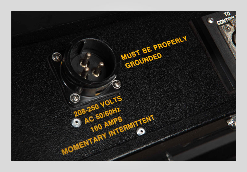

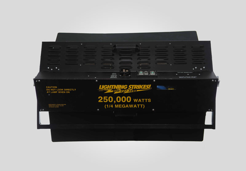

14A on the lights??
12volt Bruce. Not mine by the way..that's a PR pic. €500 meter...I'm not biting.
I can use 90kVA on lights if you give me enough dosh.

Do not look at Scruff's lighting with remaining eye...

Yurp we have them too for the telly.
Yer supposed to put them behind things because they're weapons if the lense is exposed.

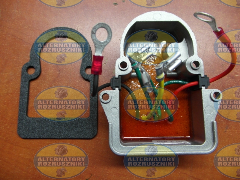

I must look up the circuit. There's +12V constant one side of the lamp, +12v switched thuther and some other trickery.
Pretty difficult regulator to source the sticker says Balmar.

« Reply #131 on: October 23, 2020, 06:06:20 PM »
Ok I was just being lazy...here's one...cheaper than my time's worth.
Did my own homework there...thanks for the poke AB
ain't much fixing 'em they're submerged in poxy
