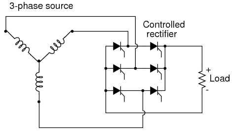

« Reply #15 on: March 15, 2012, 06:55:20 PM »
I would use a 50amp breaker (self-reset) for the DC lines... I have also found you can use a 300amp SCR as a rectifier in a bridge configuration (6/w 3phase) for cheaper than the rectifier diode listed, and the thread dia is about a 1/2in to the heatsink, and the trick is to leave the gate termial isolated, in other words you can get a SCR with higher ampere rating for less the cost of a large package rectifier diode...
http://www.allaboutcircuits.com/vol_3/chpt_7/5.html
Image's from link

Quote from: JW
« Reply #17 on: March 15, 2012, 07:10:49 PM »
Are you sure about using SCRs as rectifiers? Don't think it works like that. Just grabbed a few large SCRs out of the box and none behave as a diode, with the gate left unconnected.
The link (allaboutcircuits) shows that when the gate is left disconnected it behaves as a Shockley diode (which is a 4-layer diode). Note that this is not a Schottky diode! (which is a 2-layer diode).
If I'm wrong, please correct me
JW
« Reply #18 on: March 15, 2012, 07:34:29 PM »
Quote from: dinges
Well this one does, as you can see from the picture I have my Fluke 88 connected in "diode test mode" with the gate isolated and its passing the diode check...

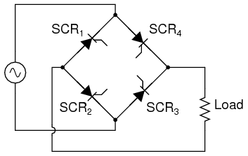

Are you sure to have polarity correct? Im getting a reading of less than one ohm.
« Reply #19 on: March 15, 2012, 07:54:58 PM »
Quote from: JW
Yes, I see. It appears the SCR is defect. Have you tried measuring it with other polarity? (reversing the meter leads)
Notice that in the allaboutcircuits article that in the schematic, they talk of controlled rectification; they've left out the electronics to drive the gates of the SCRs, but that's definitely needed to use SCRs as rectifiers (as e.g. in synchronous rectifiers).
Tested a few more known-good SCRs, and all measure fine on the semi-conductor analyzer (with ability to measure the most important parameters of SCRs), but none show any diode action between K and A; which is to be expected, because in that case the Gate would be useless....
My suspicion is that your SCR is defect and is a dead short. By reversing the DMM leads you should be able to verify for sure.
Either that, or my knowledge about SCRs is seriously lacking....
JW
« Reply #20 on: March 15, 2012, 08:08:45 PM »
Quote from: dinges
I just did that, and you are correct its a dead short. interesting.
Just as an aside I abandoned any attempts to use SCR's with the switching arrays im running now, Mosfets when syncronised can give those low impeadance (switching) readings using DC. The problem with SCR's is that they are subject to 0volts threshold, so SCR's work great as diodes when used in the bridge configuration. The schematic's are pretty clear as to DC output. So for the same reason an SCR is no-good for a DC switching application (mosfets n/p channel) it is usable as a rectifier when the gate is not energized.

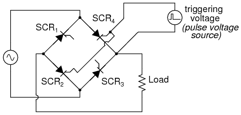

Quote from: dinges
Im going to look for where it says the gates need to be rectified to convert AC to DC
JW
« Reply #21 on: March 15, 2012, 08:14:10 PM »
aH Ha now I see what you mean

Im just wondering, is it possible to cast a trigger coil in the stator, if anyone wanted to take the leap too-
Quote from: dinges
Quote from: dinges
"synchronous rectification" SCR's are way cheaper than rectifier diodes for current capacity, so if you could make a cheaper rectifier with a simple trigger circuit (cast into the stator) wouldnt that be worth the effort.
Doesnt seem that hard with the 3/4 9/12 coil-magnet-ratio

« Reply #24 on: Today at 04:47:42 AM »
Ty the gate to the anode with a signal diode for half wave Rectifier
Beginning of thread----
I decided ok, lets check that out, ie: "tie the gate to the anode" I was pretty optimistic, a diode in series is a halfwave rectifier.
As Dinges pointed out a shorted SCR cant work, he is correct. When the gate is tied to the anode, the SCR conducts in both directions irregaurdless (like its shorted).
What I did find that was interesting, was that a led in series with the connection (gate to anode) caused the SCR to act like a diode. Im pretty sure the arrangement will need a shunt resistor in parallel to protect the diode(led). Im also considering trying other diodes like a 4011 or IN914.
I just find this interesting.

Here's a simple schematic of the connections

« Reply #7 on: June 30, 2012, 07:15:51 AM »
(Attachment Link)
I joined fieldlines just so I could post a message to say I think that diode, which is tied to the SCR gate, is backwards.
I am using some old SCRs as diodes and I was hunting the internet to confirm my idea.
I tested at less than 6 volts, without a gate diode. I am just tying gate to anode). The idea works.
I added the gate diode so I can block negative gate voltage so as to not harm the gate. Thanks for the idea.
