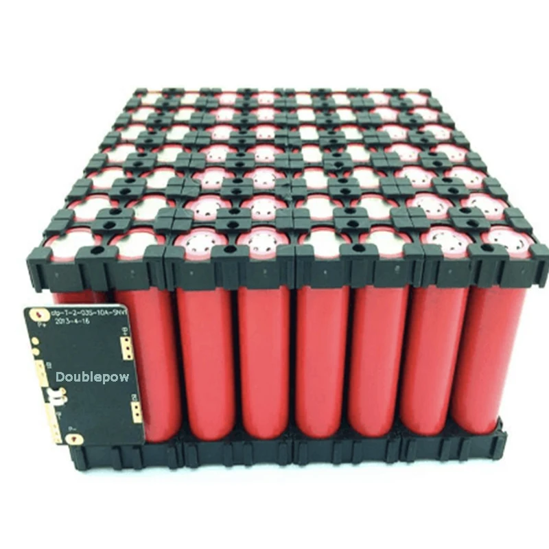

I have just assembled a 15V pack of NiMh and according to the sleeve on the battery they are 2.6Ah or 2600mAh, which for a cell the size of a AA battery I find difficult. I didn't have them long enough to charge one and put them in a discharger to measure the capacity. the only drawback I see is the voltage per cell against Li. Makes the pack size larger.
I intended to build a large capacity pack of 18650 Li cells but I gave up. Aquiring the cells over time kept the cost down but charging is a different story, the chargers are not cheap with the management system. so now I have returned to lead acid, cheaper easy to charge, stand a reasonable leavel of abuse, and dont have electronics suddenly shutting them off when the voltage drops below the recomended level.  As long as lead acid are not left in a discharged state for a long time they will pick up.
