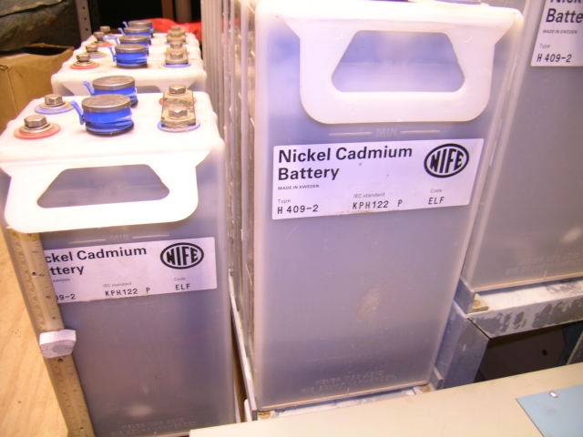

I went to ask my uncle some questions about getting a electric motor to be used as a conversion to a 'Zubbly' alternator(I know I'll be posting questions about the conversion). He asked me some general questions for what I planned. Then informed me that he had 13 NiCad batteries not being used, if I'd like to have them and their charger. Being a person that really likes the way 'free' rings when used describing something I need, I took him up on his offer.
Now comes the task of identifying these batteries, and if they will be good for my system. These will be used on a cabin that is off grid and currently is not truly lived in except in the summer. Right now I expect this system to only really run lighting, so a small system would be ok to start off with. This cabin is left unattended for one month or more at times. Also we dont have any kind of a RE system setup right now so I can build around these batteries.
Now, back to the battery setup. They are from a backup generator, used for starting. My uncel beleives that they are around 3 years old, but received little use. I checked them and each cell has 1.2 volts in them. The batteries are paired up 2 cells per battery, so I have 26 cells available. I'm guessing this bank was paired up for 36 volts?
The bennifits I understand are that these NiCads are able to withstand cold temperatures. Are able to stand up to the test of time if treated good, up to 20 years? Beyond that a lot that I read I beleive mostly applies to the small NiCads, not the flooded cells? Its hard to draw a line in the sand for using these with with solar/wind systems.
Anyway, My questions are.
  1. With these wet cells should you 'deep cycle' them, or treat them like a normal battery and try to keep them withen limits, and what are those limits.
  2. Can someone identify who made these? I beleive they were made by Saft power systems of Sweden, but I've found very simalar info from a Indian company.
  3. Can you charge these like you would a lead-acid by using a shunt regulator, and just dump the load into the batteries untill they are charged?
  4. What kind of voltage setups are available with these. The way I'm thinking with 12v I'd have to leave a couple cells out, and other setups except 32v as well.
  5. If you had a choice between these batteries or '8D' batteries for my setup, what would you choose?
So here's the Pics.
Top view of the batteries, ruler included for compairison.
Side view of batteries, HDD magnet holding the ruler to the side.
The Only identifying label.
Battery charger innards.
and the Charger info.
Sorry for such the long post, I figured I'd give as much detail as possible. If anyone can help me with these questions, and probably more as they come to mind I'd be very thankful.

  1. cells would be a nominal 32v battery. Usually they use 10 cells for 12V.
  2. V was common for lighting plants at one time.
You have a good find there, they are quite modern by NiFe standards, I have never seen them without wooden crates, they can't be many years old and should last you many years if you keep the electrolyte level up and change it every few years.
« Last Edit: January 25, 2006, 02:00:31 AM by Flux »

 I must say, I am just as green as others. These have to be some of the nicest battery sets I have ever seen without them being new.
A couple things that I have learned by using and reading as much as I can about NiCds. And with reference to your very well done pictures.
NiCds can make use of a standard Lead acid battery charger but only if the volatges are kept close.
You where very correct in the being able to take extreme colds, so long as they have a good charge even at 50% charge they'll survive.
The one thing you'll not want to do it let them go below 1.01Vdc/cell. AT this point NiCds begin to reverse polarity internally and are subject to bursting if you try to recover them ( happen in our shop more than once).
Seeing that these have a "buss" bar linking them into 2.4Vdc you could try CAREFULLY removing this bar. The bolt should unscrew , but becareful if it offers resistance tighten it back down and leave it otherwise you may tear the inside.
NiCds will loose energy just sitting there so it may be best to give them all a voltage test with the buss bar removed and if by chance you happen to have a small wall wart that outputs down in the 3VDC range charging in mAh range, put a resistor across it to bring down the voltage and let it sit for a couple hours on each battery.
This will wake them up and though the very low charge may seem to take forever to charge, it will keep them from dying a no-charge death until you have the RE built.
That charger you got with them also looks to be very very well engineered, by the looks of the input voltage transformers. You could adapt it to just about whatever voltage input you have, just make sure the taps agree with what you have. The output will do the rest. Another point , that big grounding fuse you have in there, I suspect it is a chemical fuse, CAREFULLY remove it and go get another new one rated the same or as close as possible. These were notorious for drying up on the inside and themselves becoming a hazard. You'll want to make sure whatever you use is a FAST_ACTING fuse, not slow-blow.
Take decent care of these, and they'll last your life time.
BTW: NiCds actually work better when you use them down to 80% charge and when fully charged will actually read 1.25Vdc, but I wouldn't design with that in mind.
I do think the label is misleading unless there are some batteries missing as there really isn't a big way of getting 42Vdc out of 31.2Vdc total on the batteries. Of course there are ways but not a straight forward route. Since the label does show the 16.5Ah I would guess that rating stands for each one individual as they used these in serial mode to get the higher voltages
As for question #5 I'll take these!! And if you want to let me know where you're at and I will come pick them up too <LOL>
Have fun with these!! They are quite a find.

Those are Saft station batteries and it looks like you have part of a backup power suply for a high voltage substation. If these are what I think they are, they powered instrumentation and charged the braker for an auotmatic restart.
That panel in the background should connect to an inverter/charger. This system is nice because it has a recon charge function and low idle power draw so it can last for hours or days in an interuption.
If these have been sitting I would dump them,washthem out with distilled watter and refill with electrolite. There is also a special sell oil Saft sells to coat the tops of the fliud in the cells and reduce evaporation.

« Reply #27 on: April 08, 2025, 01:56:46 PM »
Is there a market for these big Nicad wet cells?  I’m in New England and I might be able to get some. They are overkill for my remote camp.
