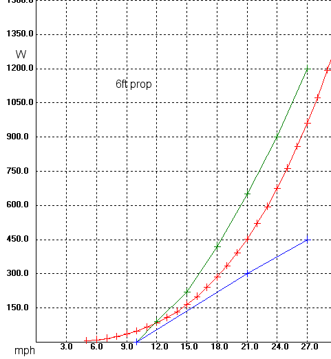

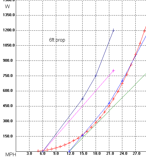

Here are the curves for a 6 ft machine. Machine input output and prop output at best tsr.
With axial machines the output curve is linear and the input includes the losses and curves upwards.
Points to the left of the prop power curve are towards stall ones to the right are towards over speed.
You can see that the right hand track is good and even at 10 mph the prop will speed up to compensate to a large extent.
With the other case we go into stall from the beginning. and you don't get the alternator output suggested by its output curve because there is no power from the prop to supply the input

If we try to make the alternator input fit along the low wind part of the power curve you can see that the output will be very low in high winds because the alternator is not stiff enough to load the prop and to do this we have made the efficiency very low.
What is normally done is to make a compromise, choose the cut in for the best prop tsr at say 10 mph, the prop will run fast enough to allow cut in at about 7 mph. We make the alternator less efficient so that it has a lower slope and we ask the prop to run on the edge of stall in mid winds. I high winds it will be less stalled or even near the peak. Alternator efficiency is about 50% at say 20 mph and falls lower beyond this. We have good low wind performance with reasonable efficiency in the most common winds and we accept less than the ideal in high winds when the batteries are likely to be dumping.
We get results below 10 mph as the prop will run fast enough at good power. We don't quite make the output curve in the higher winds because the prop is running slow but not far off peak as to cause serious loss.
So to sum up, the first step is to choose a suitable cut in speed and if too low increase air gap to raise it. Then make the alternator just stiff enough to avoid stall and if it does stall, increase line resistance to lower the slope
Not a perfect solution but a simple one that gives the cheapest alternator and has good energy capture in the common winds. We have far better energy capture than the old machines with cut in about 12 mph with field and iron losses but we do loose the high peaks in the occasional high winds. For a while most have been happy to go this way.

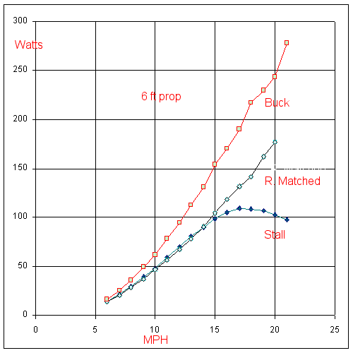

Before looking at other options this seems a good place to look at some actual results from a 6 ft machine with different options.
This graph shows what happens with the cut in set for low speed and keeping alternator efficiency high. Curve marked stall.
The next case has resistance added to the line to let the prop speed up and shows clearly that lowering the alternator efficiency is more than compensated for by bringing the prop out of stall.
The final curve is the holy grail where the load is matched to keep the prop happy and done without adding losses. the curve is called buck.
The wind site was very bad and results are below what is possible but it is a reasonable comparison. At higher wind speeds the difference is much more dramatic, stall stays where it is, resistive match tails off like stall but at a nmch higher value and buck keeps rising until the thing furls.

so now i am on the edge of my seat- what is used to make the 'buck' curve :)
allan
« Last Edit: March 18, 2006, 10:58:30 AM by kitno455 »
Re: Matching the load
« Reply #9 on: March 18, 2006, 02:10:37 PM »
The buck curve is using a dc-dc buck(step down ) converter. As far as I can tell the MX60 is a buck converter.

Strictly speaking it is the input power line( which curves upwards) not the straight line output one that we must consider, but for our discussion the input line is nearly straight compared with the cube .
I did say somewhere that points to the left of the cube are towards stall and left it at that because the prop power curve has a significantly flat top and going either side of the cube in moderation is not going to hurt . Stall( separation of air on the blade) comes when we go too far and run off the flat top.
If I gave the impression that we can't operate to the left of the line I couldn't justify the way we design the present machines for best operation. In that explanation I said that in mid winds winds we were pushing the prop towards stall as far as we can reasonably go. It is the fact that the prop curve has this flat top that lets us get a reasonable performance from most machines.
That said, you are right that folks must grasp the idea that if we go too far to the left of the line we stall and if we go too far to the right we run away and come off the peak
 Perhaps it would help to think of the power curve as a very thick line and we work without falling off the edge.

I think most of you have now got to grips with the problem. We need a voltage that rises directly with speed to keep the prop on the top of its curve and we have a battery that stays at constant voltage. Our best hope lies with an electronic converter to match the voltages on the dc side. It is the equivalent of the variac on the ac side but with no moving parts to wear out.
The voltage we decide to start from will decide the type of converter we use. From previous methods we have started with an alternator voltage suitable to start charging at cut in wind speed. If we do this we need a step down converter( buck).
We have also seen that from 15 mph upwards a conventional alternator of good efficiency tracks the power curve very well so why not consider this as the starting point and use dc boost converter to produce power in low winds. If for some odd reason we chose an alternator that was too fast in low winds and too slow in high winds we could still use it with a buck-boost converter.
These ideas so far assume we keep a standard diode rectifier but again we are not forced to do so. A controlled rectifier can be used to match a high voltage alternator to a lower dc load. This is good old technology proven since the 60's and very robust so it would be foolish to ignore it. Modern methods have advantages but are not as tough and in this application that may have a large effect on the final choice.

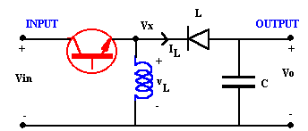

Now let's look at what we could do with a boost converter. I said previously that if we took a machine intended to cut in at say 7 mph and ran it on a system of double the voltage it would most likely track the high winds with an efficiency of over 70% depending on the alternator design and the line losses.
For anyone who wants to experiment this could be a starting point that would cost nothing except for an extra battery. It could be a good way to upgrade a 12v machine to 24v or a 24v system to 48V. If anyone is serious about trying it, try your alternator on a system of twice voltage and see if it is suitable. You will loose all output below 10 mph at this stage but it should perform exceedingly well above 12 to 15 mph and you should probably see the same amps into the new system at twice the volts.
How can we boost the volts at low speed to make use of the low winds?. There are many ways, some good and others not so good. Voltage doublers crop up here from time to time using capacitors charged at the low voltage and added to the incoming ac volts to double it. They do work but beyond a few watts they are not nice things and they do their own thing, we need to decide what they do.
Most of the practical converters involve storage of energy in inductors. All the common boost circuits worth looking at use this inductive approach. I don't feel inclined to spend time drawing and explaining these devices at the moment, do a Google and they are everywhere. If this link works it seem a as good a starting place as any,
http://www.powerdesigners.com/InfoWeb/design_center/articles/DC-DC/converter.shtm
It has all the common forms of converter and the explanation is fairly simple, you should get the general idea at least. If you get carried away with more complicated things I must warn you that there is an error in his drawing of the CUK converter but otherwise it it is fine.
If you look at the boost converter you will see that the input is to an inductor. This raises an interesting point for those playing with motor conversions. Your alternator has 3 inductors in it ( part of its synchronus reactance for the technical) and it is possible to use this to do the boosting but I will come back to that later with some more ideas. For those with an air gap alternator you will need to rectify the dc and smooth it a bit with a capacitor and treat that as the input to your boost converter. If you turn the transistor switch on and off at about 50% duty cycle the thing will double the volts. This is the starting point at cut in and you will find that the output rises much too fast with wind speed. You need to reduce the pulse length to reduce the boost ratio of the converter and when you reach 12 to 15mph you no longer need the converter and if you remove the transistor pulse the machine carries on without the converter.
In this simple form the converter inductor and series diode both have to carry the full machine current at full load but the transistor is not involved.
There are ways to avoid this and if you take that approach you have a low wind converter that is redundant in high winds and if it failed you still have good performance above 12 mph. For experimental things this may be of more importance than the slight gain in efficiency if we boost in another way.

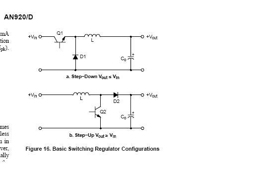

flux i dont like the buck converter on that page , it seems to me the diode is backwards.
http://www.otherpower.com/images/scimages/2965/bad_buck_boost.gif 2Kb
i like this one much better..
a buck and a buck boost .
http://www.otherpower.com/images/scimages/2965/buck_buck_boost.jpg 28Kb

His buck converter is ok, so is the boost. He has made a cockup with the buck -boost and the CUK. both of these invert the polarity, it's not the diode that is wrong it's the output voltage marked with the wrong polarity. I spotted the Cuk but not the buck boost. It may not have been a wise choice for a link. Yours is fine but doesn't have the waveforms.
Well spotted.

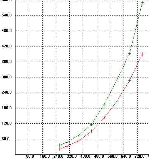

Here is a curve of a small alternator with boost at bottom end ( green is input red is output) and also a circuit of how to feed a converter so that it only carries the boost current.
For reasonable size and efficiency the inductor needs to have a ferrite core and the switching frequency can be about 30kHz. If you use an iron core for the inductor the frequency will have to be kept to a few kHz but it will need more turns and have more resistance and even at these frequencies it will have significant iron loss, For the high frequency chopper the output diode of the converter must be as fast as possible so it must be a schottky or an ultra fast diode. The 3 input diodes can be ordinary slow ones but schottky would help with volt drop.
Ideally the wire for the inductor should be multi strand ( Litz) but for this power level you may get away without it.
The circuit shows a bipolar transistor( easy to draw) but the thing to use is a mosfet. Although they have high gate impedance you must drive them from a low impedance source to prevent capacitively coupled spikes from the drain circuit from breaking the gate insulation. There are plenty of proper drivers around and the practice of using logic gates or 555's is not good enough even for a converter of this size.
Although 30kHz is not that fast, the edges of the switching waveforms are in low radio frequencies and there are no bits of wire at this frequency, they are normally inductors, can be capacitors or transmission lines so layout is critical. the input part with the inductor is no problem but the loop round the mosfet, fast diode and output caoacitor must be as short as possible and it is a good idea to mount the whole thing close to a ground plate to act as a ground plane. The capacitor ought to be low esr type and a small low inductance polypropylene or similar is worth adding in parallel.
I will suggest some things for the pwm generator and the control signal later.

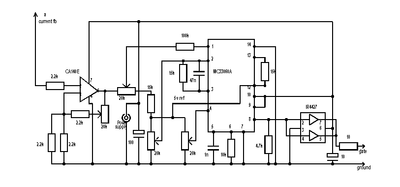

Most of my circuits never get drawn properly and the bits of paper get lost.
This is one that I did draw, but it used a shunt as the control. You could feed the Hall CT into the input and change the gain to suit. I will try to find a more normal circuit but may take a while.
The IR 4426/7 series of mosfet drivers are convenient.
Various switch mode power supply chips will do the pwm. Nearly all have things built in for their intended use and some are a nuisance for our job. The MC33060A seems a convenient one although you can find some with mosfet drivers (3525 has but is not single ended).
Not sure how legible this will be as a gif.
