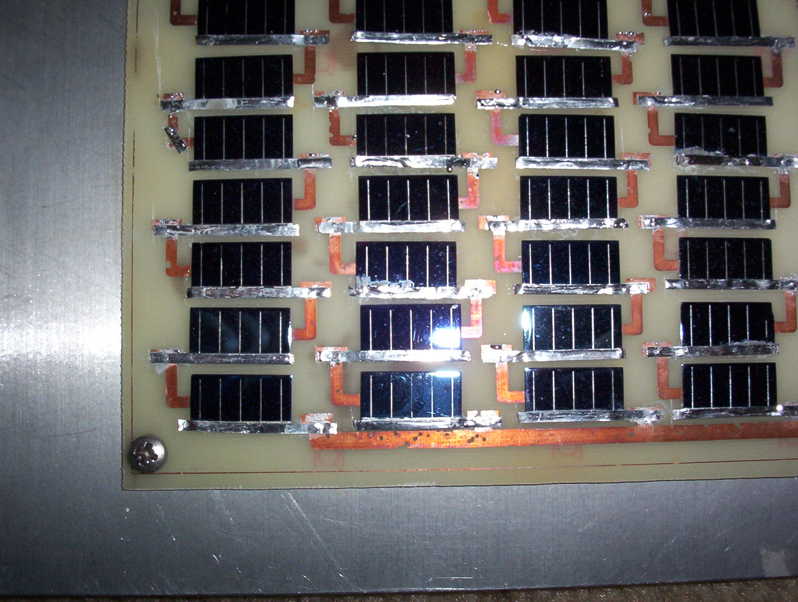

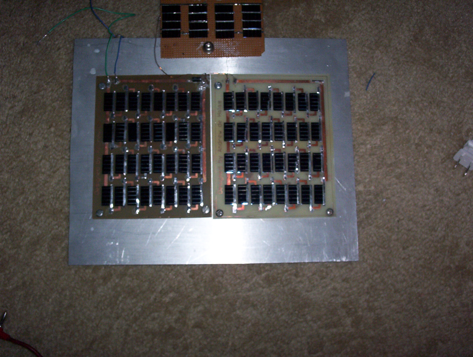

To get your hands dirty in solar, like I do, is to assemble them yourself. I buy the cells raw, Machine the backing, solder them together, and encapsolate them. I only got 50 watts of homemade solar up now, but I plan to expand!
-Andrew

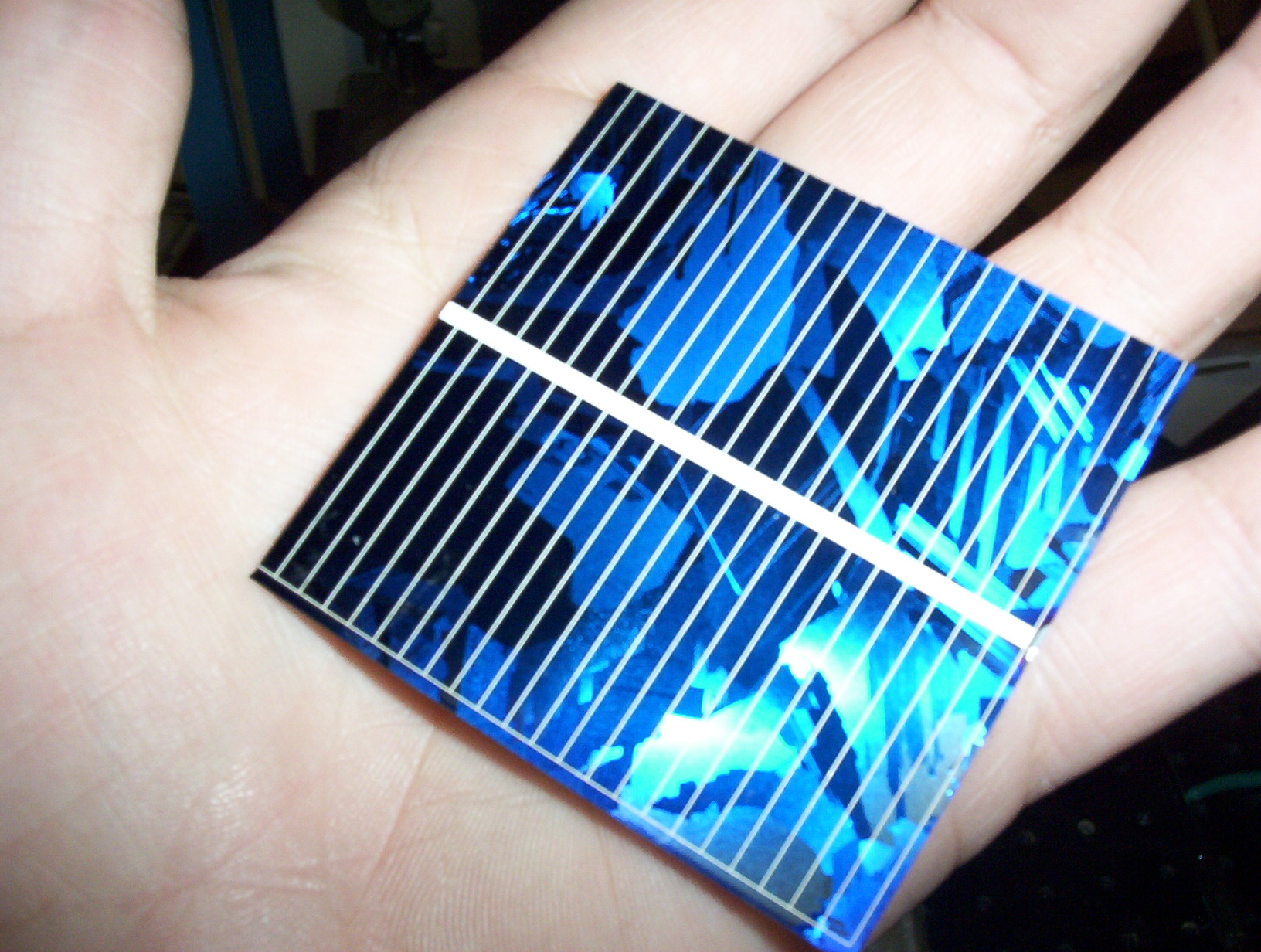

Hey, you ask for pictures....
Here are the pictures of the raw cells I get from silicon solar.
And here is some pictures of my finished projects.
I usually do my solar panels in copperclad fiberglass, because it's easy to use, and easy to make panels from.
-Andrew
