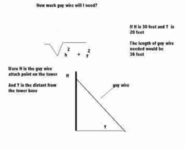

If you have any thing that you think mite be useful
here is a place to put it.
Here is my contribution.     Have Fun
Old F
 That didn't come out so good
Were H is the guy wire attach point and Y is the distant from the tower base
If H is 30 feet and Y 20 feet the length of the guy wire needed would be 36 feet
