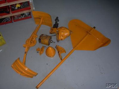

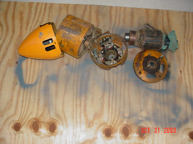

I bought this Wincharger 32 Volt 1000 watt that had taken a bad fall. There's some broken parts and the prop is missing.

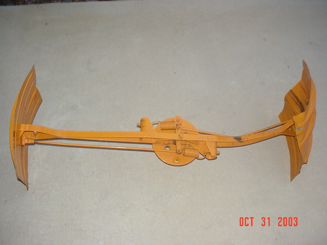

The airbrake was badly bent.

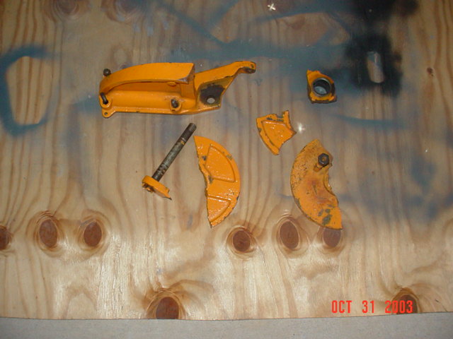

The tail casting and prop hub were broken.
The generator was complete except for missing through bolts. They are 9 1/2" long. I'll have to make new ones from 5/16" rod and thread the ends.

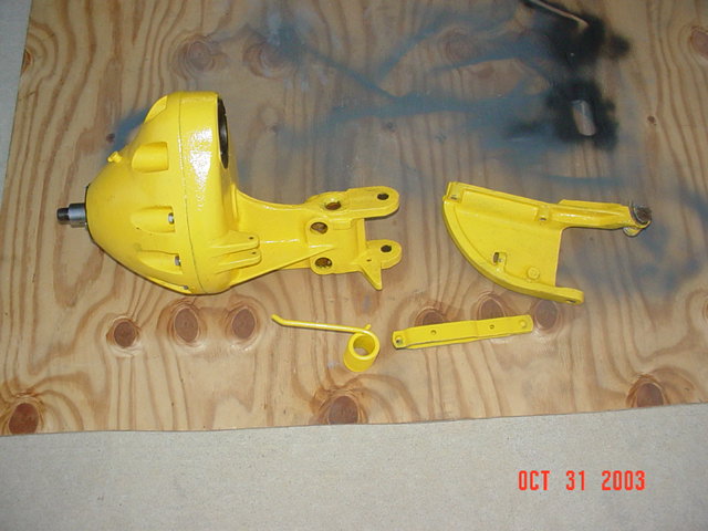

I bought a junk gearbox for twenty dollars that had a good tail casting and the pulley arm that I was missing. The shaft was frozen and one of the other castings was broken.
I installed new bearings and gaskets in the gearbox and painted all the pieces Rustoleum Sunrise Yellow. The original Wincharger color is a mustard yellow brown color. I couldn't paint it that color. It reminded me of something in a baby's diaper.
I removed the rivets and started straightening the airbrake last weekend but I ran out of oxygen for my torch. I should get it finished this weekend. The rivets are unavailable. I'm going to have to make some.

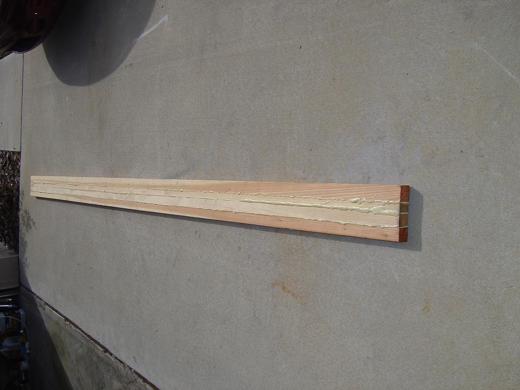

Looked through a whole bunch of two by sixes at Home Depot to get some that I could cut up to remove the knots. I alternated the grain on the pieces when I glued them together to prevent warping.

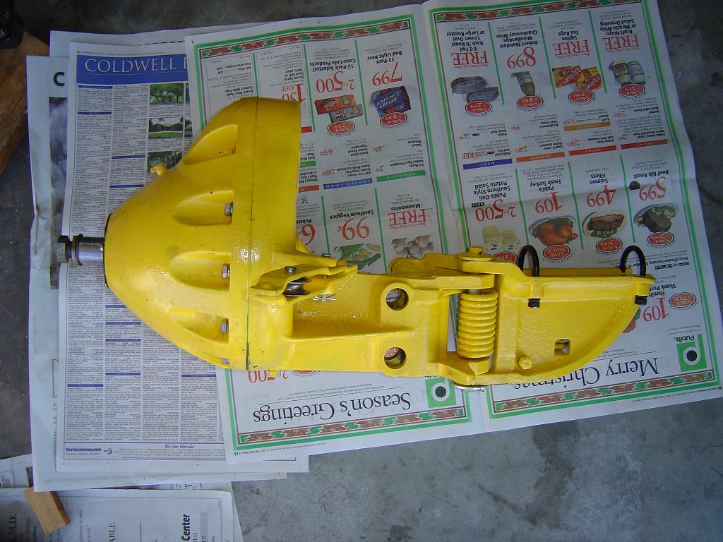

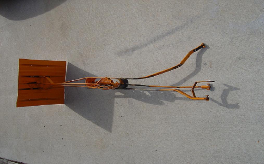

Here's the assembly a little further along. I've installed the tail casting with the new pin that I made and the pulley arm has a new pin and stainless pulley.

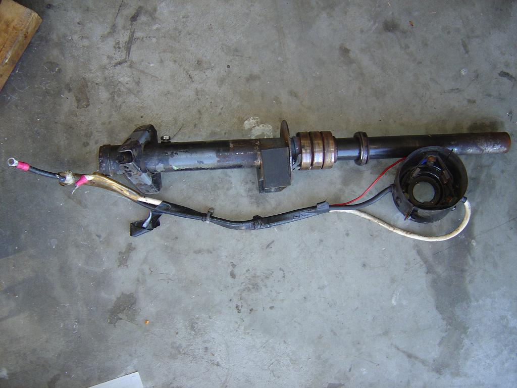

The turntable has a broken weld on the lower three point mount. It's also missing the top mount castings. They are impossible to find so I'm going to have to make some. The sliprings and brushes are in excellent shape.

« Reply #3 on: January 03, 2004, 06:37:57 PM »
Don,
Most sheet metal can be straightened without heat.  Any stretching that occurs can be 'spot shrunk' by heating a small area- it will 'rise'- the area that raised - while still hot, can be hammered flat with light blows on a dolly.  When it cools it will shrink pulling a little more of the stretched area in.

« Reply #4 on: January 05, 2004, 07:18:27 PM »
I was able to straighten out the airbrake flap without heat. The tail was in worse shape than it looks in the picture. It was bent and stretched. We ran it through a roller at a sheet metal shop then tried to heat shrink some of the stretched spots. I've done that before on heavier sheet metal. This is a very light gauge metal and uses vertical bolt on supports to stiffen it. I've lost the temper in the metal and it "oil cans" now. I could spend some more time "working it" and get it right but Terry Bryant, who sells Wincharger parts, is making a run of new galvanized tails for $129.00. I'm just going to break down and buy one. This old one will go in my parts pile.
